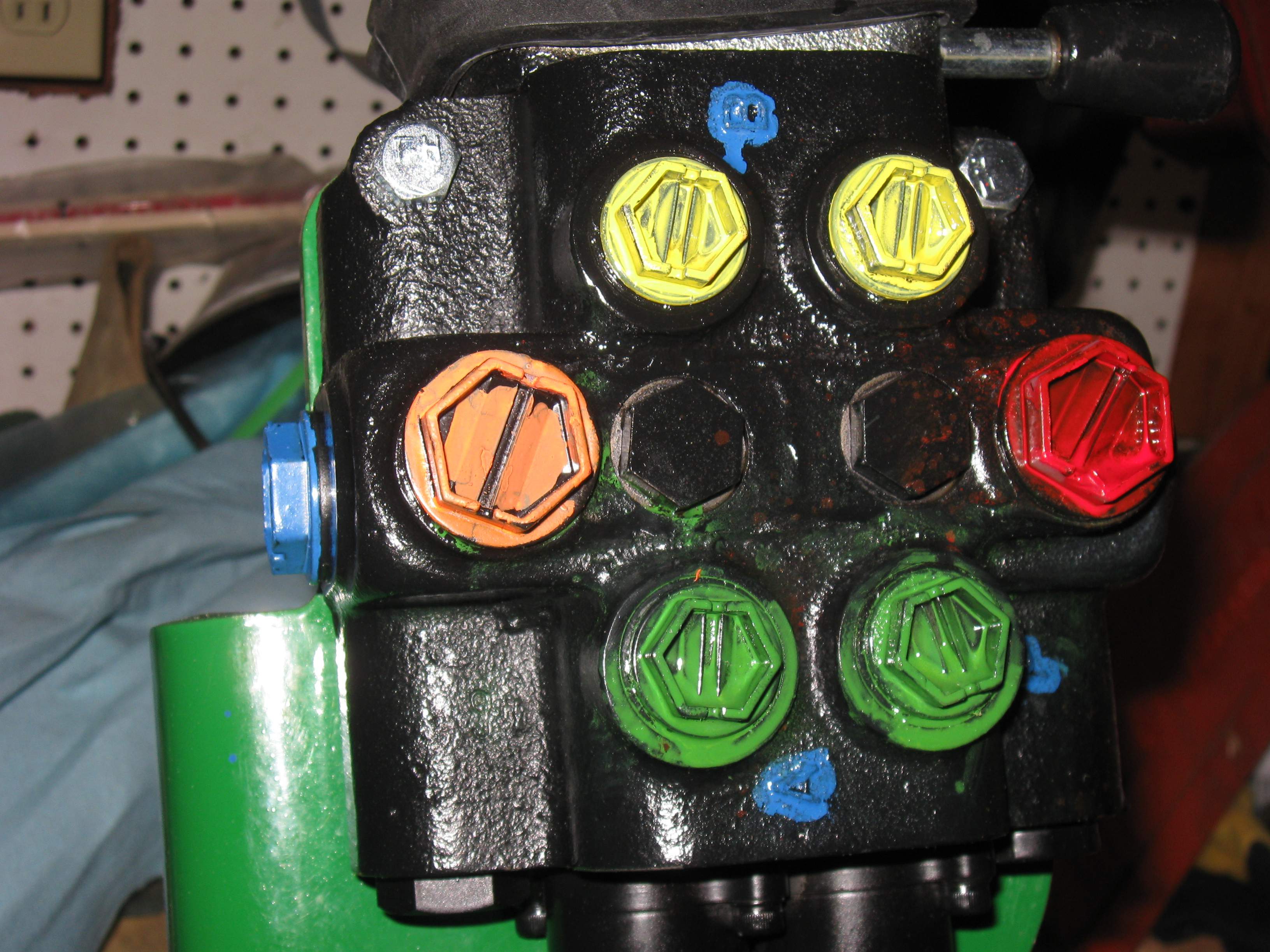

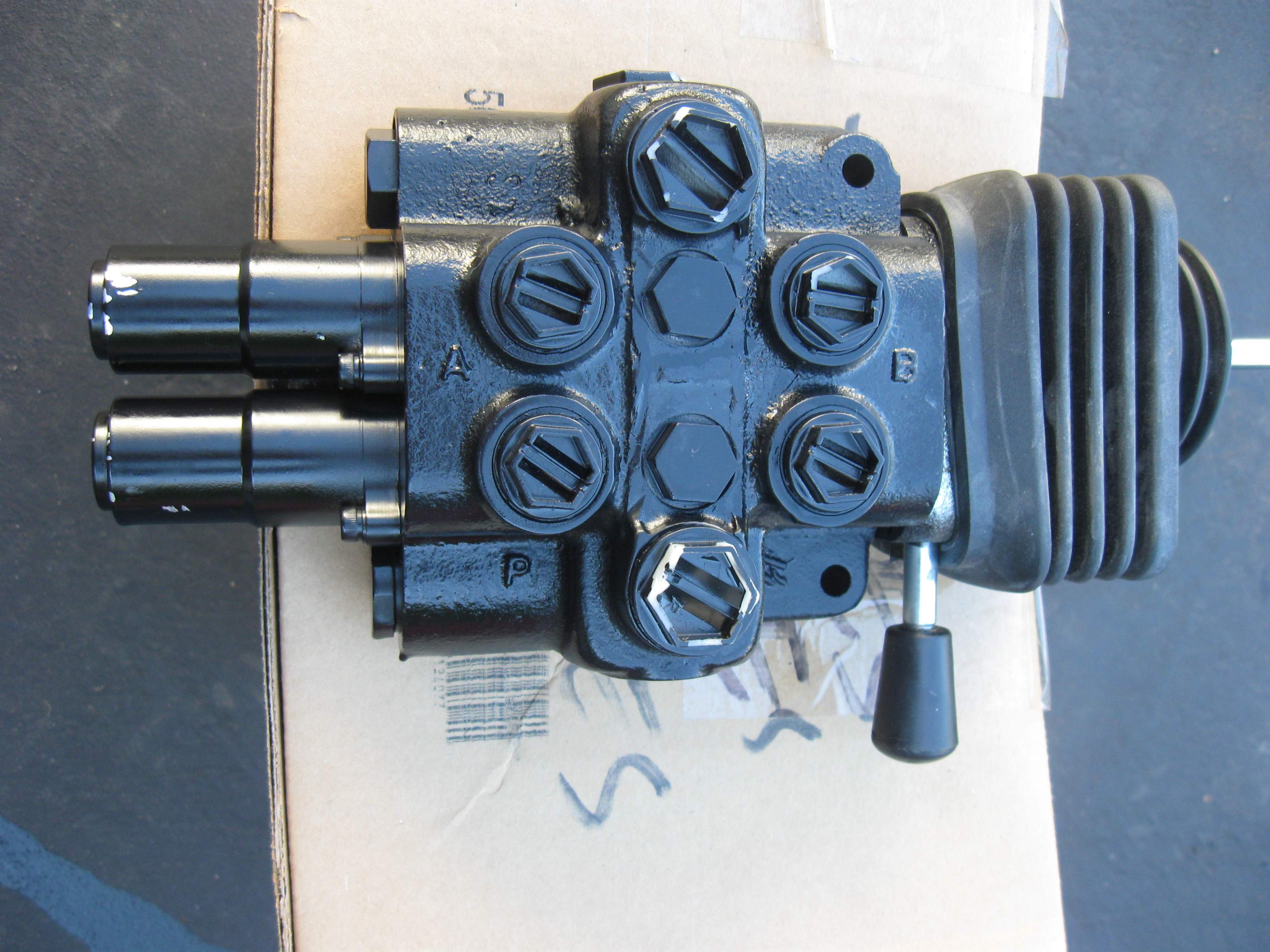

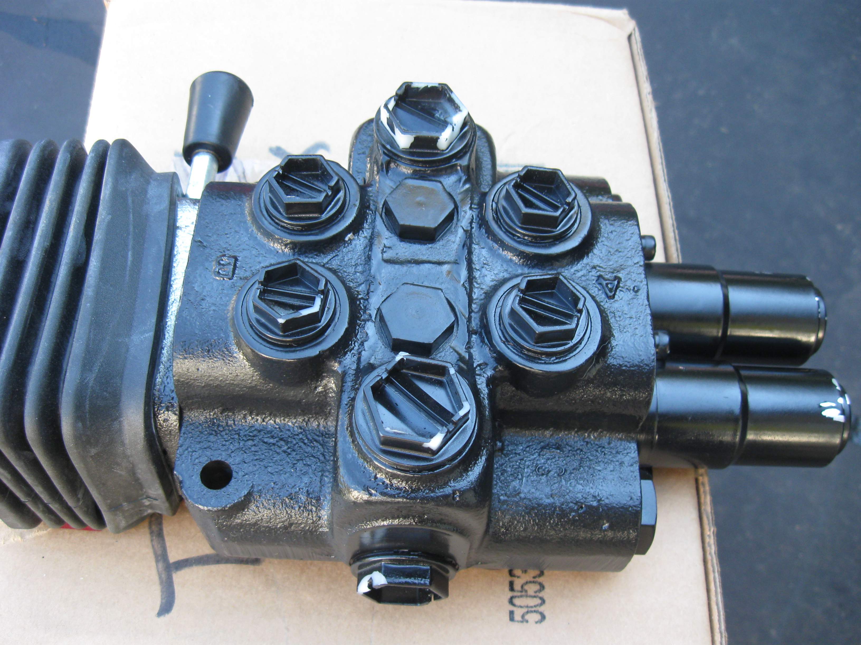

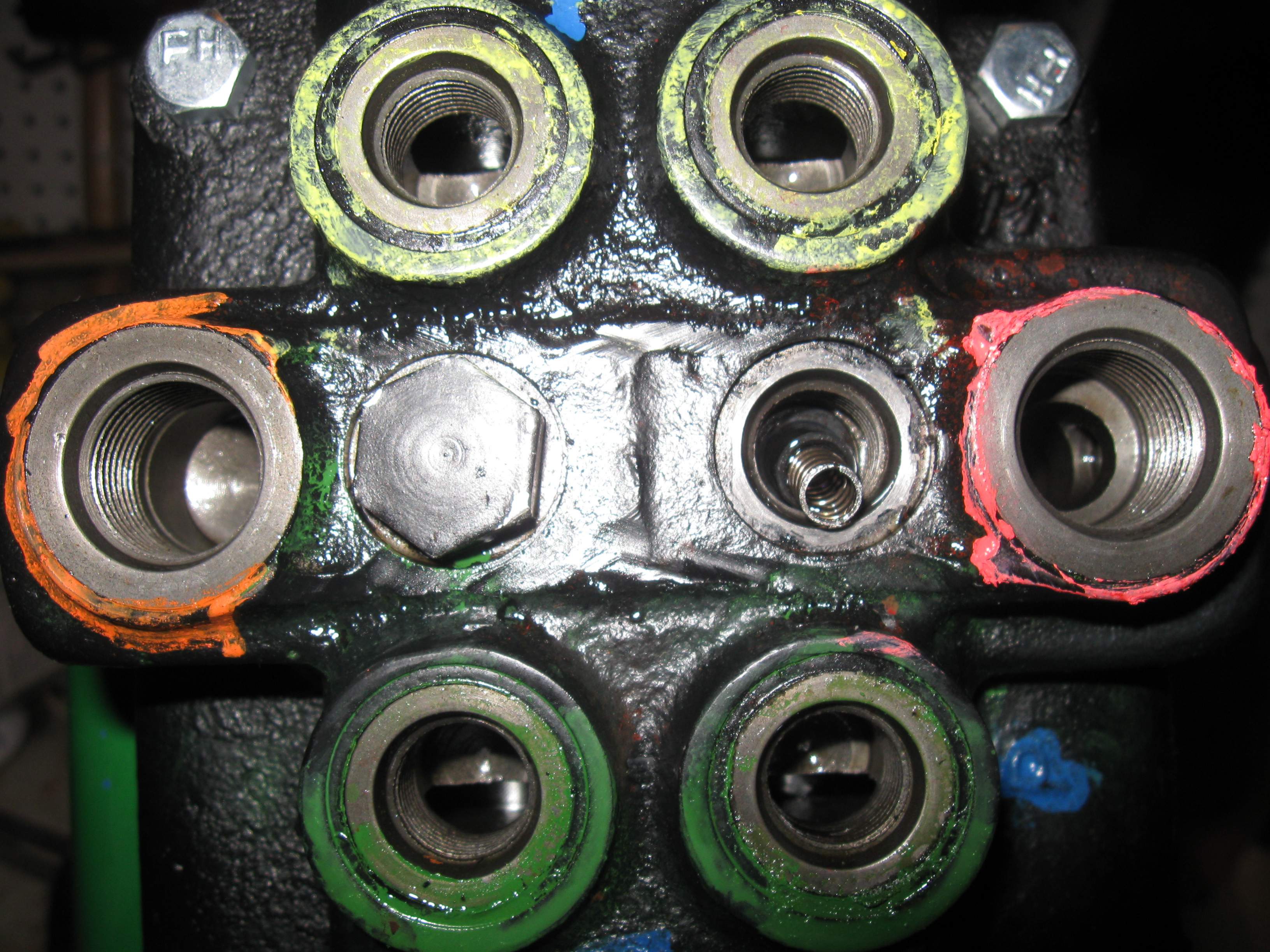

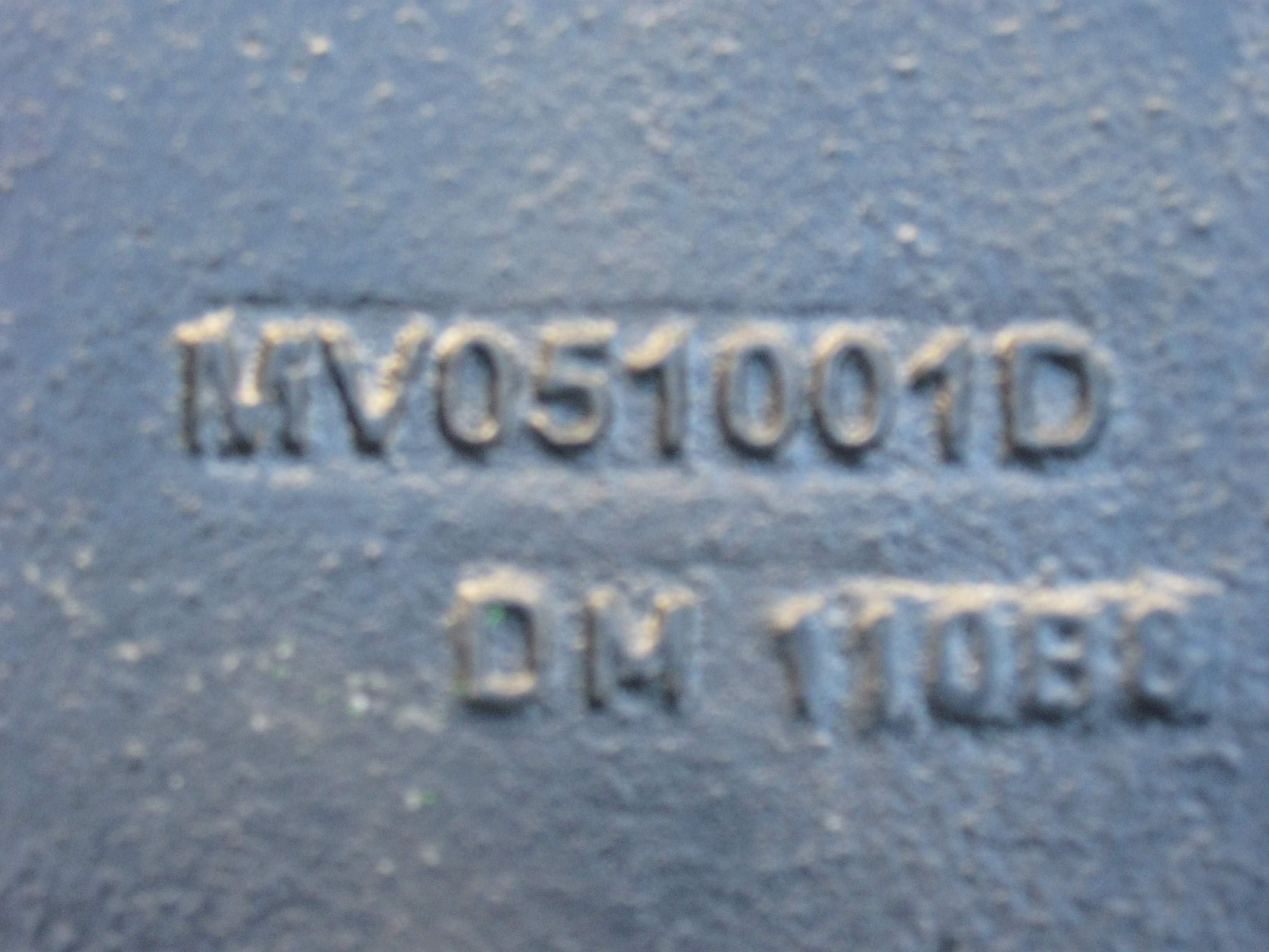

IMG_0411.jpgI bought a add on hydraulic valve and remote bundle kit from the local John Deere dealer when it went out of business last year. I have the whole kit but no instructions for it, it says to go to my.pathways.deere.com for instructions, which I can't get on to because it requires you to have authorized access. I am looking to put this on my Kubota B2920 to have rear outlets. What I can't figure out on the valve is where the feed line and return lines hook up. If you look at the pictures There is 1 port on the side of the valve body. On the front there is 6 ports, a single one on each side and 2 sets of 2 in the middle. The middle ones are marked A and B, which I assume are the ports for the lines to the remotes. Do I use the ones on each side of the A&B ports for feed and out, or does the one that is around the side of the block get used? Does one of them get blocked off? Does anybody have access to the John Deere site, and could download the instructions for me. I have included pictures of the numbers on the valve body and the tag on the box the kit came in. Any help would be extremely appreciated. Thanks Bruce

The side with the "P" is the pressure inlet port...the tank (T) or return (R) may or may not be marked...
most valves have both face and side ports for different installation situations...i..e, routing hoses etc...unless one is possibly marked "PB"...which from the pictures this valve does not appear to have...
Good Luck...
/ Hydraulic Valve Hookup Questions #3

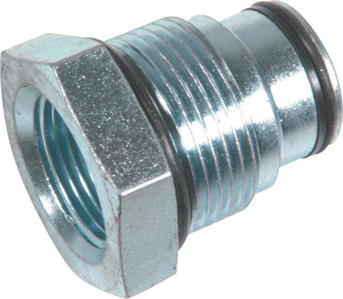

Since you got the valve from a JD dealer, it could be a CC valve.
I don't see a relief valve unless it is under the hex nut .
You have enough ports for it to be a PB valve if it is convertible.
Look in the side port opposite the P port and see if one of these adapters could fit.
Those two pics are PB adapters.
If there is a short plug in the side port, it could be a CC plug. The short plug will have no o-ring at the bottom of the plug
You could use air to test out the ports.
Do you see a T or PB stamped on the other side?

The only markings are the A&B on the center ports and the P port. The one on the side of the valve and the one opposite the P port have no markings. It came with plastics plugs in all the ports including the one on the side.

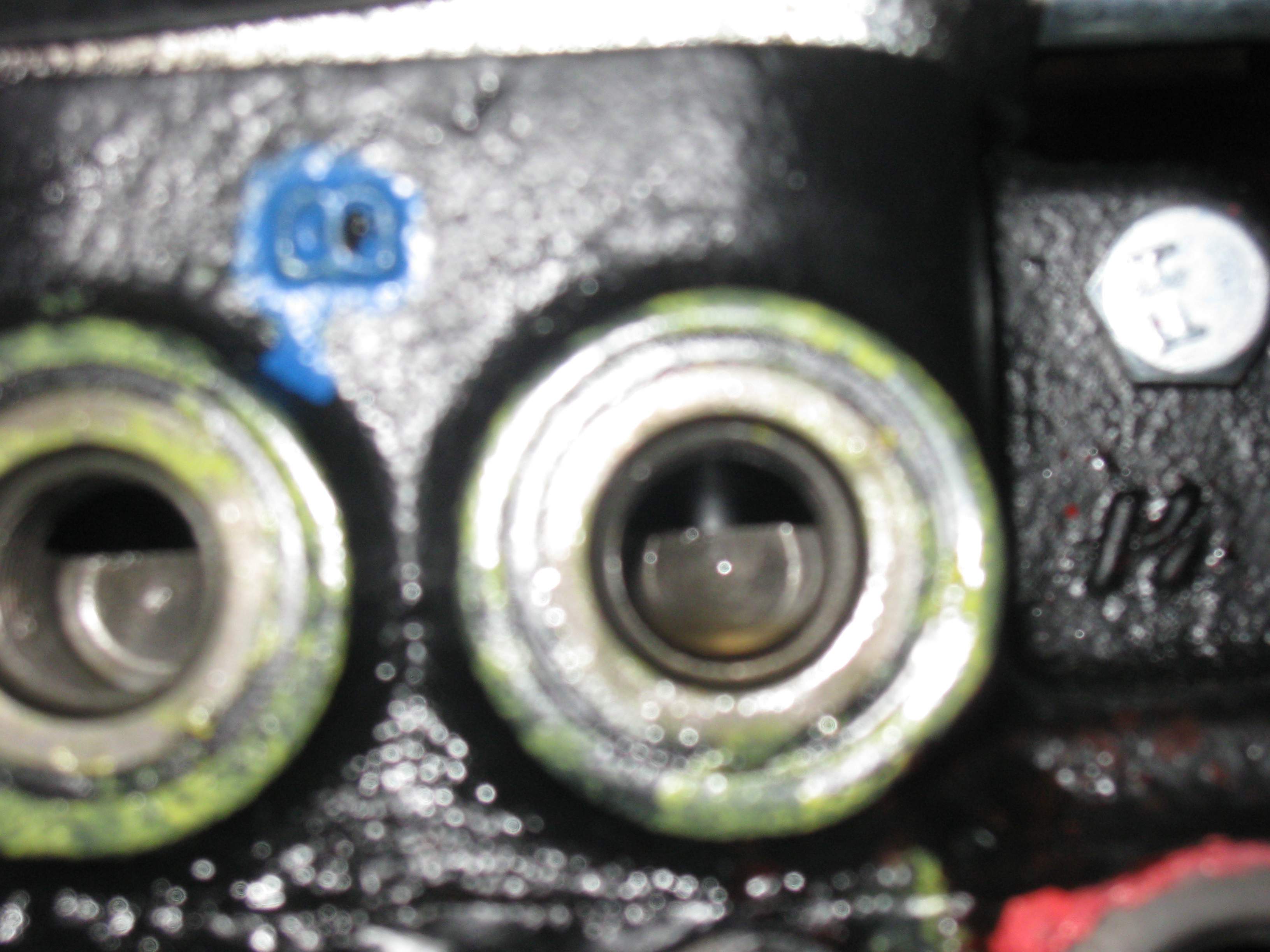

Is there a relief valve in the top hex head bolts?
Show some pics of the other side ports with plugs removed.

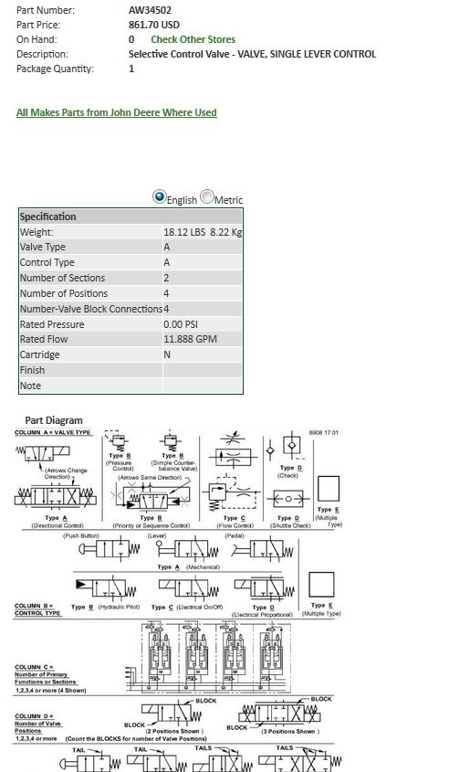

Not really as I've been away from those specification's way too long to remember what they mean. Spec's state valve is type"A".

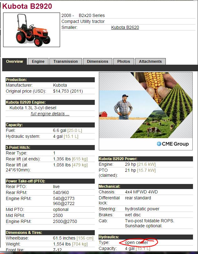

According to Tractordata.com the B2920 is open center so this valve won't be correct.

Well that bites. So much for that plan. I was really hoping it would work because it was cheap. I guess it is back to the drawing board unless there is another way to use it. Thank you very much for your help and information. Bruce

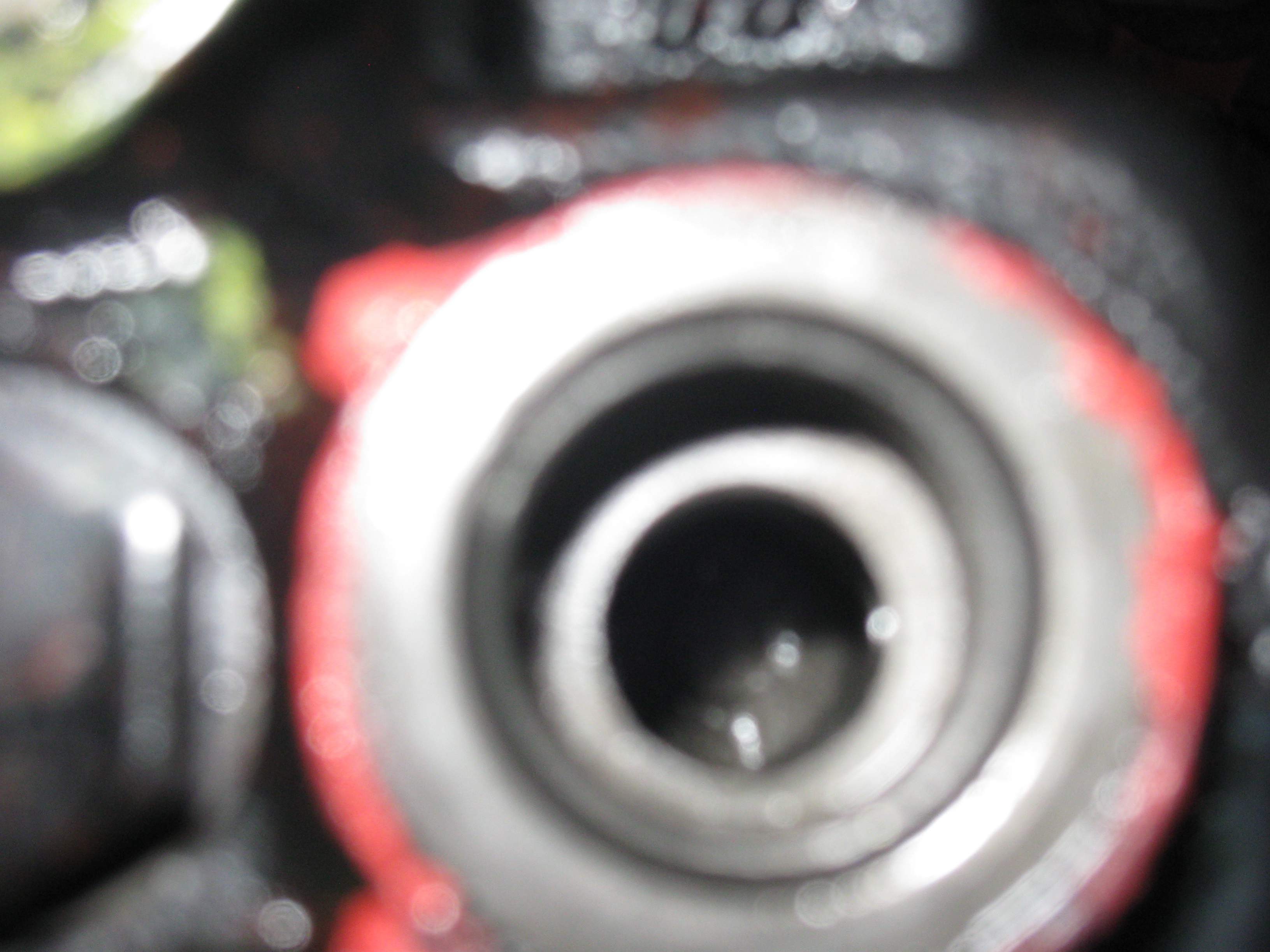

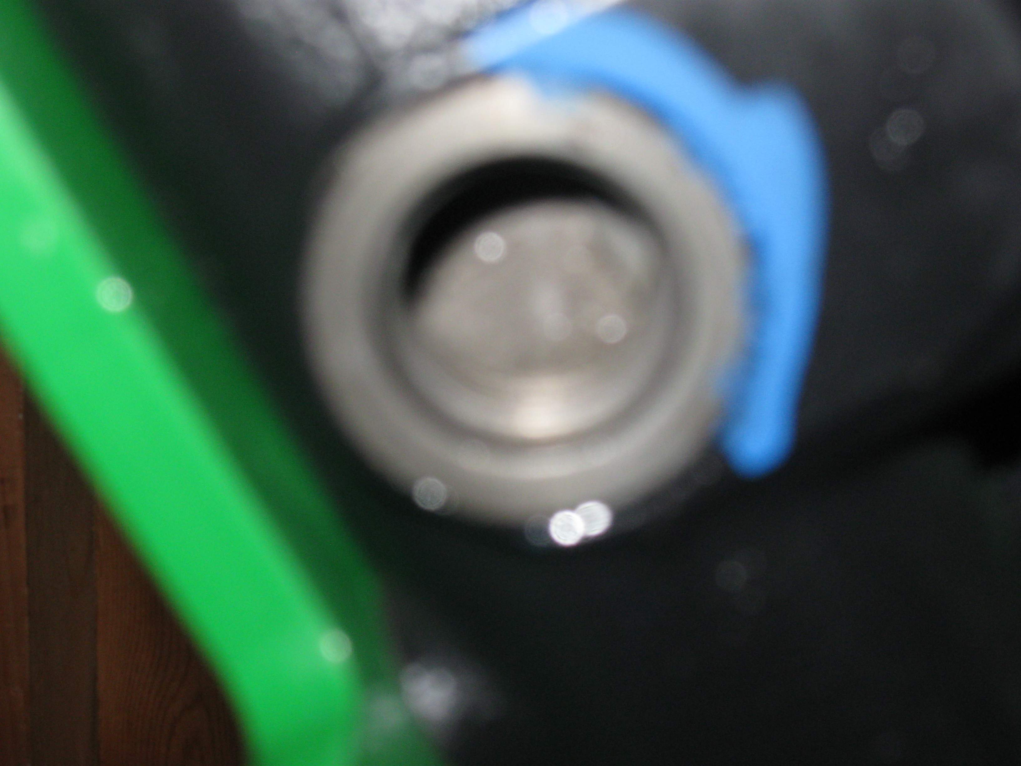

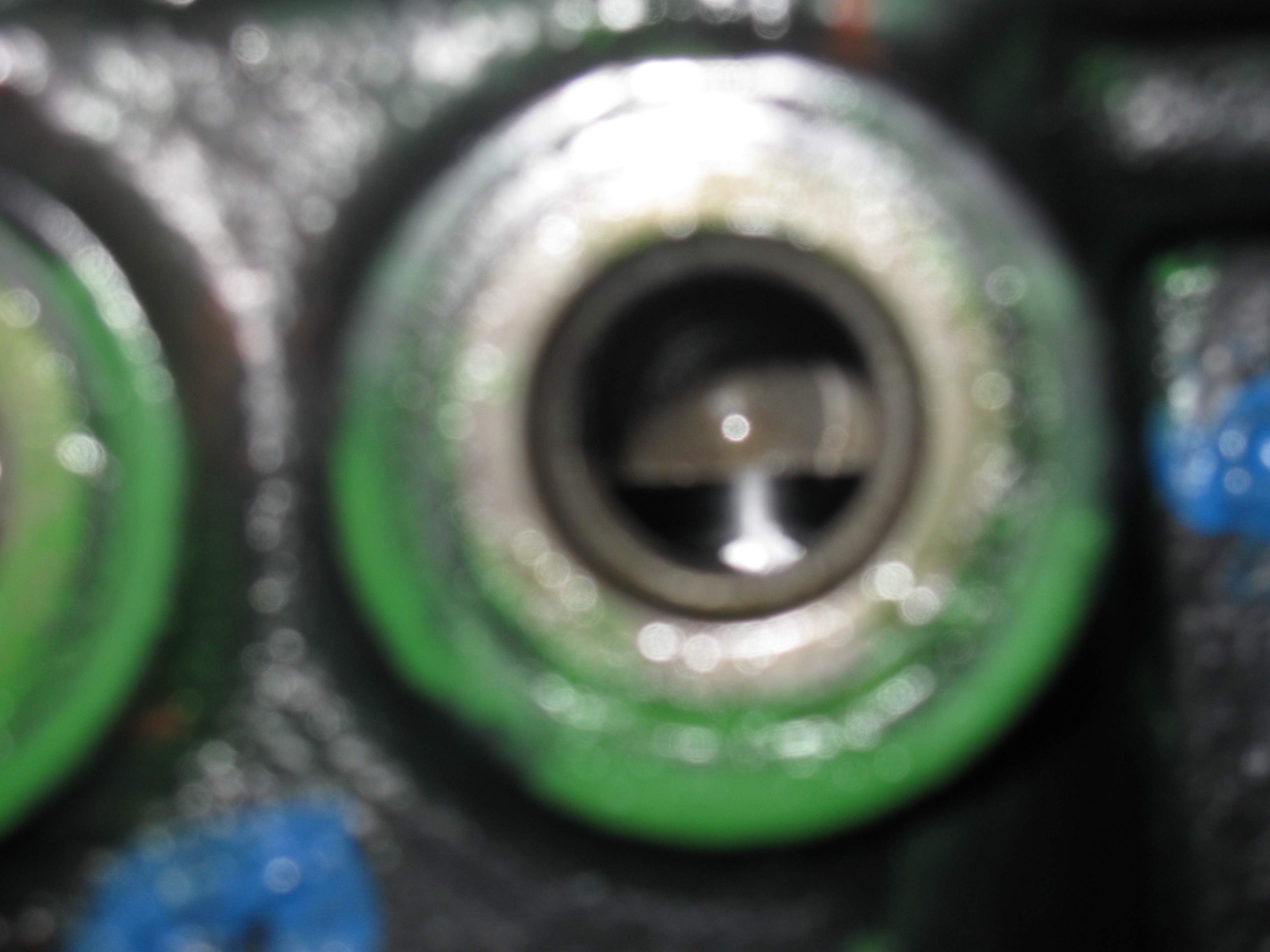

JJ and Tx Jim, I did what JJ suggested and used my air gun to test out the valve and also color coded the plugs. Red port is marked P so I put air in here assuming that P is for Pressure. Blowing in Red it comes out Orange until you move the handle then it comes out one of the Green or Yellow ports. It will only come out the Blue port on the side if you blow in Green or Yellow and move the handle at the same time to a position that lines up with that those ports, it comes out the Blue on side. I am wondering if this means that the Orange port would be used for Open Center and Blue would be used for Closed Center with the other port not used plugged off. Am I correct in this assumption??

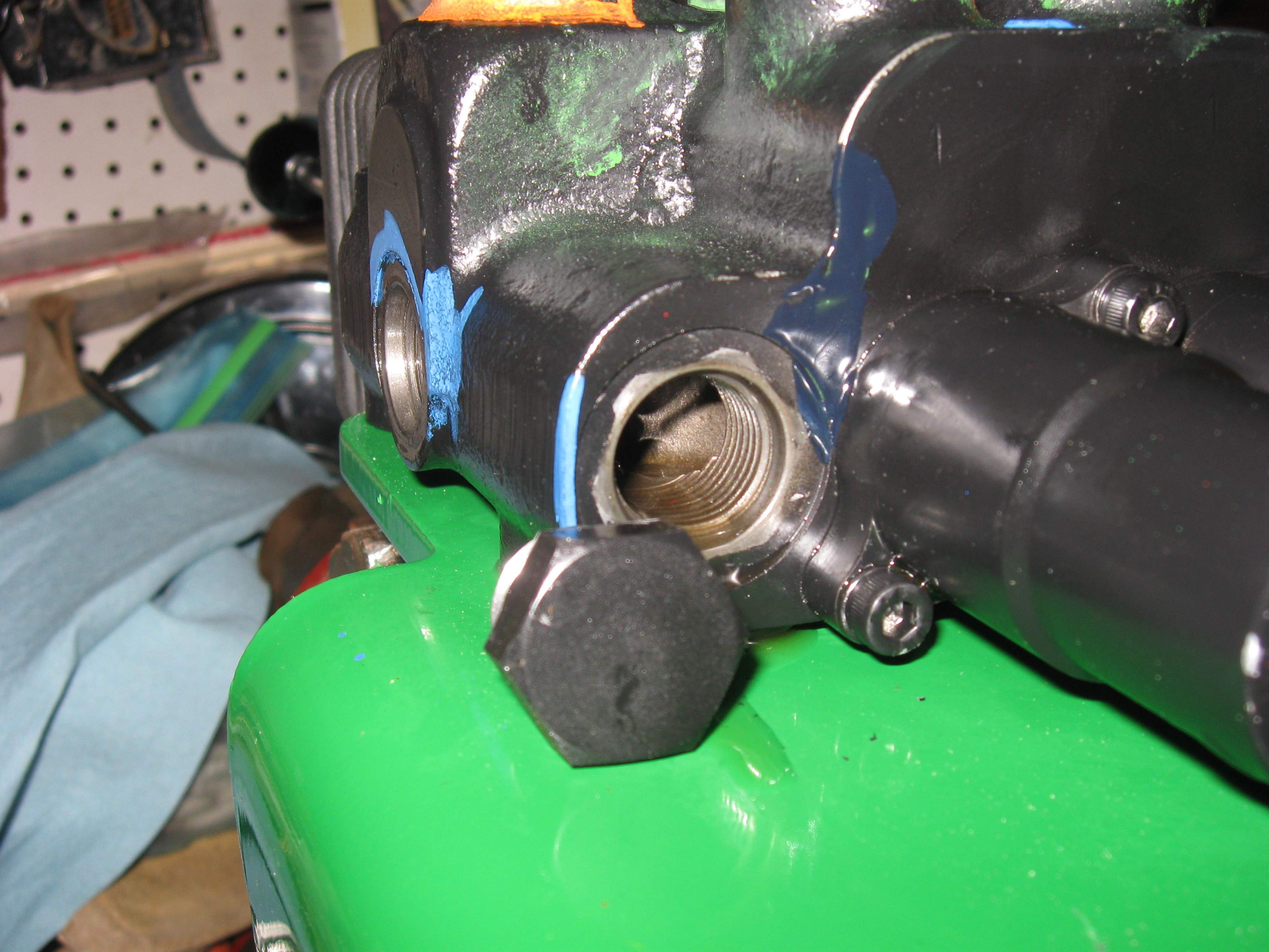

How many ports on the left side of the valve in the picture above?
The one port in the left side middle usually the pass through port.
A pure open center valve will pass pump flow using the OUT port. Cyl flow will also use the OUT port.
A open center with PB with adapter in neutral will pass fluid downstream to another valve.
Using a closed center valve, a Closed Center Plug will screw into the PB port to block the pump flow in neutral. Cyl expended fluid will flow through the OUT port to tank.
A closed center valve will usually not have a relief valve installed.
Please check under the hex screw close by the IN port for any relief valve.
A convertible valve can be used as an open center valve with the OUT port going to tank.
A convertible valve can be used as an open center valve with PB in series with the next valve.
A convertible valve can be used as a closed center valve by plugging the PB port.
Do you know the tank port for sure?
Remove side plastic plugs and show me some close up pictures of the left side ports.
A JD dealer should be able to look up that valve and provide a good description.
Need to know if a relief valve is installed.

As I previously stated I'm not sure of the type of the valve. I never tested a valve with air but as you probably know it can tested with oil. With both levers in neutral if valve is OC oil should exit return when pressure oil is applied to pressure side. I agree your air test indicates valve is OC. I got the valve part number(AW34502) by giving my local JD dealer your whole goods number(BW15798).

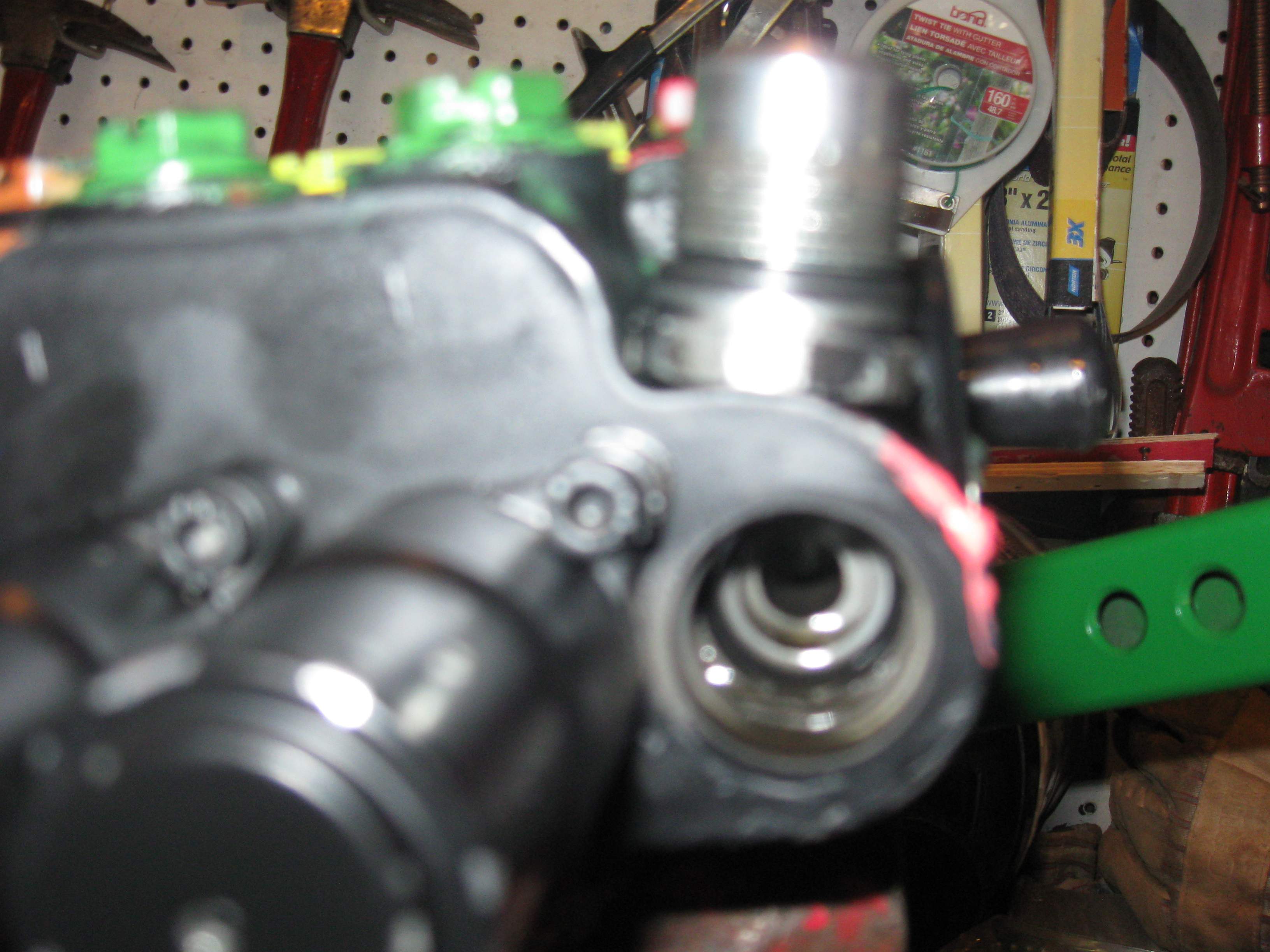

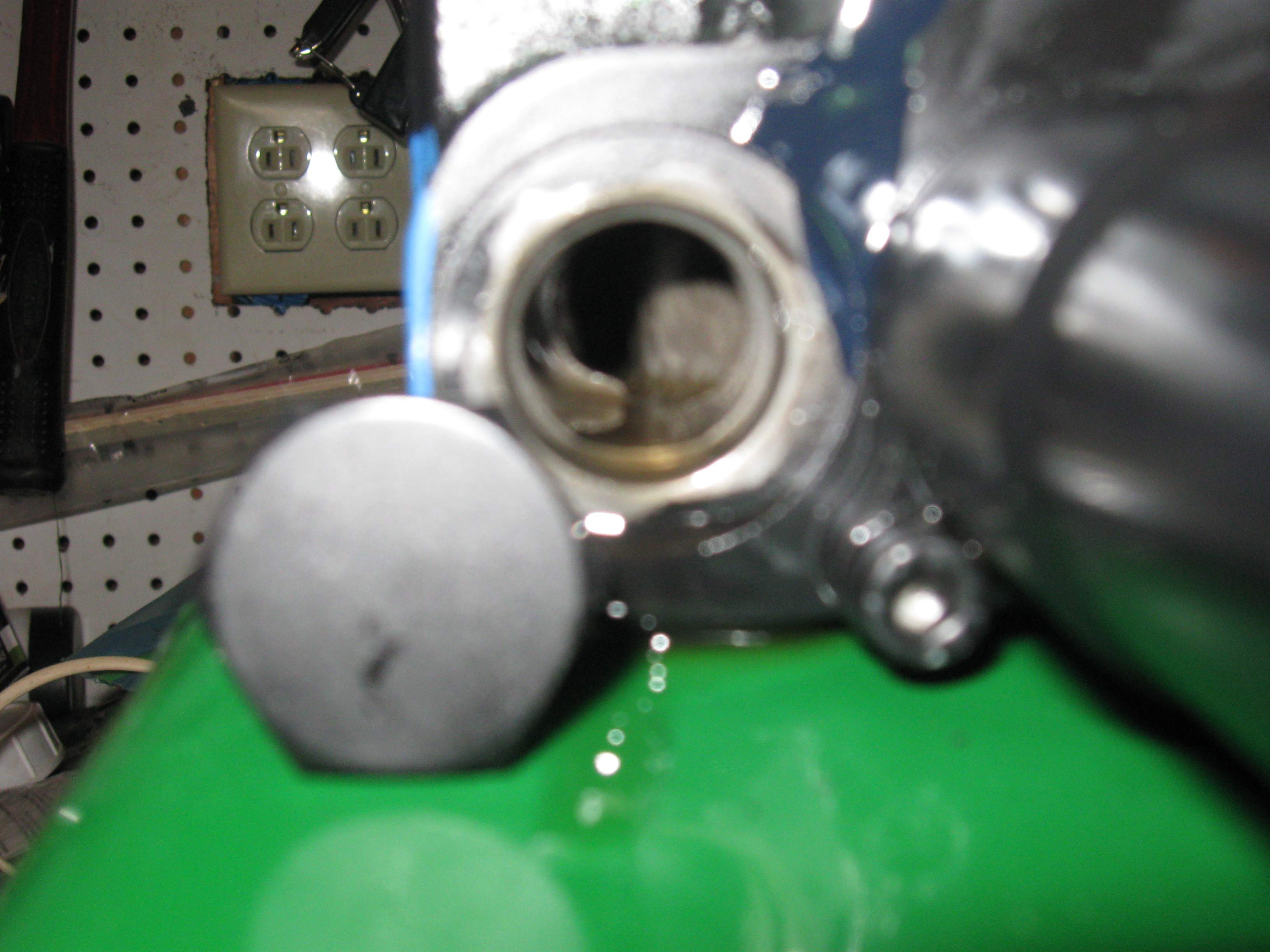

Here is some more pictures looking inside the ports. I also removed the various plugs and took pictures inside. The port under the blue plug on left side is shallow. The port between the yellow and green have a spring and relief valve in it. Any questions let me know. Hopefully these help. Unfortunately, there is no longer a JD dealer around that I can go to for information. JD has pulled the dealerships of many of the old small dealers around. Bruce
