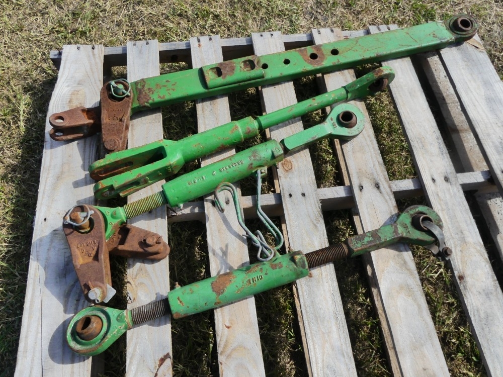

I have a Kubota L4400 (45hp). I use a boxblade and a rotary cutter (3pt hitch type) on it. I had a set of rear remotes installed by the dealer because I also have a pull type mower with a ram to adjust mow height. Well, this mower is old and needs work every time I need to use it so it mostly just sits and rusts.
I have heard of people adding hydraulic top links to the 3pt hitch and since I have a rear remote set, this would be easy to do. It seems to me that it would make adjusting the angle of the BB very easy (and I often tilt the BB forward so that only the scarifiers engage but then have to hop down and adjust the top link to get it back level. A hydraulic link would also make mow height adjustments and angles a quick deal for the mower as well.
Would a hydraulic top link actually work for the things I mentioned above? Is it weaker than a basic top link? In other words, will it hold up under mowing and heavy box blade work? What size should it be (diameter and length)? What else would I need besides the ram, hose and couplers?
Any thoughts would be appreciated. This is not something I need but I spent a good bit of money to have those rear remotes added on and now they aren't used for anything. If I can add a simple ram to replace the top link, I might actually get some use from the remotes. Is it worth it?

Hyd toplink is one of the must-haves for your tractor.
Very versitile and much stronger than the cheapo
mechanical toplink that came with your tractor.
You can also use your box blade with a hyd toplink as
a "poor man's hydraulic box blade". You set the rippers
just below the bottom of the sides of the BB, and tilt
the BB with the toplink to switch from rip to blade.
As for the extras built in to the toplinks, those are
check valves to keep the cylinder from leaking down.
I do not use them because my tractors suffer from very little
leak down.

That is the double pilot operated check valve. You REALLY need this to prevent drifting of the top link cylinder. In my opinion, and that of many, many others here on TBN, the check valves are a necessary requirement for top and tilt cylinders.

The pilot operated check valves don't really have to be mounted on the cylinder, they can be incorporated in the control valve and fuction equally well for holding the cylinder in position when the control valve is centered.
One advantage of having the check valves on the cylinder is that the cylinder will hold position even if a hose were damaged or failed, while if you have check valves incorporated in your control valve (like I do) if a hose is torn off or otherwise fails, the cylinder will move.

Prince had the right sized cylinder and control valve for my small tractor. The cylinder was on sale, and in stock. It does not have a check valve...but to tell you the truth, I haven't missed it.
If a boxblade or brush hog is suspended in the air, the hydraulic toplink will slowly leak down, BUT if the boxblade is engaging the ground, or the tailwheel of the cutter is on the ground (ie I'm actually working) I notice little if any drift. Though I must admit, I am almost constantly changing the length of the toplink to adjust to terrain, especially with the brush hog. Very nice!
Bottom line: An hydraulic toplink is something you won't want to be without once you've tried it...it's great. AND A check valve would be nice, but in respectful deference to other posters, is far from necessary in my opinion.

My initial thought in all this was just to buy my own cylinder and hoses and make it myself.
When I used my rear remotes on a big pull type mower with a ram for raising and lowering the rear wheels, it never leaked down and the ram on the mower did not have a check valve.
Putting the check valve issue aside:
Most of the rams I see for sale have pin tpye attachments on the ends. How do you get ball-ends onto a generic ram?
I've seen hose size mentioned with 1/4" recommended. I'm assuming that if the hose is larger it will be harder to make slow or accurate adjustments?
Let's say I did finally build this thing myself (just hoses and a ram, no check valve) and it leaked down or would not hold position. Can I buy and add a check valve later?
Thanks.
P.S.: my DIY skills are fair. I do my own basic servicing of the tractor, I can do home plumbing, etc. I don't weld and don't have any specialized tools.

Using a smaller diameter hose is akin to using a flow restrictor. This will slow down the cylinder sufficiently so that feathering and precise adjustments will become so much easier.

You have to weld. TIG is prefered for best fusion, MIG is OK if you have plenty of amperage to apply. If the cylinder is a welded-type, you can extend the ram and optionally fill it with oil, and do not cap the ports, and weld away, keeping the chromed rod cool with a wet rag wrapped on. The other end, the base end, can also be welded onto while the rod is extended, and optionally with oil inside. The oil is discarded after welding. If the cylinder is a tie-rod type, the base is cast. I do not know how to weld the cast reliably, especially for the forces you expect to put on a hydraulic cylinder. Even on a cast tie-rod cylinder, you can weld the rod end if you keep it from overheating with the wet rag idea, and cooling often. These are my methods gleaned from the experience here on TBN, and from farming days. Other readers may have other ideas and correct my writeup. This stuff has worked for me in the past. Good luck.

The Prince cylinder used for my hyd. toplink came as a cylinder only. Ball-ends were picked up at Tractor Supply. As Jim suggested, I extended the cylinder and wrapped the chrome rod with a damp rag before welding. Both the cylinder rod and base welded easily. The rod didn't even get warm. The rag probably served more to protect the rod from spatter than anything. The whole welding thing went real smooth.
