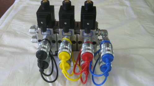

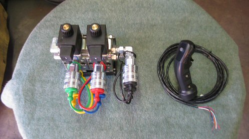

Thinking I can plumb a hydraulic top link to it and call it a day. Dont have a hydraulic mid mower mount to worry about.
Alternatively if I dont connect the mechanical diverter can I simply plug the hydraulics to the adapters/splitters that @mtnViewRanch posted in #27 I can then have a complete set of always on hydraulics that I can hook up other implements to also? Its like a power beyond kit..right?
Am I over simplifying it ?
Side note I need to stop looking at all your setups, makes me spend too much money..LOL
Not an economical idea and you cannot hook up the electric valves in post 27 to that diverter and easily use it off the back..
You have a power beyond off your loader valve and you can hook up manual or electronic valves off of that. Better solution for the same price or less.
