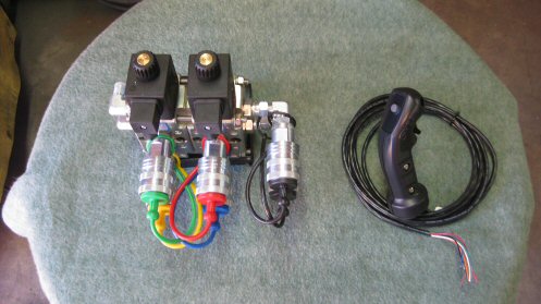

I have been intending to order a hydraulic top link for some time. Now if I understand correctly I can also get a diverted valve to make my single remote operate both a top and side link. Is this correct?
/ Hydraulic top link #27
Yes sir, this can be done. Again, more common than some may think.

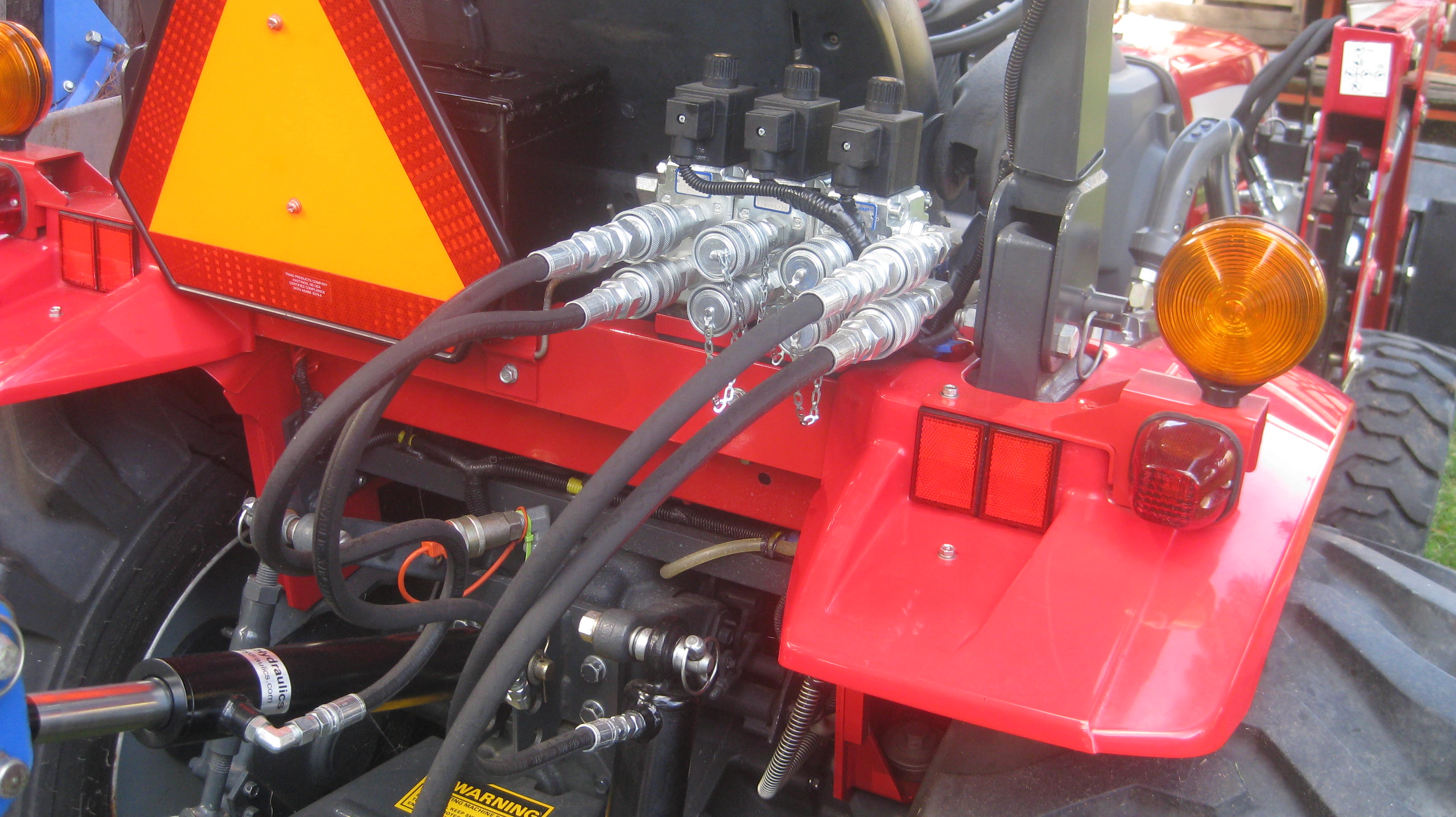

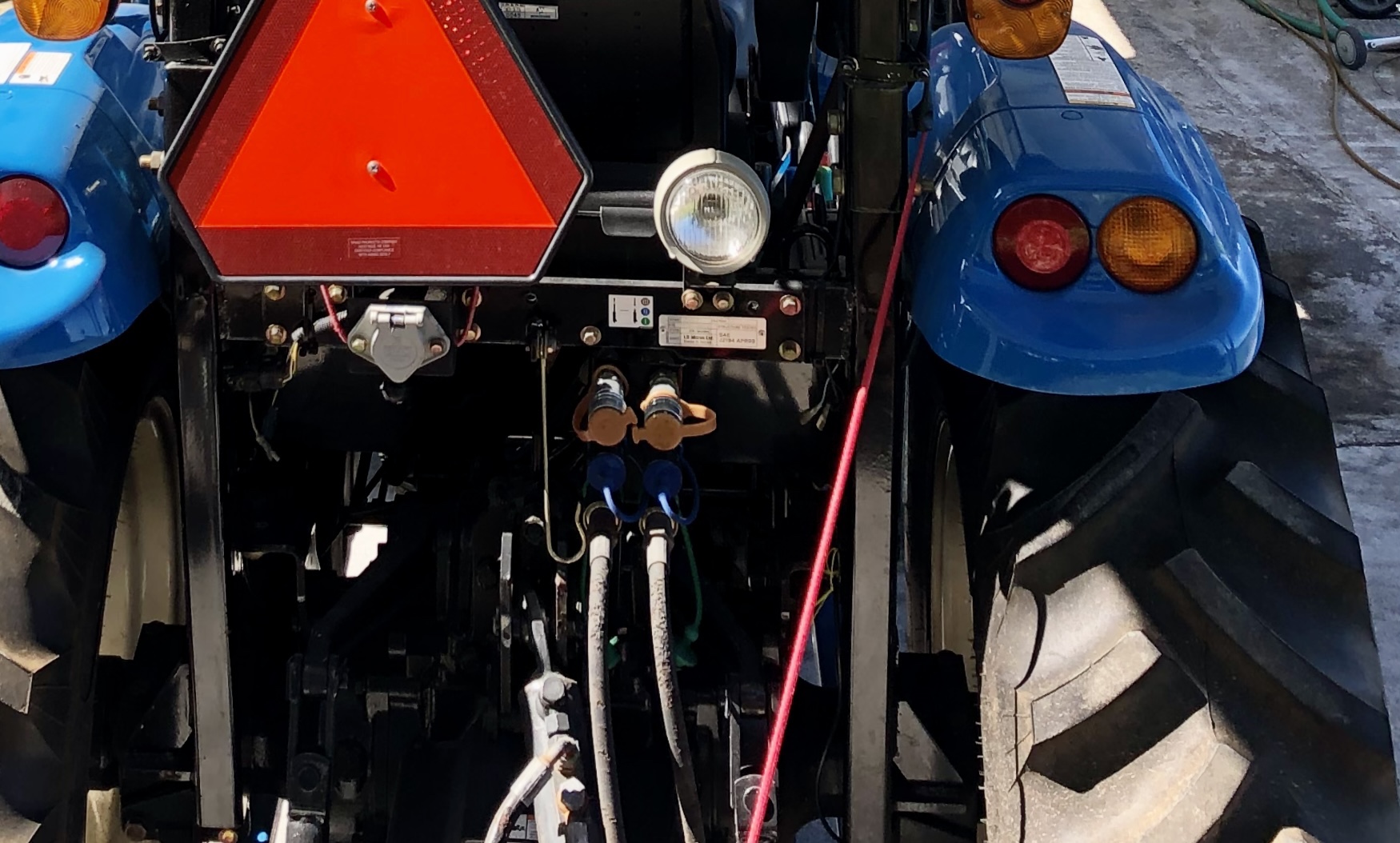

These fit very nice on top of the factory mount. :thumbsup:

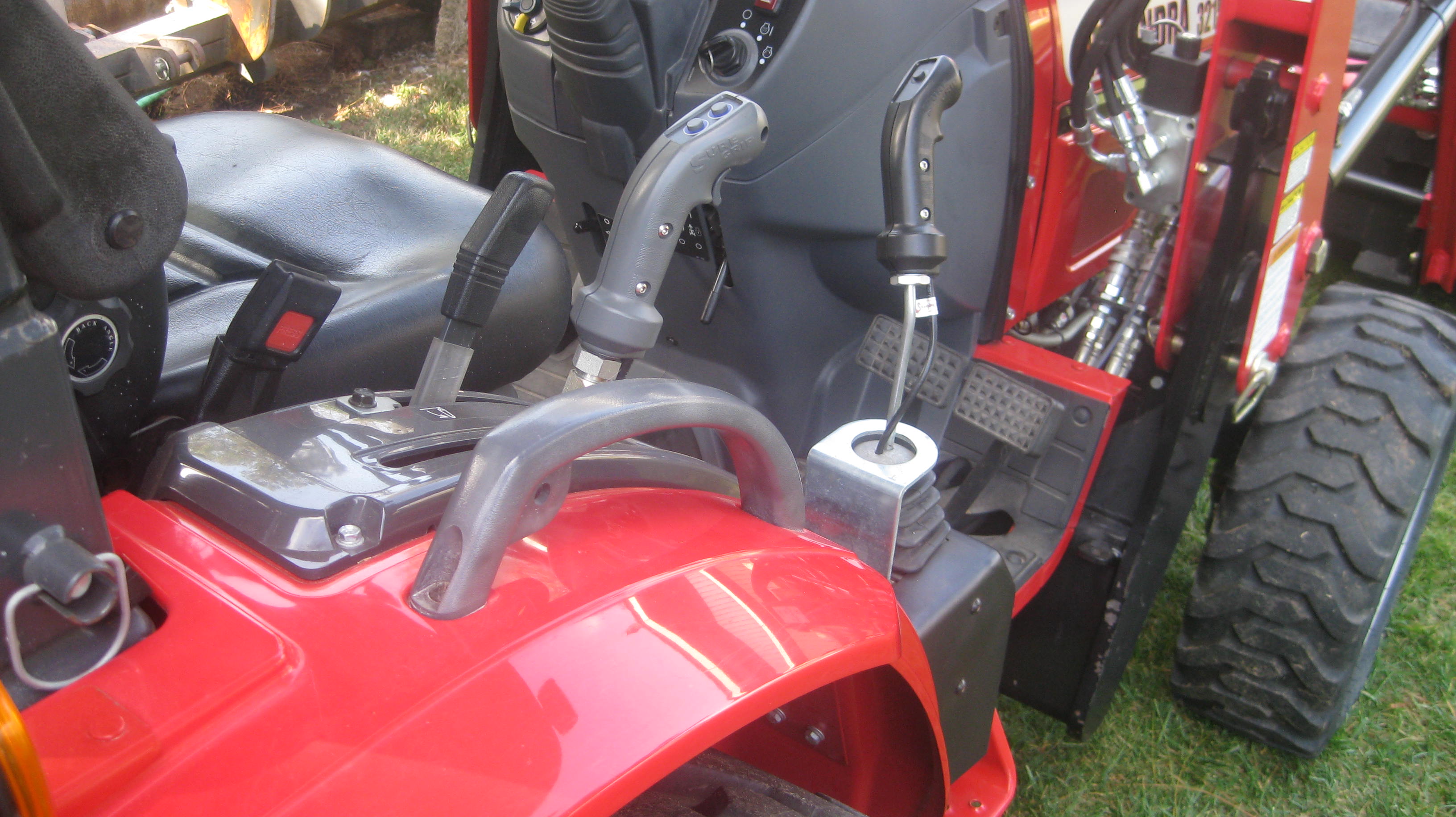

How would one operate the valve with a cabbed tractor?
/ Hydraulic top link #29
A control grip is installed on the existing control lever.
See the gray pistol grip in the picture, a similar grip gets installed on the rear remote lever. You simply have your thumb on the button while you move the lever and your additional set of couplers function the same as your original set does.

Bearsixty7 - tight fit there but looks nice. You will want to do something with your hydraulic hoses. Looks like they rub on the lower arm and again on the implement. There are heavy nylon sheaths that will provide protection.
/ Hydraulic top link #36
LOL! It is a tight fit on these little Cat 1 tractors.
They look closer than they really are but I adjusted them so that they looped over more and didn't touch anything but I may still cover them just to be extra safe.
