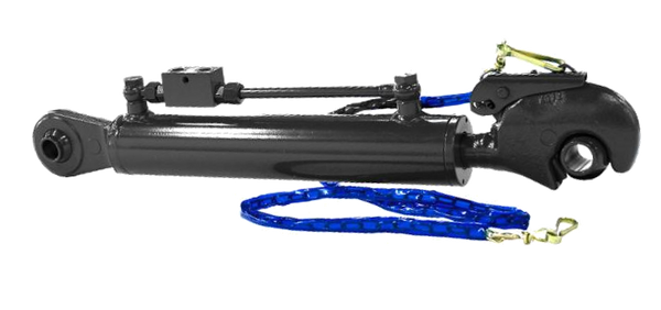

If the OP needed an extra length, AristoreUSA sells several different lengths. This one would work fine too:
But it has been my experience that the amount of times my top link, while hooked to an implement, is all the way extended or retracted, is very minimal. And I specified a bit longer top link for my tractor, since I added my quick hitch (that pushed the actual links out a bit from factory). I still keep my manual top link around for various implements that require the hydraulic remotes the top link uses.
From factory, the LS MT 342 is a cat 1 hitch. If the OP wanted to upgrade to a 1/2 on the top link, I'd suggest getting something like this And use use cat 1/2 balls:
Alternatively, the OP can get a quote from Brian! ;)

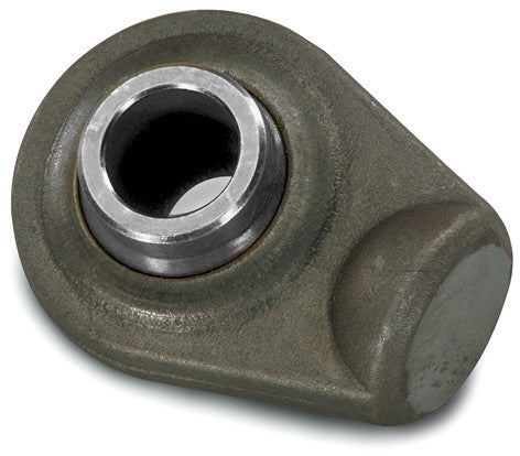

On reflection, that cat 2 quick hitch would not work with the MT 342. It requires a cat 1 on the tractor end. So either go with the first link, Brian, or cut off the cat 2 tractor end and weld this in its place:
But honestly, you really do not need a quick hitch on the top link, especially with hydraulics.
