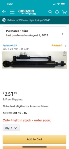

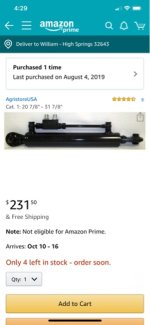

Another thing you could do is to use the diverter setup from the front. It's normal use is grapple functions. But w hoses going to the back, you'd have a nice easy way to control your htl. Especially if you have to nudge it a lot (depending on the attachment)
1 more option, using the detent remote on the back add a 2 spool or joystick valve mounted in the operator station and connect to the htl and side link. You'd be passing fluid through the valve just like the bh setup. Could do it with htl only and one spool valve...
