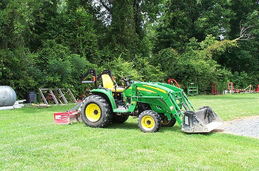

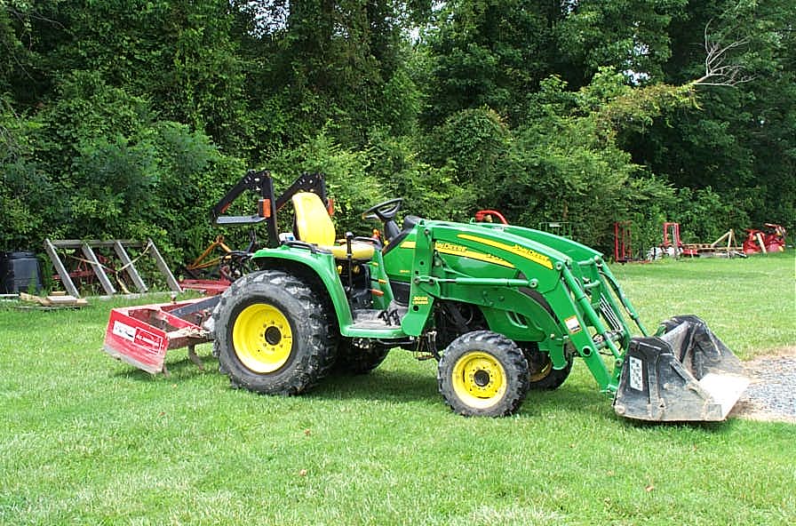

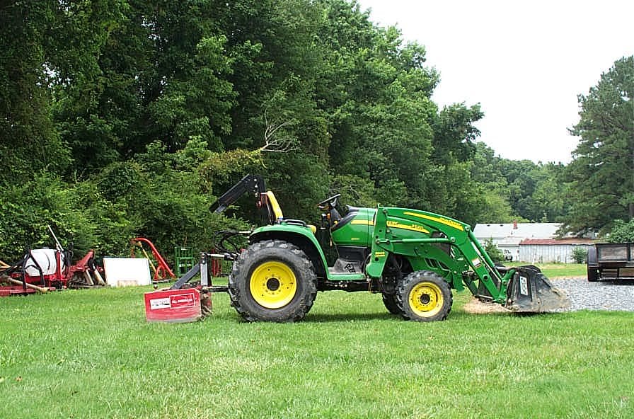

#9
Okay here are the pictures of my situation. As you see in the extended position of the cylinder I have the box positioned just past level. For some of the things that I do I would like the box to be tilted back further to level and compress material. In the extended position of the cylinder you can see the box is pointing up to the sky. I can drop the scarfiers to compensate for this. The plan is to either cut and extend the support of the cylinder where it attaches to the tractor. Or make a adaptor that attaches to the tractor to make up the distance. I attempted to make a template of a 3" adaptor yesterday but there was not enough room to weld the plates and get the room required for play in the ball joints. I am going to look at making a 4" one today.
