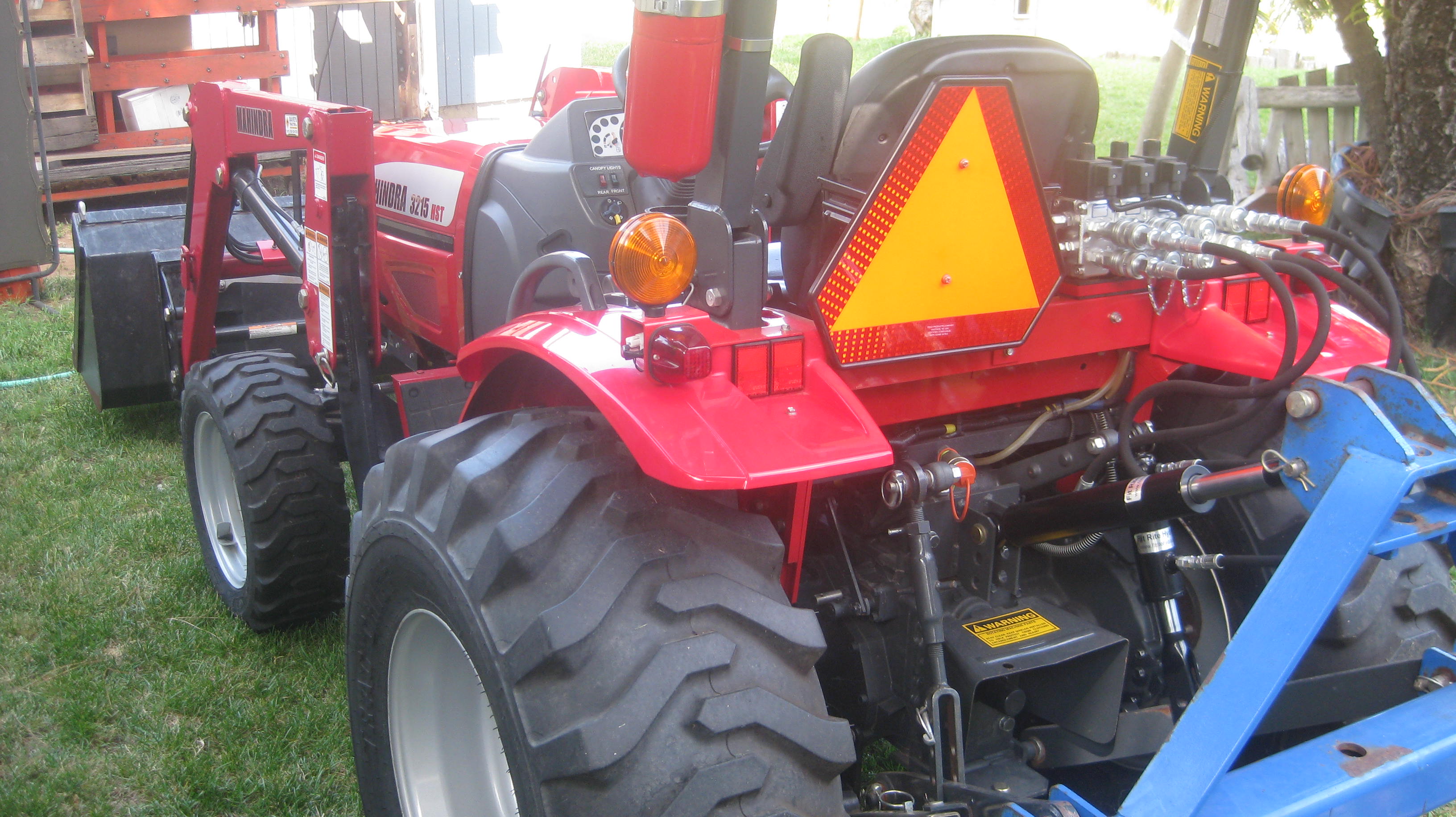

I had only 2 remotes until recently. When I needed to free one up, I just popped the hoses out for the top or side link and zip tied them out of the way. The cylinders hold just fine. If you need to make an adjustment, pop the hoses back in, adjust, and back out.
/ Hydraulic top and side link #10
You never have to go back to the factory manual unit. Unplug the couplers and the cylinder is rock solid. You do not have to have the check valve to be able to do this. Any cylinder will hold while the couplers are disconnected.
Get 2 of the 3 valves with the float feature. Better to have it and not need it than to need it and not have it.
While some people don't think much about having a hydraulic side link, others would prefer the side link over the top link if they could only have one. Get both, you will not be sorry. I personally use my side link 2-3 times more often than my top link, but I do a lot of grading and do not use a std type box blade.
If only 3 rear remotes are available, you can get a diverter set up to get that 4th one that you may need.
My smaller tractor only had a single factory rear remote available and I ended up needing 4, so I added 3 diverters and now have 4. :thumbsup::thumbsup:
