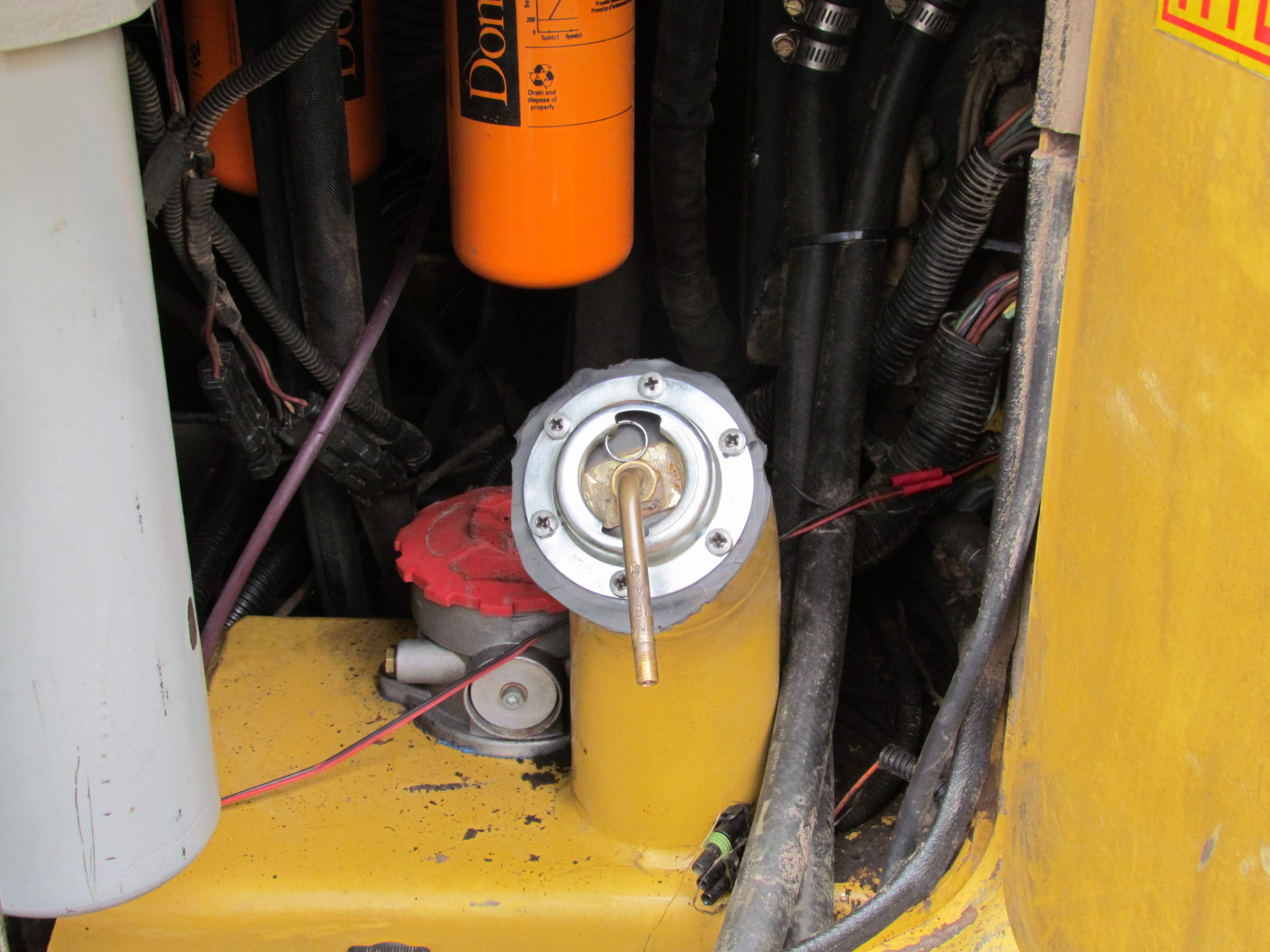

I've had a leak on the hydraulic tank on the C140 for a while and it's been a PIA trying to find it until today. It's been letting moisture in so it above the oil level. This is how I found it, using an old truck inner tube I cut the rubber around the valve, drilled the holes and fitted it to the filler, connected some air then went looking and listening. Found it after 10 min. Rayco's great welding (NOT) is the problem. Don't use more than 10psi or it could blow the delivery hoses off the pumps. 001.jpg :thumbsup:
/ Hydraulic tank leak #3
I've "rigged" a lot of different ways to pressurize tanks before. But I think I like your idea best of all Tony. I've got to remember that for my next pressure test. Pretty slick. :thumbsup:
The other good thing about using a tyre valve is that it's easy to pressure test after the repair is done, a tyre pressure gauge is all that's needed. I just love KISS:D

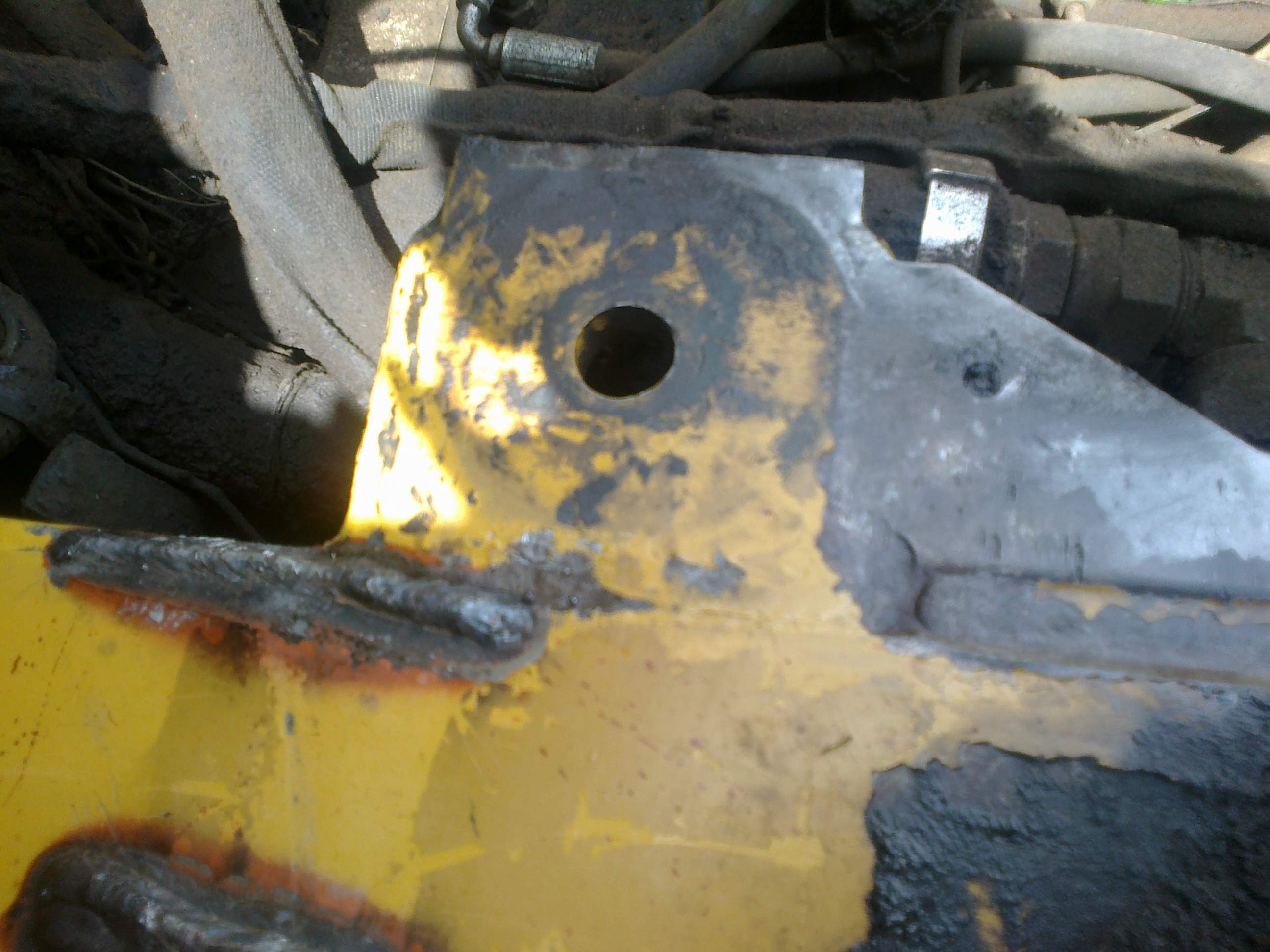

002.jpg So I found this crack on the hydraulic tank yesterday after the cab was removed. It's been welded before but I can't remember it getting done,( must be getting CRAFT:confused2:). Anyway the weld had cracked and the spilt had continued along the tank past the cab mount and past the bolt hole for the seat plate, about 9-10" in all.
