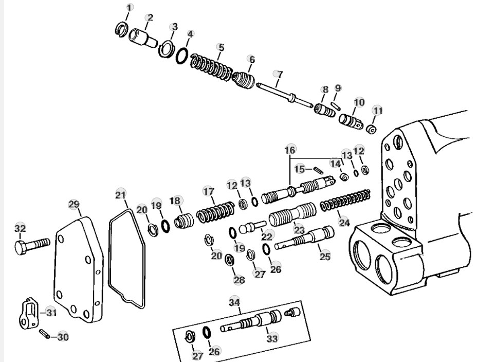

Radios 1
May I ask which valve in 4230 scv housing that you're referring to as flow compensation & your definition of what flow compensation does on a JD closed center hyd system?
Thanks you,Jim
