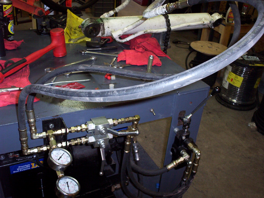

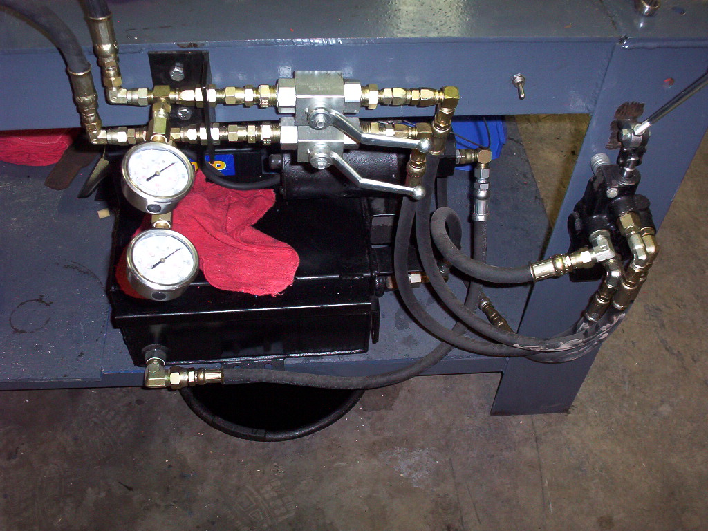

Have you ever had a pressure gauge on both the inlet and outlet of a cylinder at the same time? I can tell by this statement that you never have.
   / hydraulic splitter sizing #14
Well youre right. Ill have to try it. Cant see why thered be much on sump return ever cuz it wastes power and artificially limits the force available from the cyl. Also, with a std open center valve the cyl would extend in centered position if the return line pressure were high [even 100psi] since both inlet and outlet are connected to the return.

I do it everyday.
Second pic is a Yanmar excavator cylinder undergoing a pressure test after resealing.
In a perfect, textbook world, the "drain" side of the cylinder would have zero pressure. Unfortunately, the world is not made of textbooks.
