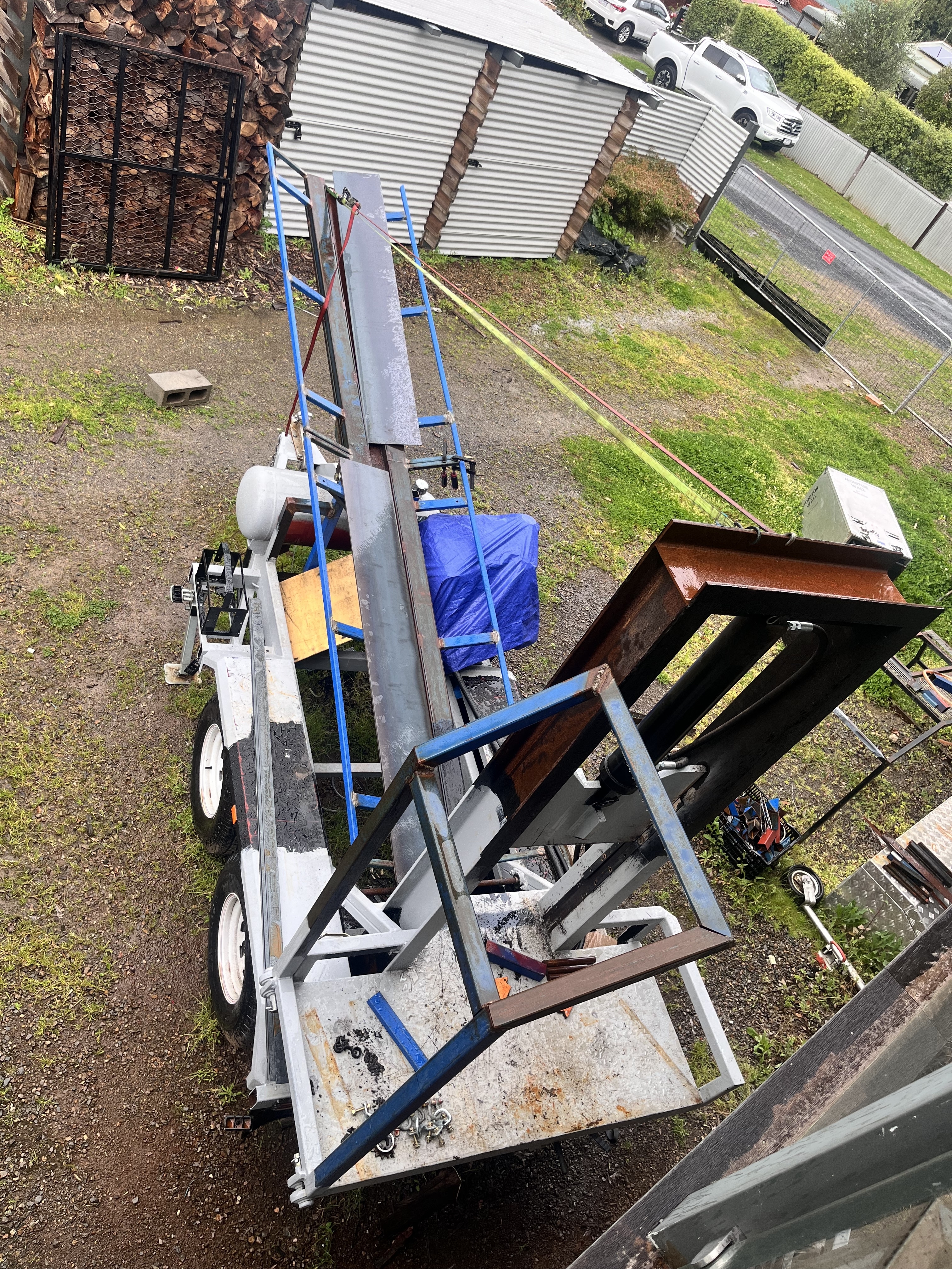

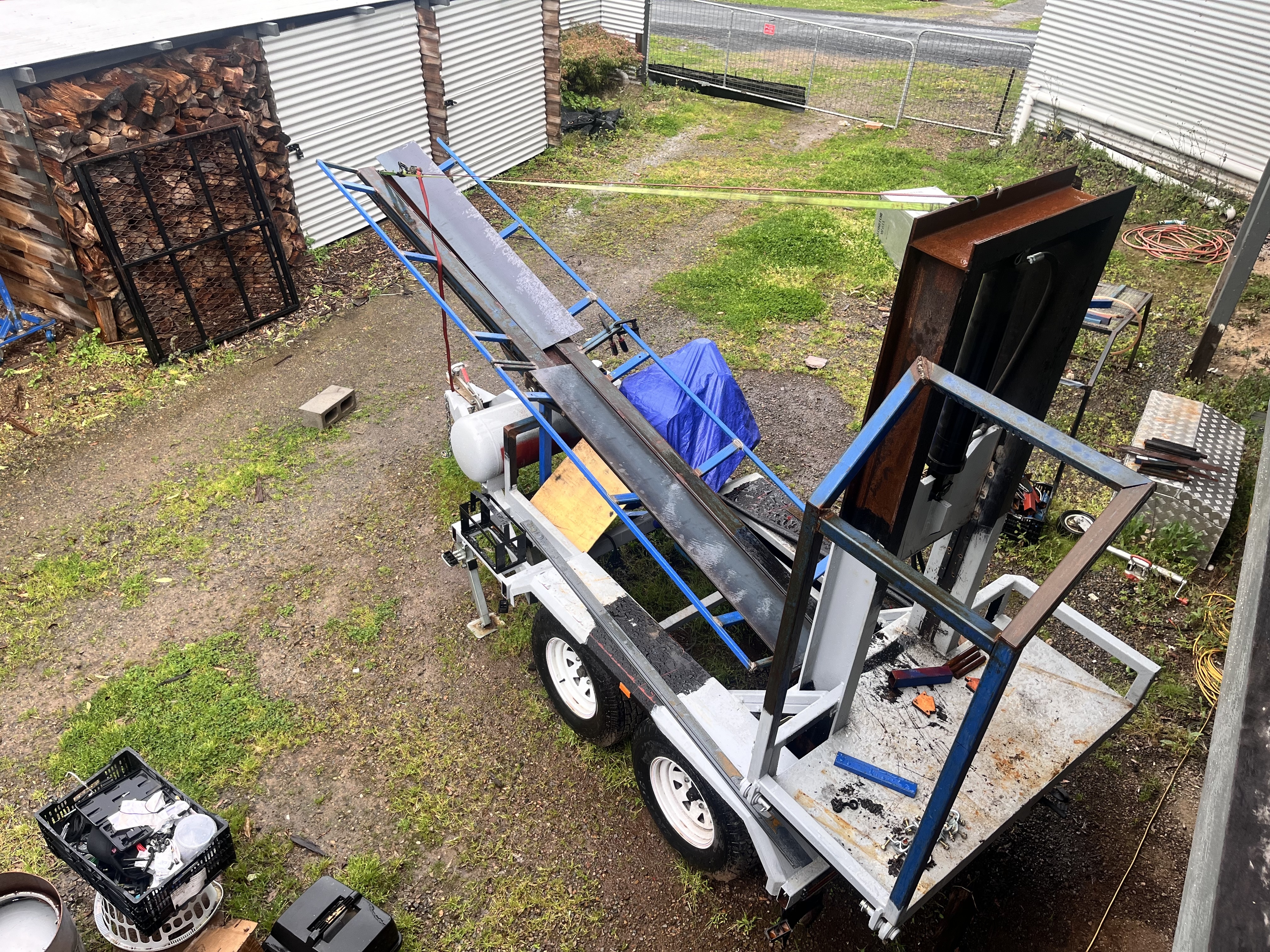

Looking to get some help sizing a hydraulic motor to suit an output conveyor on a wood splitter I've been putting together. Basic spec's of the hydraulic setup are...
Motor: Cox 24HP Petrol Engine
Hydraulic Pump: Hydraulic Network CBT22.9/7.6-L03-C
Hydraulic Valve: Hydraulic Network LSV81035340
The pump is a 2-stage and will output 90L/Min upto 60 bar, and then drop to 22L/Min over 60 bar.
Looking to get another of the same valves with the indent to run the conveyor motor, and if I've done my sums right, to get a 0.5m/s speed of the conveyor then I'll need a 65rpm drive.
