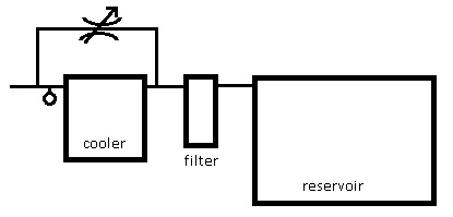

More to think about. I chugged the numbers and the 31 gallon reservoir gets you about 4000 BTU/hr of cooling with oil 100°F over ambient (assumes no wind or sun load). Go look up coolers and you will have a hard time finding one that small. Backs up what several of us have said - a larger reservoir just buys you time due to time it takes to heat the added mass. If it buys you enough time between coffee breaks great, otherwise it would be cheaper to increase the cooling or possibly decrease the system losses (which create heat).
Piloon has the right idea, but I do not recommend putting a cooler on the pump inlet. You want to keep the inlet restriction at a minimum to maximize pump life. It could cause a collapsed inlet hose and/or air leak resulting in cavitation.
The standard solution is to add an oil-to-air cooler, but you could use Piloon's suggestion of tubing, etc. Anything that increases the surface area, especially with forced air flow, will help. Scavenge a stand-alone transmission cooler from a truck and position it so the engine air blows across it. Most tranny coolers are rated around 150psi, but your mileage may vary. :)
The idea below will allow you to use a cooler designed for less than 28gpm. A company I used to work for did this on one of their off-road forklifts to avoid bursting the cooler in cold weather. I highly recommend the pressure gauge so you can monitor the back pressure with cold oil and adjust the bypass opening, thus preventing a failure.
ISZ
/ Hydraulic Resevoirs #17
ISZ,
I have seen check valves installed to act as cooler by-pass valves in place of the flow control. This eliminates the need to fine tune the flow control as the temperature changes.

Why not add something like a trans cooler from a car? That is designed for hyd fluid.

I have a couple questions about the rad. Could I use a rad between the tanks and have it gravity fed? I would go from the outlet of the first, smaller tank, through the rad at very low pressure and into the inlet of the second tank. If that is possible, could I then use an automotive rad since there would be virtually no pressure? I'll also look for a trans. cooler but may be more expensive.
I'll have to take a closer look, but I don't think I can get a pulley on the drive shaft of the engine, the pump and bracket are in the way. I don't know of any other sources of extra heat, I have no diverters, flow controls etc.
