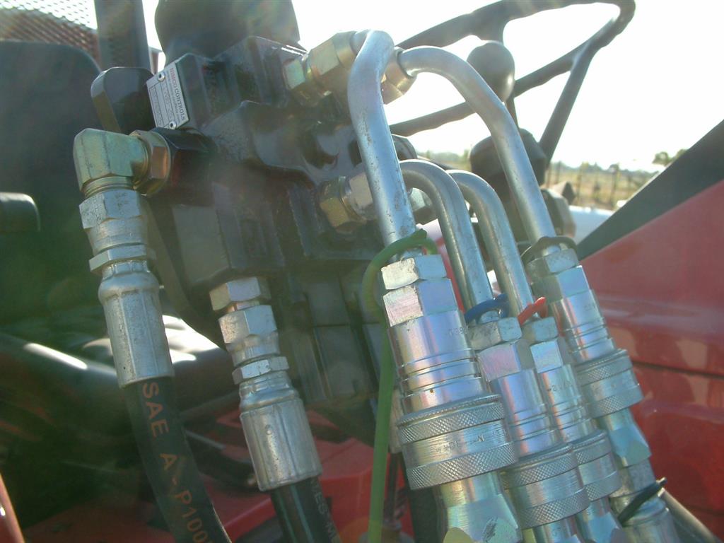

/ Hydraulic Remotes...Again! #13
Here are a few photos of the triple rear remotes I had the dealer install on my new 2008 Mahindra 5525 when I bought it. Dealer's design. $750.
The connection to the power beyond (PB) port on the side of the FEL joystick block .
The output (return) line from the triple remote valve block (white tag).
The input line to the triple remote valve block from the PB port (white tag).
The return line from the triple remote valve block connection to the hydraulic reservoir (white tag).
The connection to the reservoir (white tag)
The triple control valve block for the remotes.
The three pairs of quick disconnects for the rear remotes.
Hope this helps.
Good luck
