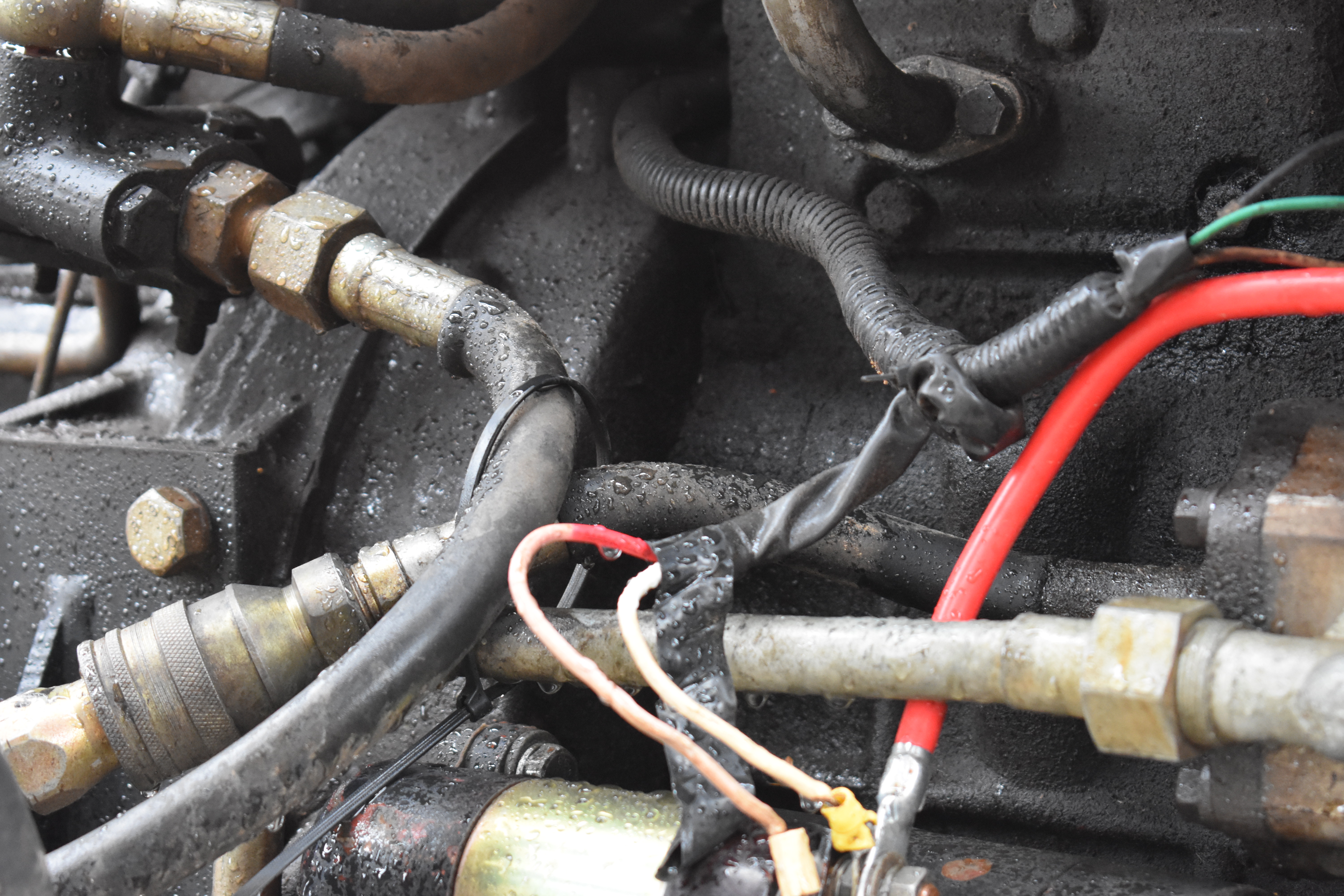

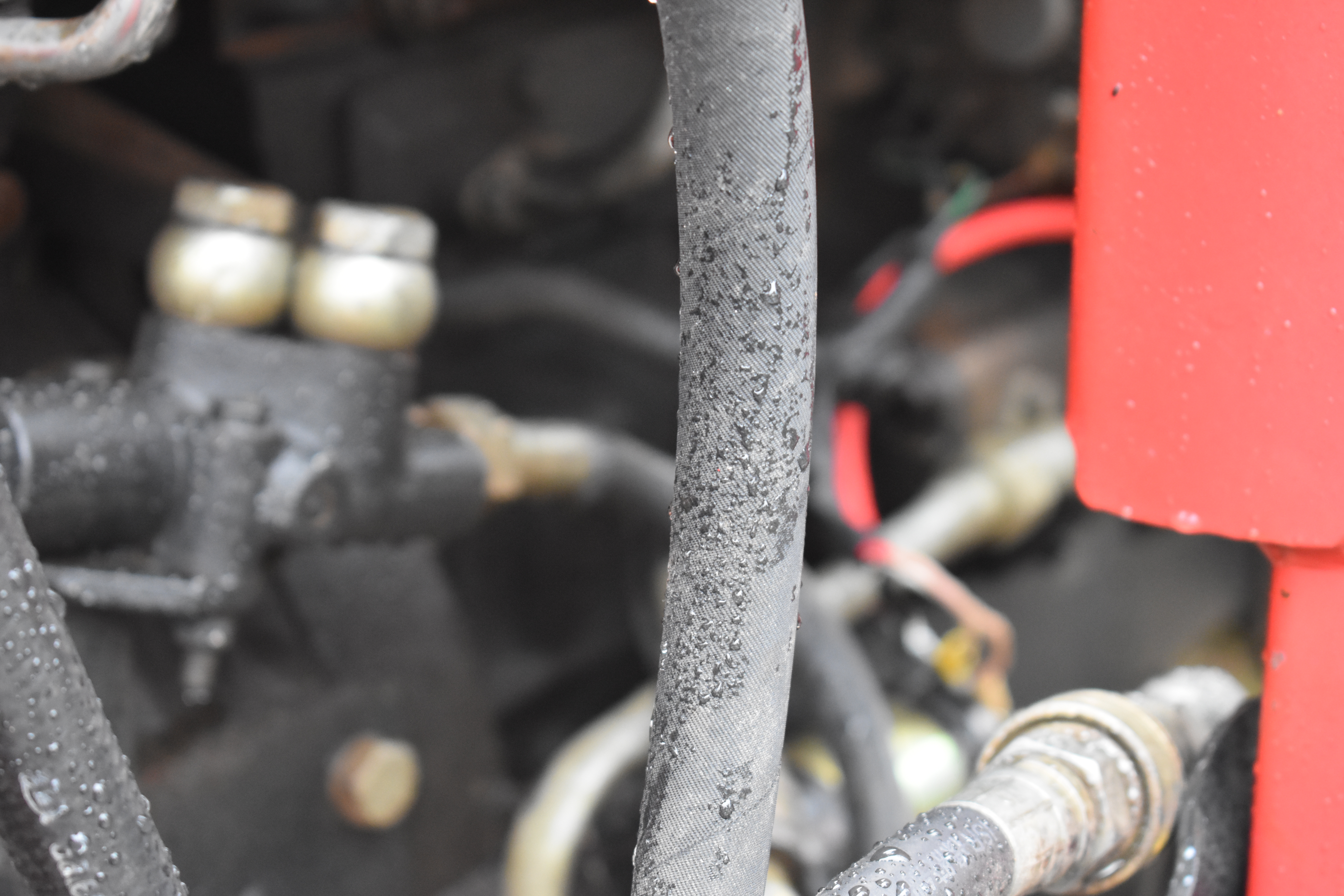

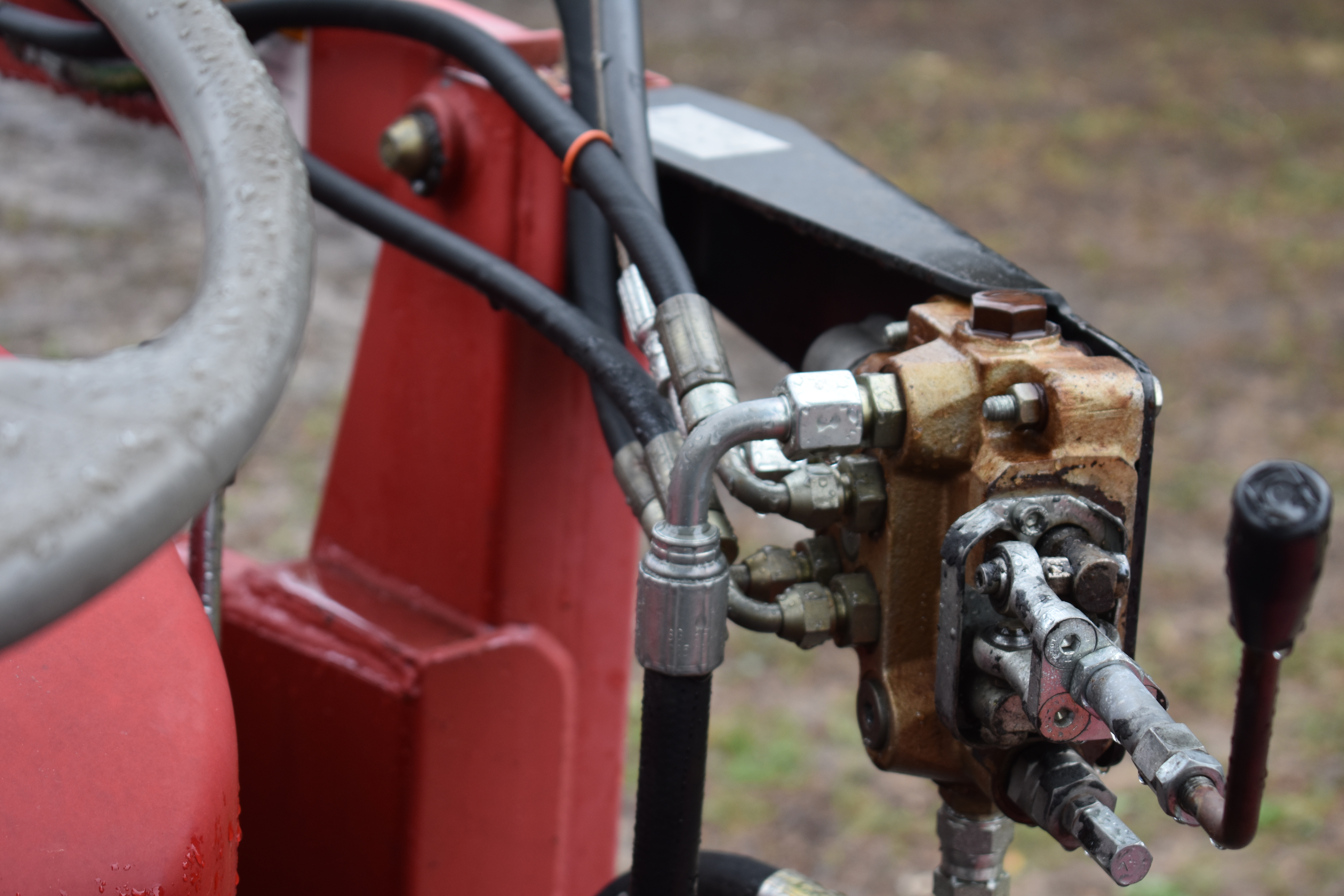

View attachment 503411 View attachment 503410 View attachment DSC_0005.JPG View attachment DSC_0004.JPG View attachment DSC_0006.JPG OK, pics attached hope they come through. It looks like they diverted the line out of the pump went to the loader and back to the tractor. There is a line into the loader valve, four going from the valve to the loader pistons and one back to the tractor. If I tap in there for pressure go to a single remote valve then back to the other line it should work just like the loader right.
/ hydraulic remote #5
...If I tap in there for pressure go to a single remote valve then back to the other line it should work just like the loader right.
No, "T'ing" into the pressure line will not work. Your tractor has "open center" hydraulics... Power from the hydraulic fluid goes from one valve, then to another (3 point hitch). If you "T", the pressure would just bypass your new valve, path of least resistance.
You can replace your 2 valve spool loader valve with one that has three. Make sure it's for open center and has power beyond.
The reason people add more hydraulics is because adding only one valve is pretty expensive but if you ever plan to have hydraulic for Top and Tilt or for 3 point implements, adding 3 is not much more money than just 1.
PS. your first 2 photos didn't load...

The loader valve in your picture looks like you can add a PB fitting. The way you wanting to do it could put back pressure spicks on the up stream valves and well get the spool seals leaking.
