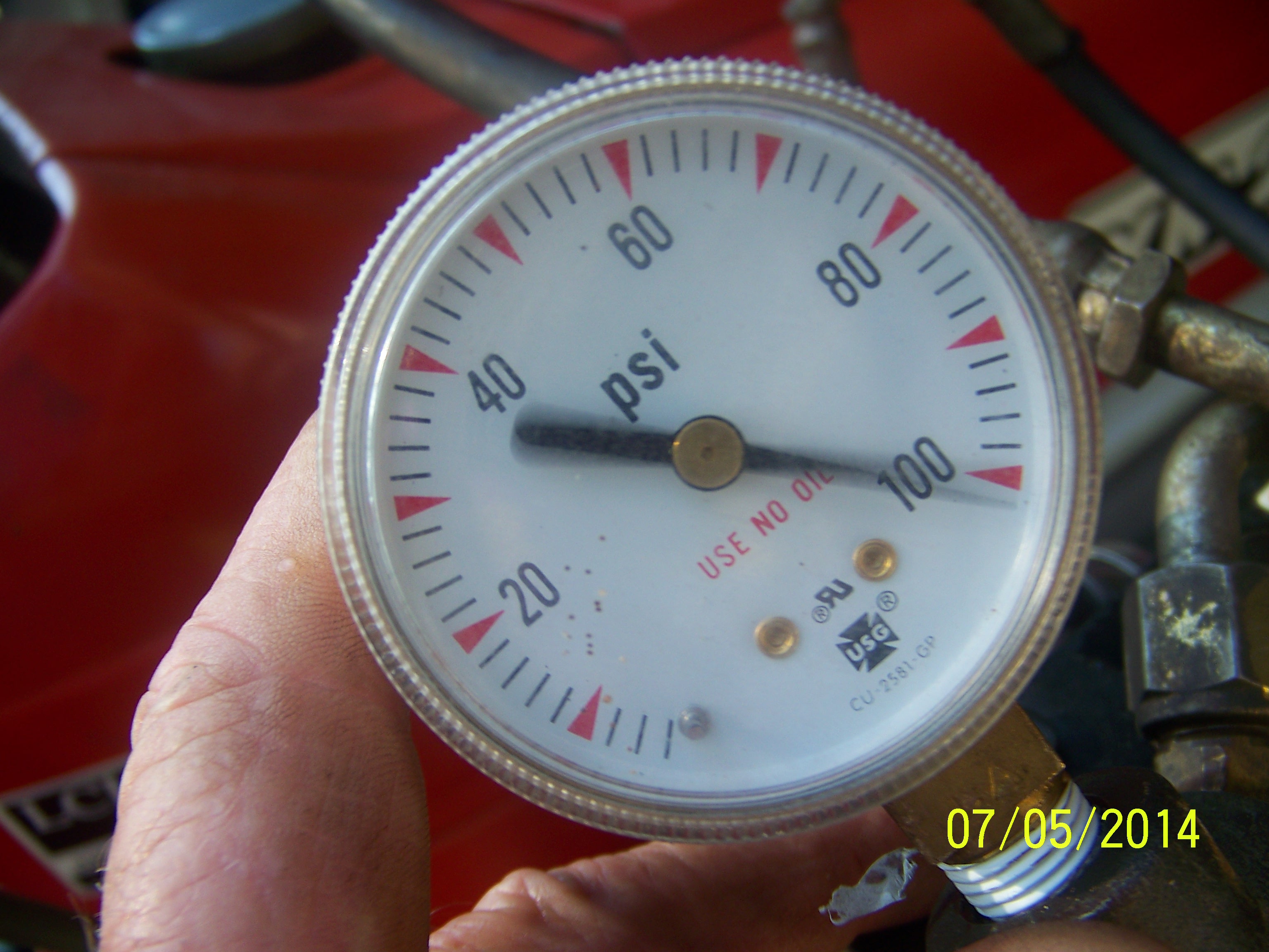

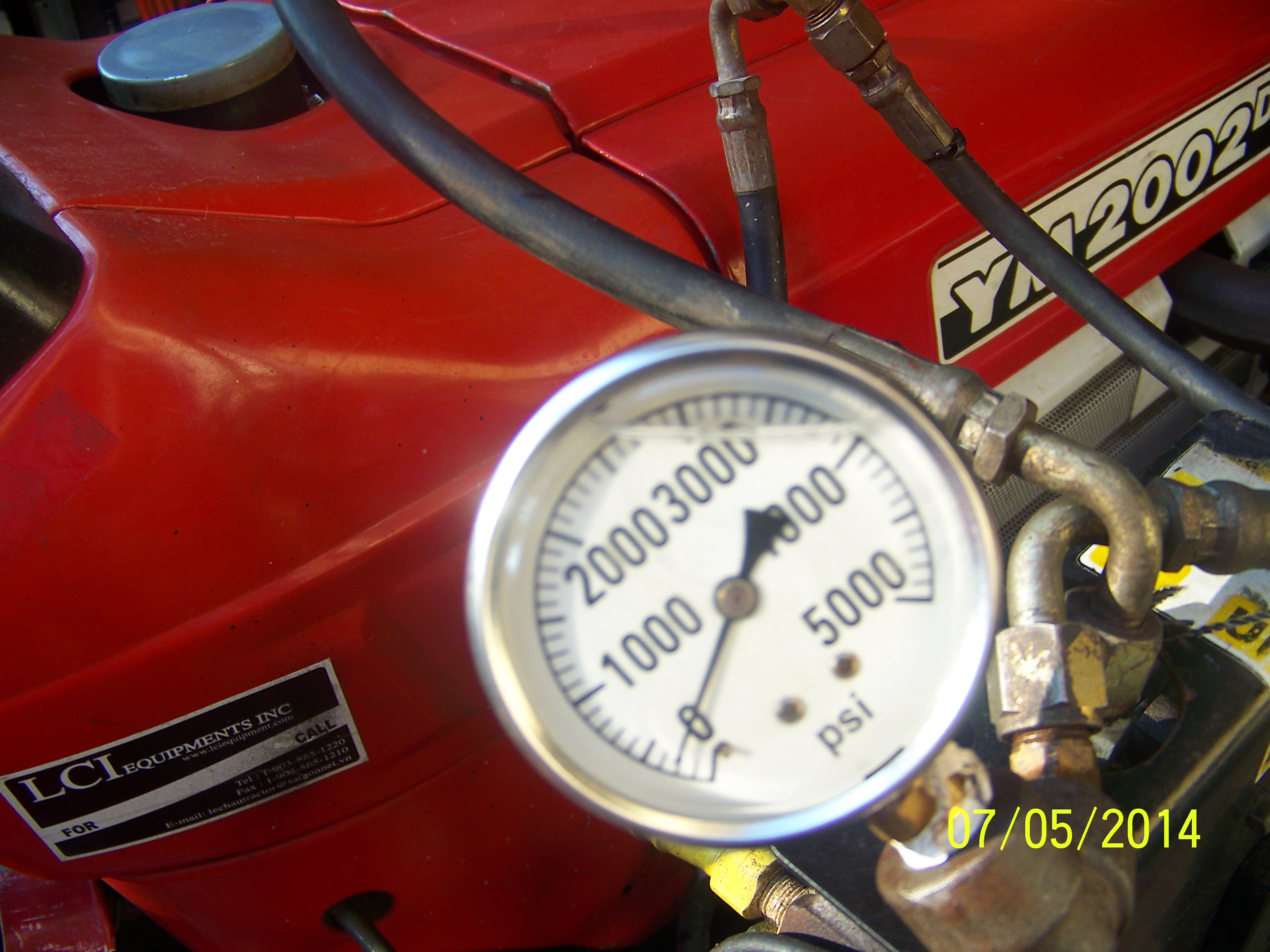

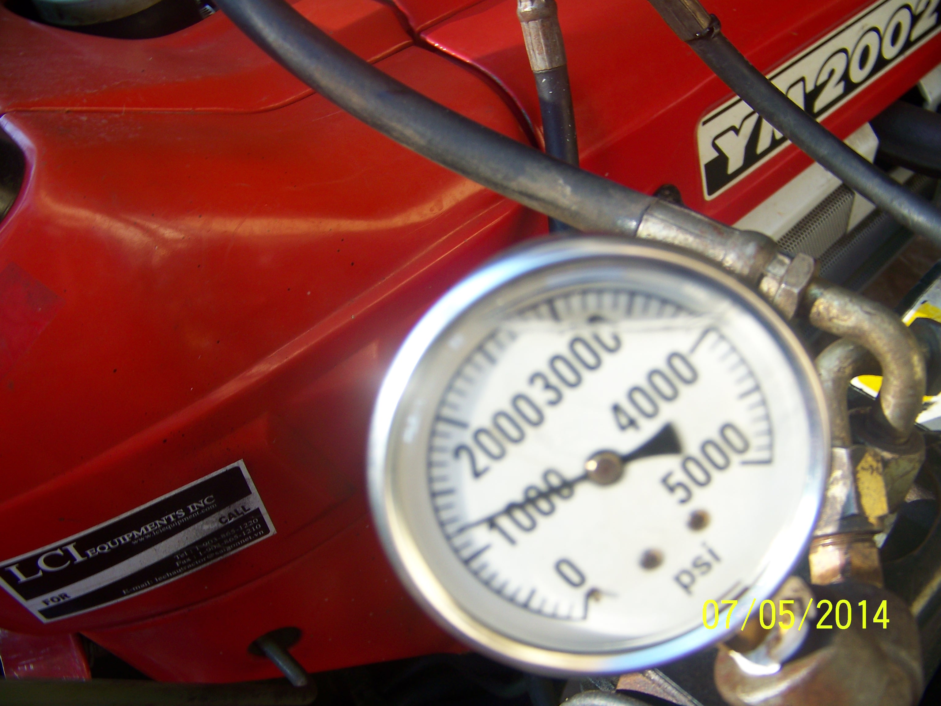

Test results are in. I teed in off the power beyond on my loader control valve. Woods mower weighs in at 503lbs per Woods.
Raised position with tractor idling at 700rpm the low pressure gage registers 40psi.
Raised position with tractor running 1150rpm the low pressure gage registers 100psi.
Raised position with tractor running 2000rpm (not sure) the high pressure gage registers 250-300psi.
Tractor running 2200rpm with mower in process of raising the high pressure gage registers 1200psi
I have checked my relief valve pressure in days past and I know it was in the 2100 to 2200psi range.
No picture to support it but when idling at 700rpm and turning the steering wheel (power steering) the pressure drops from 40psi to around 20psi. The diverter valve working.
