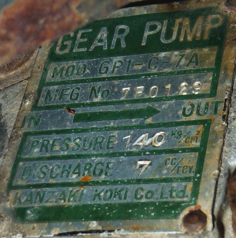

My YM240 (YM2000) has the optional adjustable-width front axle. I thought I read somewhere that this 7cc/rev hydraulic pump was also a step-up, to sell as a 'loader-ready' tractor. Anybody know?
This works fine for farm use if you aren't in a hurry. But I would want faster hydraulics if I used the tractor primarily as a loader.
Also: Is the hydraulic pump turned 1:1 with crankshaft speed? What is 7cc/rev, in gallons per minute?
I wonder how this system is designed - revving the engine doesn't seem to make the loader faster above moderate speed, maybe 1400 rpm.
/ Hydraulic pump - Capacity?? #2
Don't know if the pump is driven 1:1, if it is, 7cc per rev at 1800rpm would be 12600 cc or 3.33 US gpm or 2.77 IMP gpm. (140kg sq.cm is 2000 psi btw in case you weren't sure)
If the ratio is different, multiple accordingly, i.e. if it'd driven 2:1 it would be double etc.......Mike

The 7cc is the standard pump. The upgrade was a 9cc pump.

if the pump is driven 1:1, ... 7cc per rev at 1800rpm would be 12600 cc or 3.33 US gpm
Thanks! That is the math I was looking for.
Presuming it runs 1:1 and they rate it at pto speed then 2200/1800 x 3.3 = 4.54 gpm, which I think is the spec for the standard pump.

My YM240 (YM2000)I wonder how this system is designed - revving the engine doesn't seem to make the loader faster above moderate speed, maybe 1400 rpm.
My loader will move a little faster with the engine revving . But, I'm usually above the 1400 mark. Going from 2000-2250. It would be great to have it move a little faster
/ Hydraulic pump - Capacity?? #7
GPM is a function of engine speed, the more rpm's, the more GPM will flow. If it is not producing more flow at higher speed, then I would suspect a worn pump which is bypassing.
Using a larger pump will provide more GPM's. It will also take more HP to run it.
