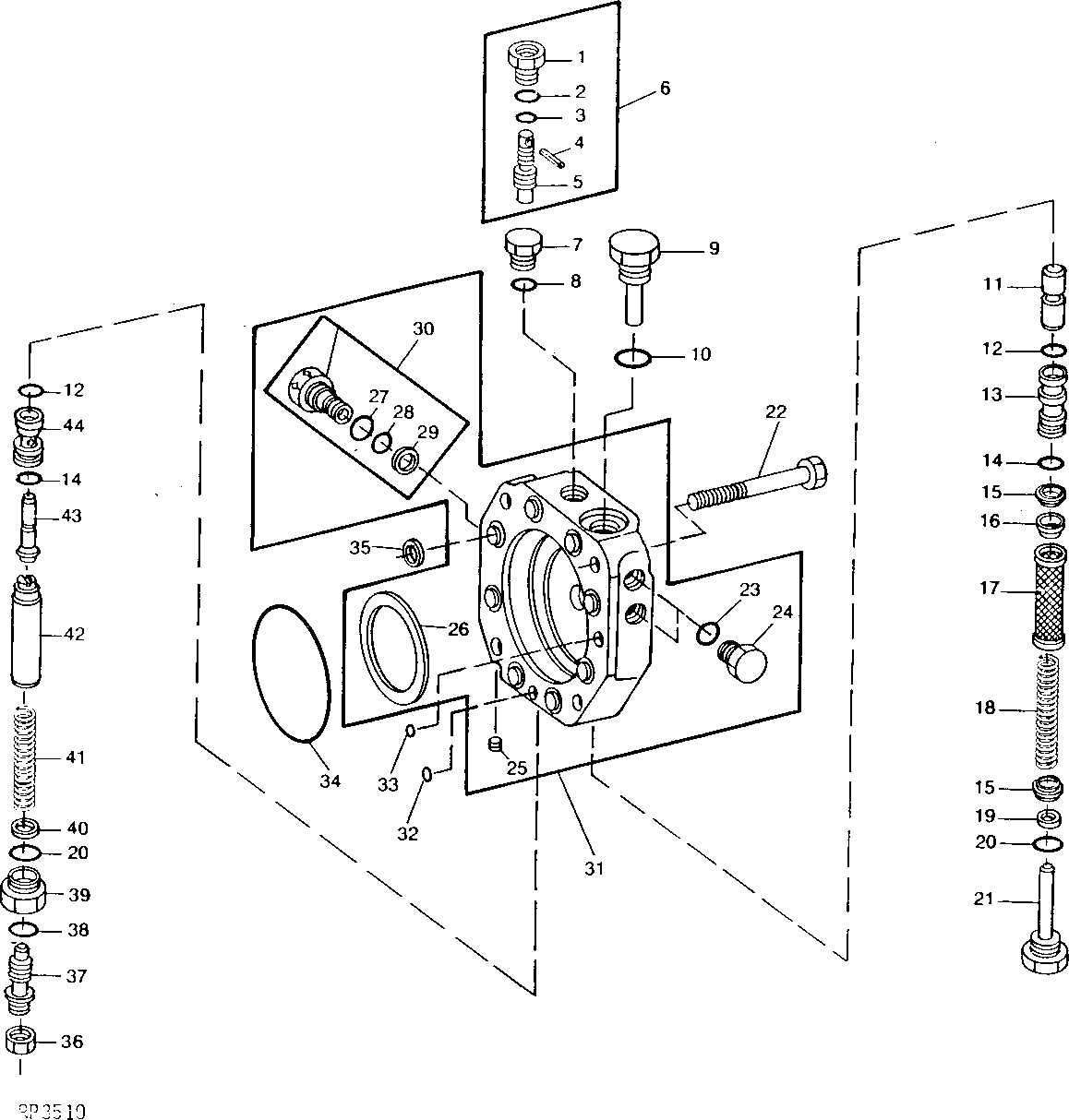

Thanks do not have a loader or loader valve on this tractor would oil come out the hydraulic pump on line 13 and flow to the back end I have nothing in line 13 could this mean its the hydraulic pump on the front ? Thanks
   / hydraulic problems on 2030 #22
On loader I got you confused with author of this thread and your post . I'm now leaning toward the stroke-control valve(parts key #42-44) malfunctioning in frt hyd pump. You could try loosening parts key #37 and re-tightening but you really need a 3000# hyd gauge to set stand-by pressure to 2250 psi.
