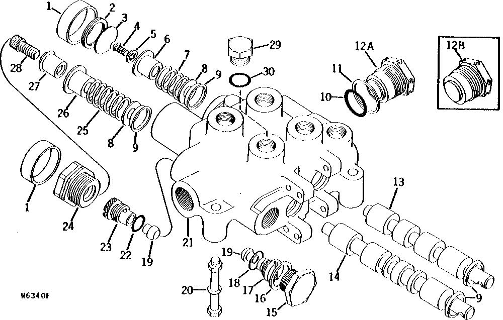

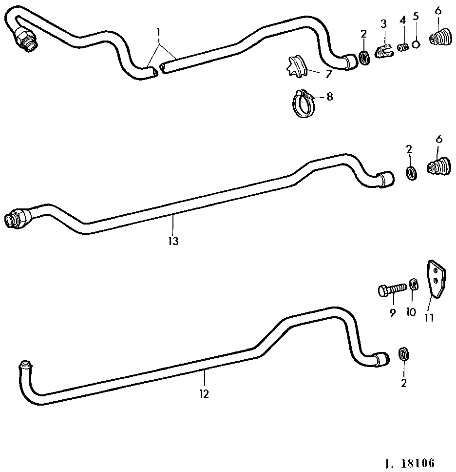

Thanks do not have a loader or loader valve on this tractor would oil come out the hydraulic pump on line 13 and flow to the back end I have nothing in line 13 could this mean its the hydraulic pump on the front ? Thanks
/ hydraulic problems on 2030 #22

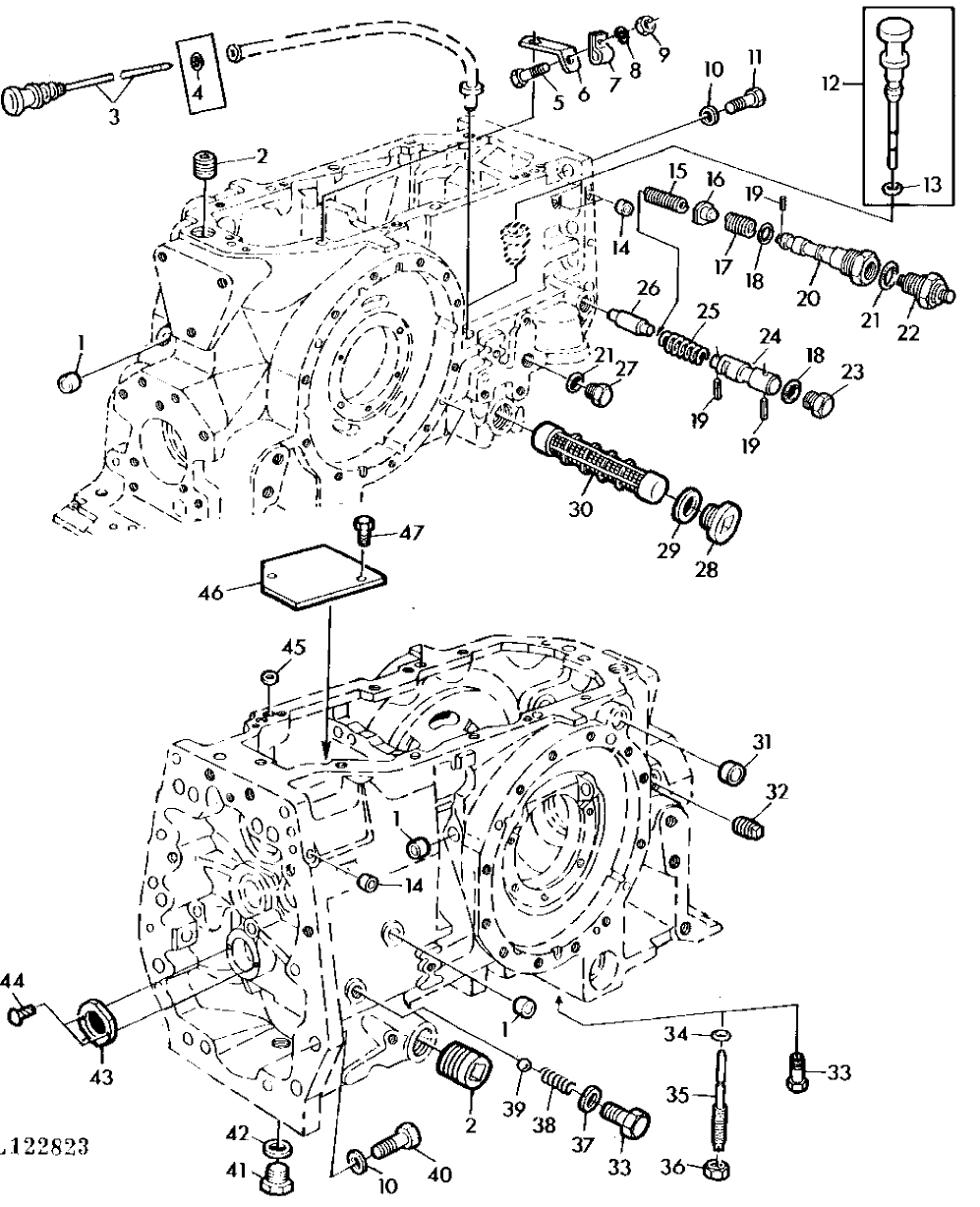

On loader I got you confused with author of this thread and your post . I'm now leaning toward the stroke-control valve(parts key #42-44) malfunctioning in frt hyd pump. You could try loosening parts key #37 and re-tightening but you really need a 3000# hyd gauge to set stand-by pressure to 2250 psi.

It's possible you have a broken internal line for your PTO. I had the clutch pack line for my independent PTO break and lost all hydraulics. Disengaged the PTO and hydraulics then worked. Engaged the PTO and the internal leak prevented oil from the trans pump from reaching the front pump. You have to split the tractor to replace this line. I should have replaced the PTO brake line too, but never thought of it until after the tractor was back together.

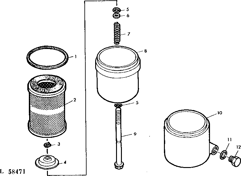

Hi thanks for reply the coupler is fine not sure when filter was changed not sure where it is and sump screen check not sure what this is? And the pto is controlled from a leaver just underneath the steering wheel on the right hand side next to the hand throttle.
