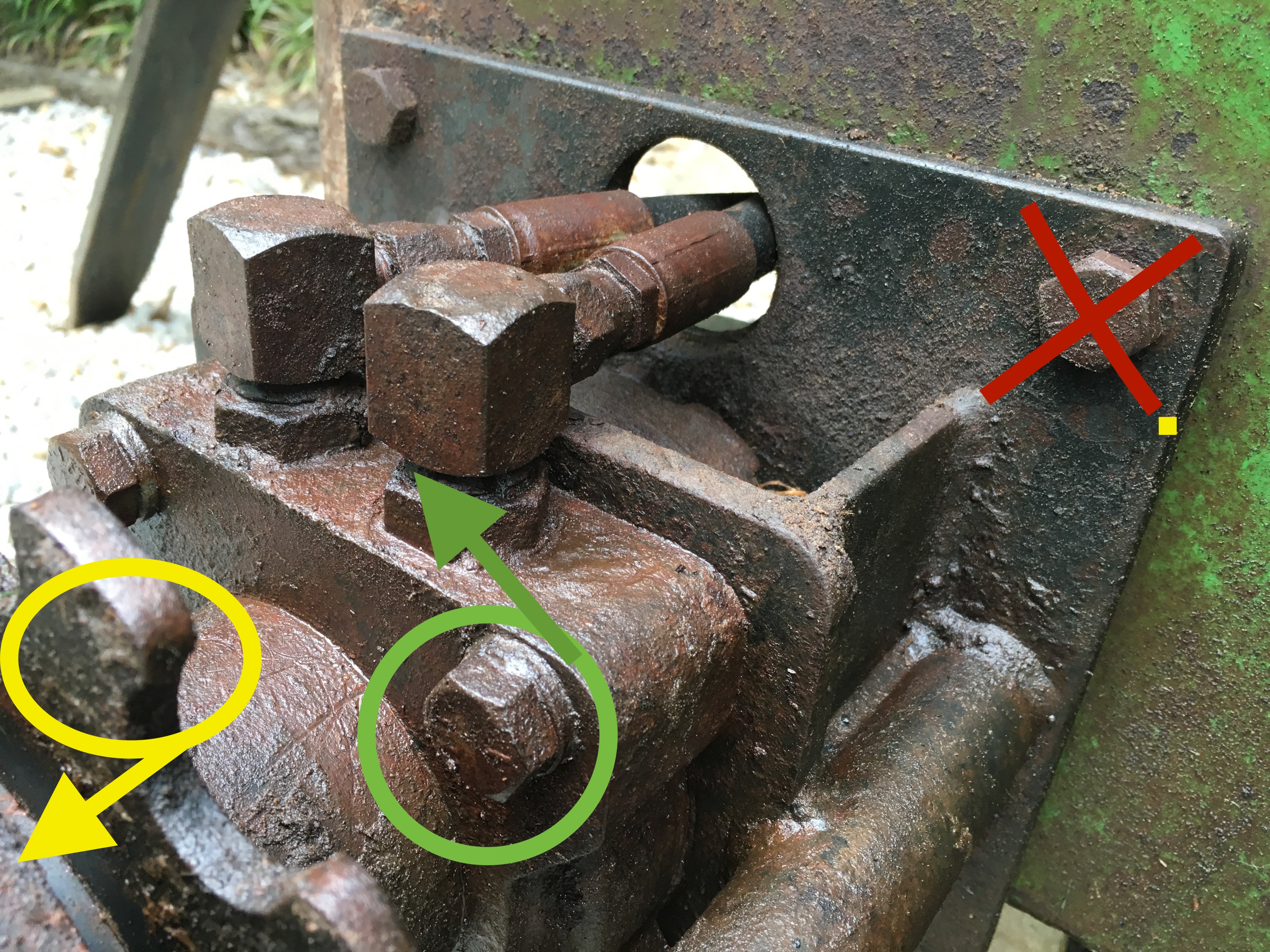

Here's a typical white wheel motor picture for reference. It would seem if you took those 4 bolt out, the motor has to slide out, away from the machine. And that would mean there has to be about a 4" diameter hole in that plate (or whatever the motor diameter is) for the motor to fit through. The bolts would slip through the motor, through the plate, and probably have some nuts on the backside that we can't see in the picture. :scratchchin::
   / hydraulic oil leak near left front wheel #56
Well, lets see if I can I can help.
If it was me, I would mount your wheel motor mount back on. It will give you better leverage as you get the actual motor off. I do not have your machine so I am sorry if I miss understand how your machine works...
So the photograph. The red X is the bolts taht hold the motor mount on. I believe you removed these. When reinstalling, make sure that the steel is clean and no debris is between. You will need to really put some pressure on tightenint these bolts. I don not beleive you need any thread locker, others may disagree.
Ideally you would remove the wheel hub, but as I noted it takes special tools and is usually a major PITA. It is probably going to be better for you to ship it. The wheel hum I am referring to is what is marked in yellow.
What I did note on the picture is one of the 4 bolts you need to remove, it is circled in green. But as I said, you probably need to put the motor mount back on because you are going to have to put some serious pressure on these bolts to get them off.
OK once you do this you are going to get something that looks like this. This is NOT your wheel motor, I don't have the energy to trac it down but this is kinda what they look like Yours is going to have that plate on the front because you cannot get of the wheel hub off
Finally you need caps. for your hoses. You can get these in a myriad of places, I would look first for a Hydraulics shop, if not, look for a napa. These are great to have in your repair kit, so buying nice metal ones is adbvised. Here are a set of plastic ones I initiall got before I went to metal

Now onto the on-going drama. Attached is a pic of what's on the opposite side from the notched brake rotor. There are 7 bolts that have to be removed to get inside. Does the photo look familiar to anyone? Keith said to send the whole unit which is 36 lbs (weighed it!) To-and-from ups shipping is almost $100. (Ouch!) Also Terry said I could "slip out" the wheel motor. If there is something behind the 7 bolts that can be sent to powertrac it should much lighter and less costly to ship. Incidentally Keith said to send the whole unit, all 36 lbs of it. I will check with Terry before I do that.
Woodland Farms sent a nice photo with the parts in question on my PT425 marked with red, green and yellow. Thanks a bunch! It is the bolt marked in green (4 of them) that have to be removed. The ones in red stay on. The yellow is the notched brake rotor. The picture I attached shows what the side opposite the notched wheel rotor looks like. Because powertrac has so many different models for the PT425, it seems that unless your machine is the same model as mine (2002 model), it is likely what I am looking at is different from yours. When you take out the green bolts what you see is the 7 bolts in the photo. Right now I need to know whether or not to remove the 7 bolts to get what's inside.
