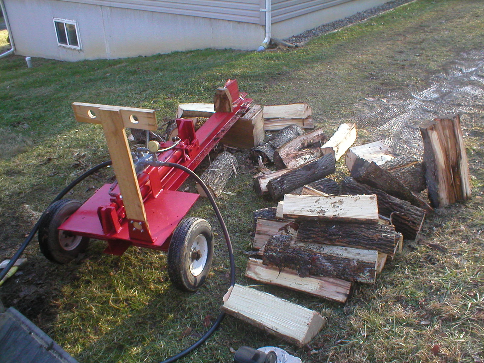

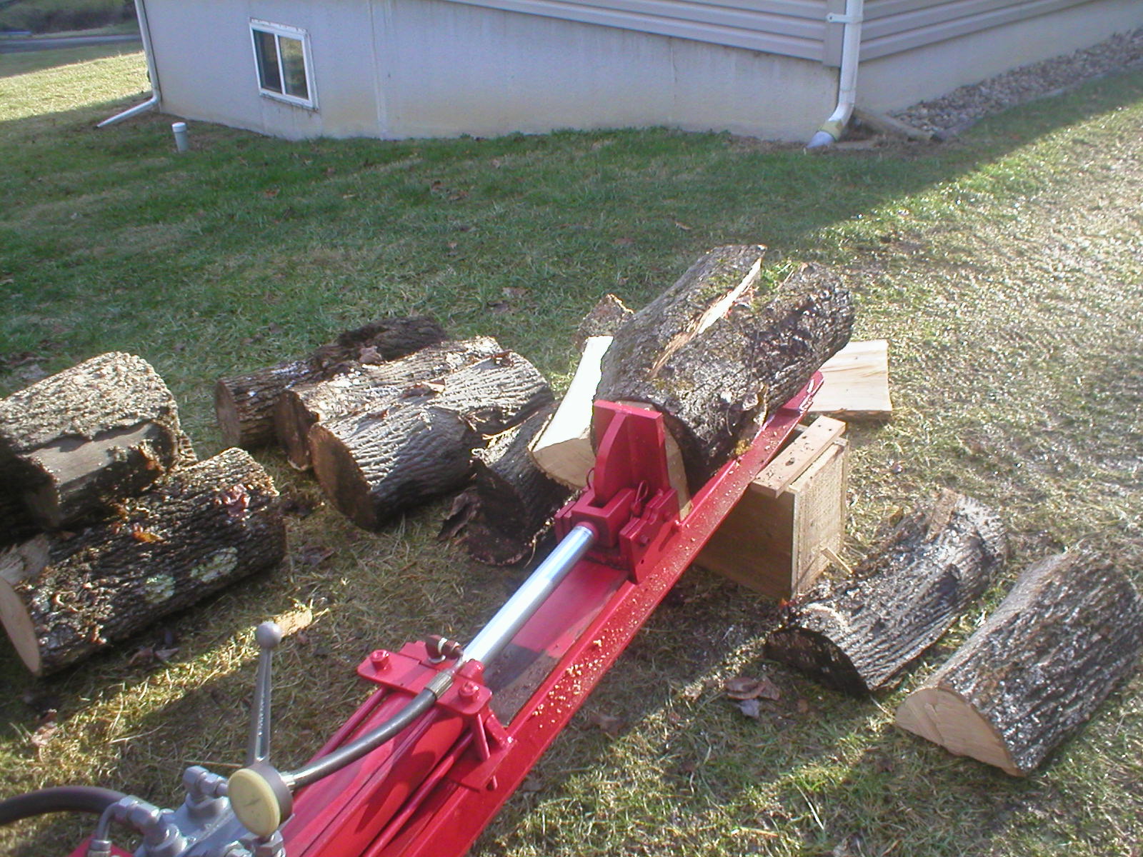

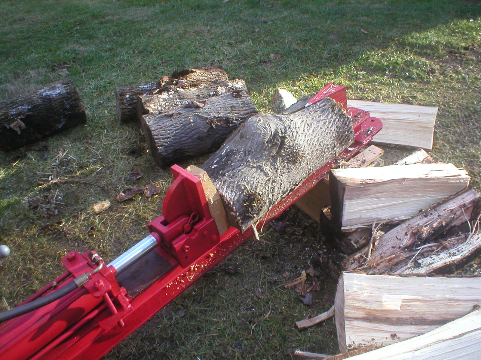

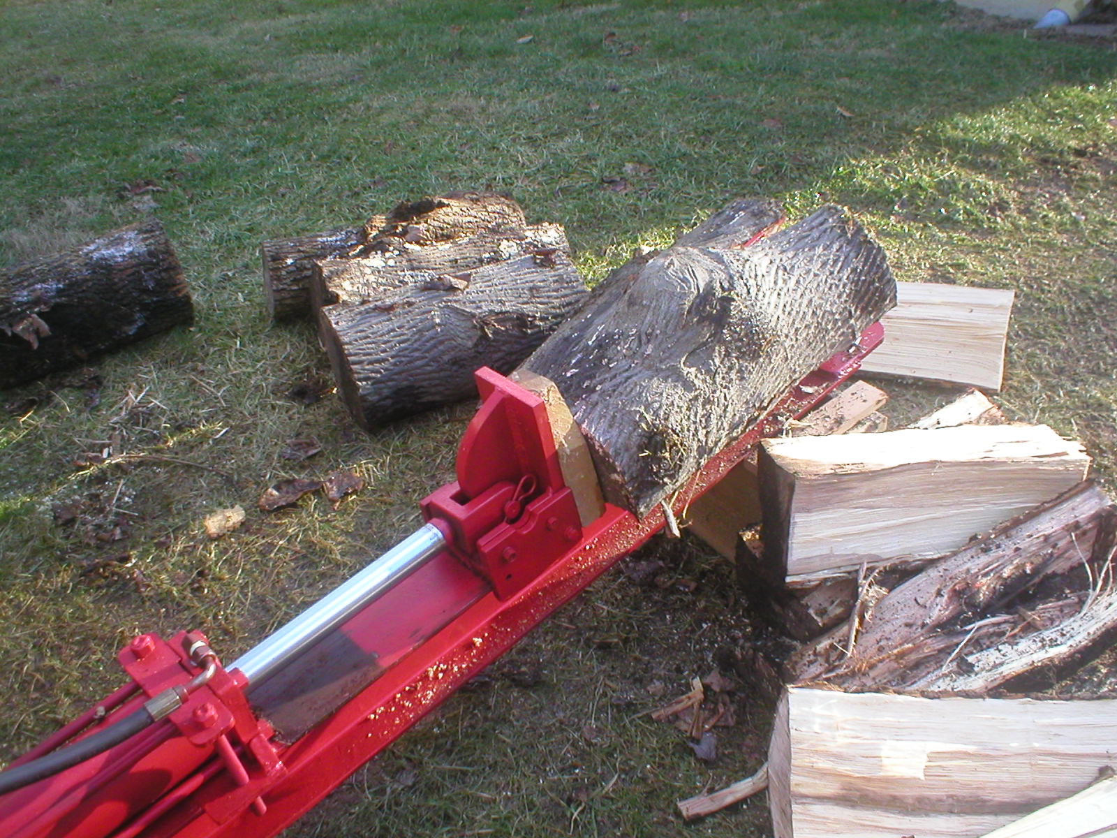

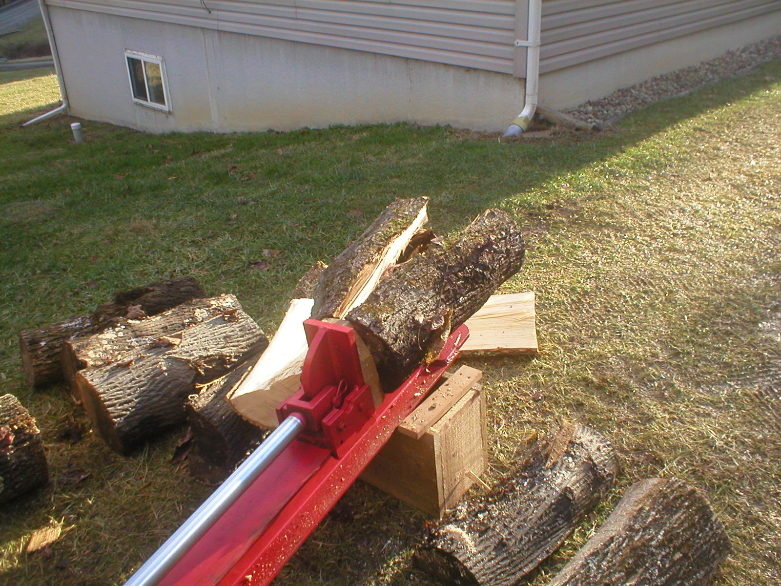

Today I finally used the log splitter to split some logs. I also did as J J suggested I put a 9 inch hickory log in sideways and it did squeal and it almost cut the log in half and the pressure gauge went up to around 2,000 psi before I backed it off. I had to get a sledge hammer to beat the log off the wedge. I wonder how many tons of force it is producing. I only had the pt throttle about half open
/ Hydraulic log splitter #65
You can probably do better on the pressure, as your machine should produce about 3000 psi.
So set the relief valve on the log splitter valve to about 2950 psi
If your 4 in bore cyl is using about 3000 psi, the force is about 37,699 lbs, or 18.75 ton.
