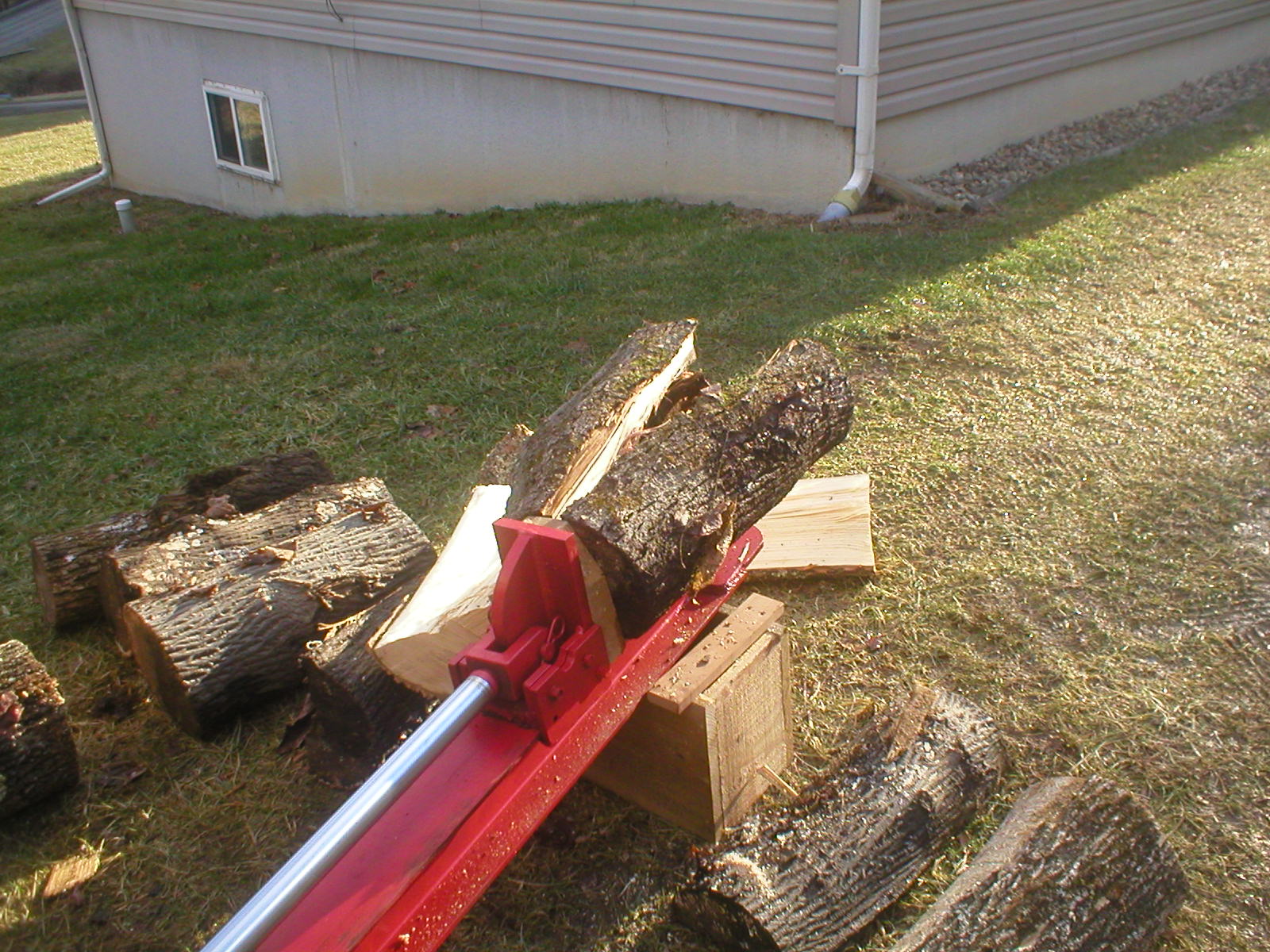

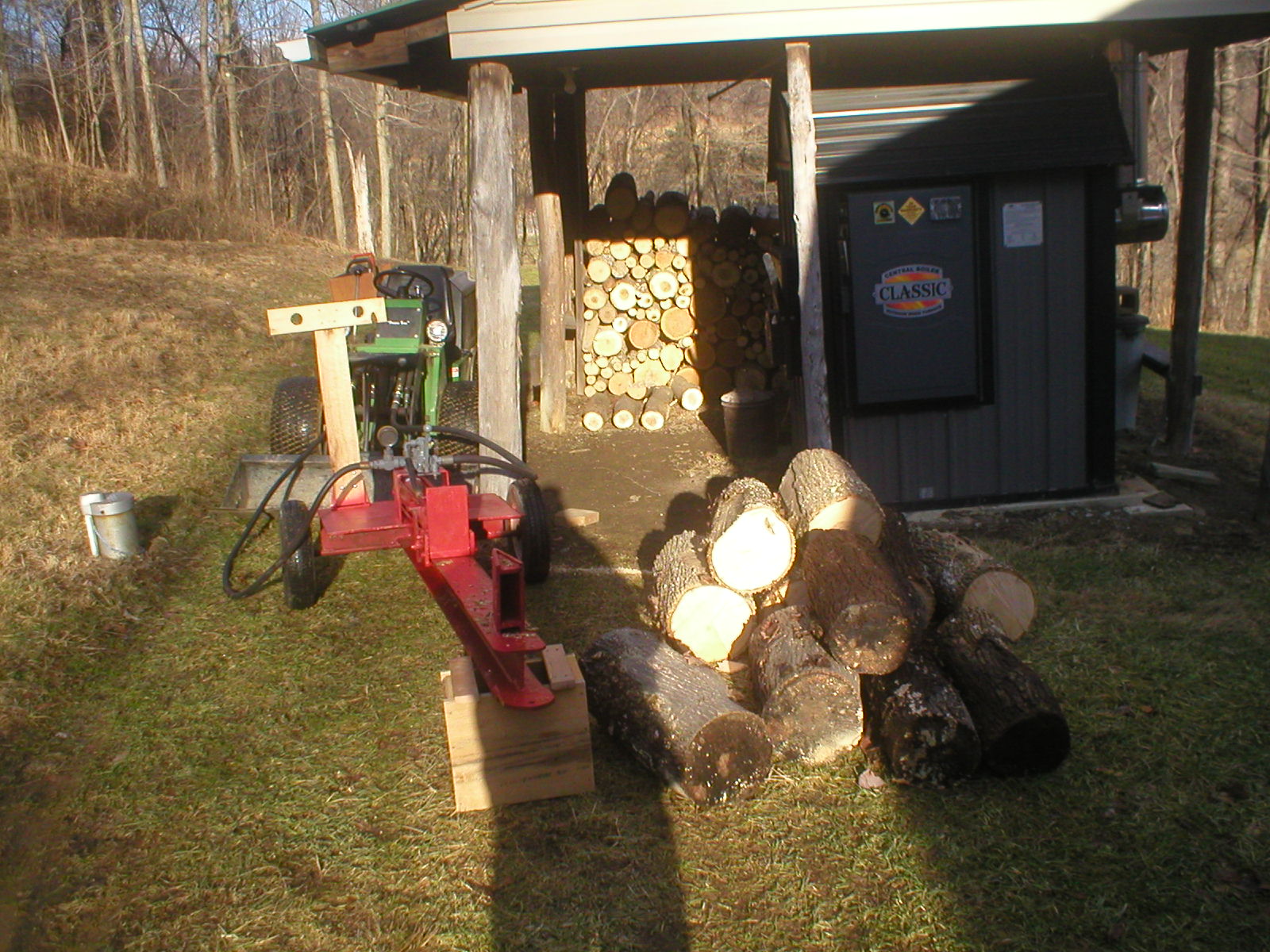

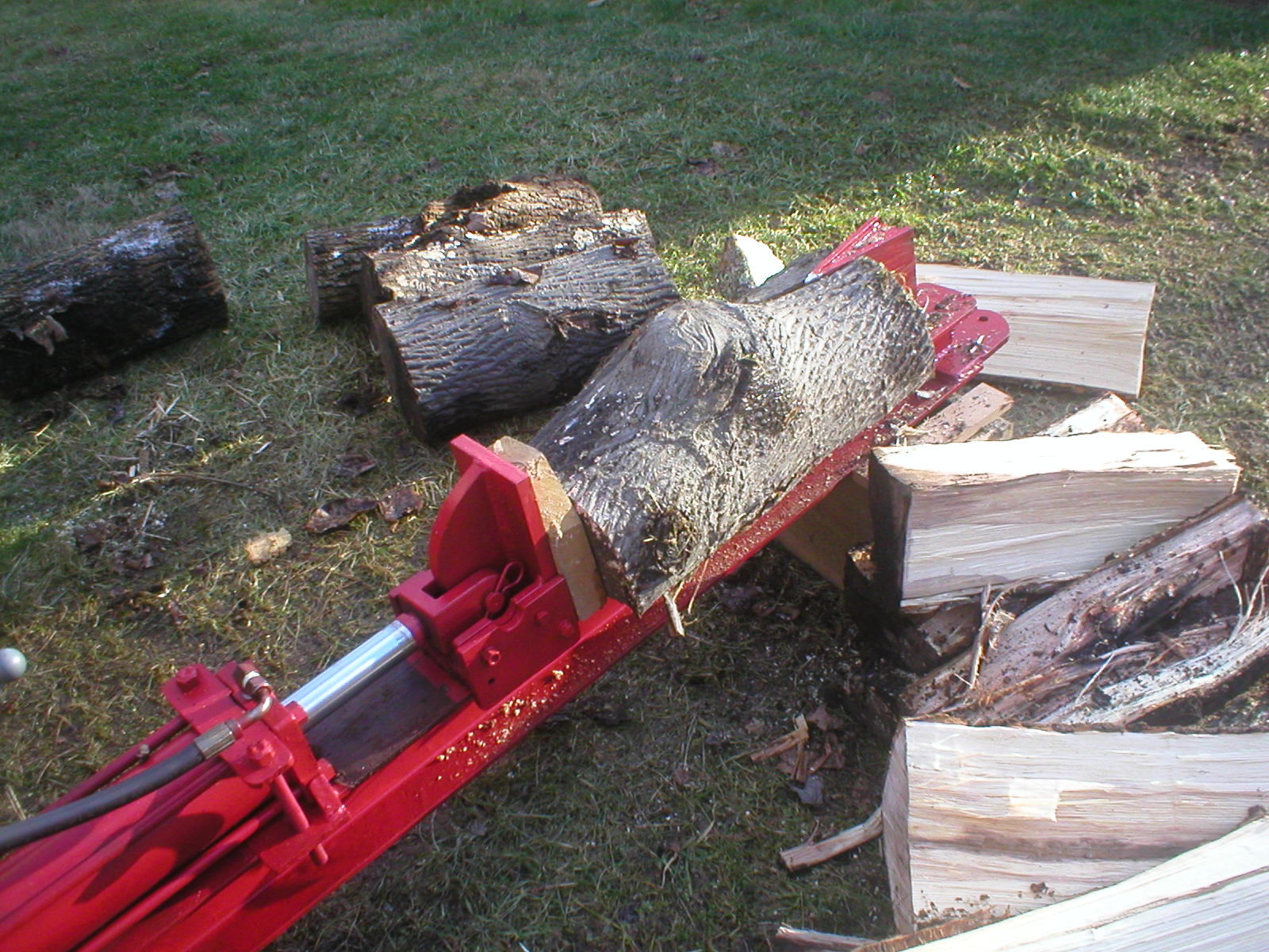

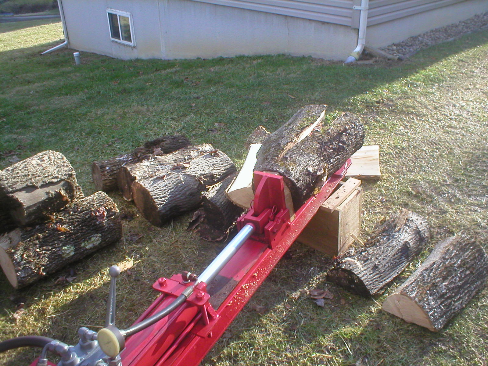

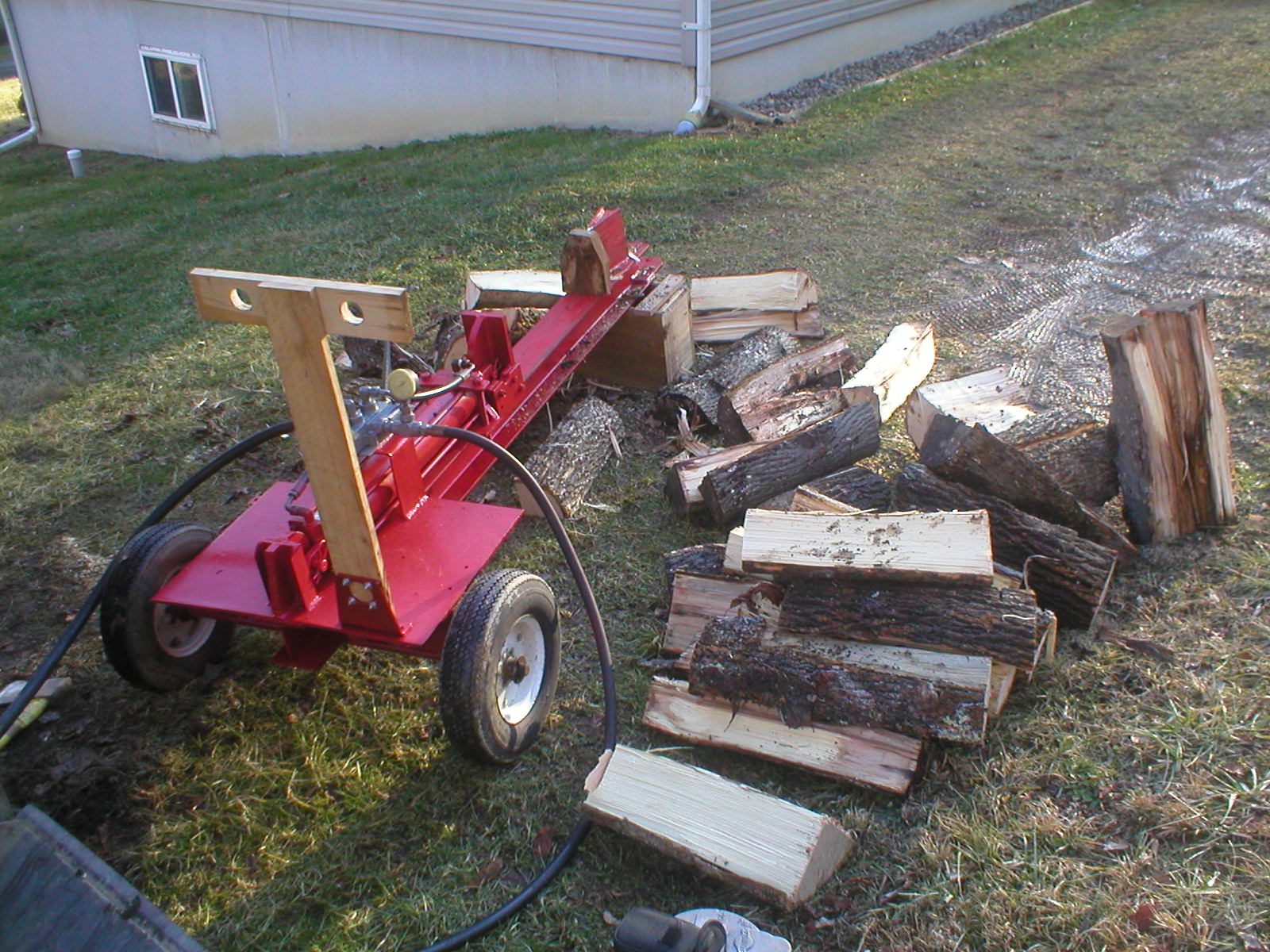

splitter 007.jpgsplitter 008.jpgsplitter 009.jpgsplitter 010.jpgsplitter 011.jpgsplitter 012.jpgIt warmed up to about 40 today so I decided to try the splitter out, I had some hickory and ash logs that I had cut last fall and this spring. I hooked the splitter to the pt hydraulics and set the throttle about 1/3 open and started splitting. All the logs split real easy and the pt engine speed never varied on any of the logs , it probably took about 15 minutes to split all the logs. See pictures. The only problem I found is the pressure gauge never moved off zero.
/ Hydraulic log splitter #40
So you're running off the main PTO and using the valve on the splitter. Nice. Any indication of engine heat with only running at 1/3 throttle?
