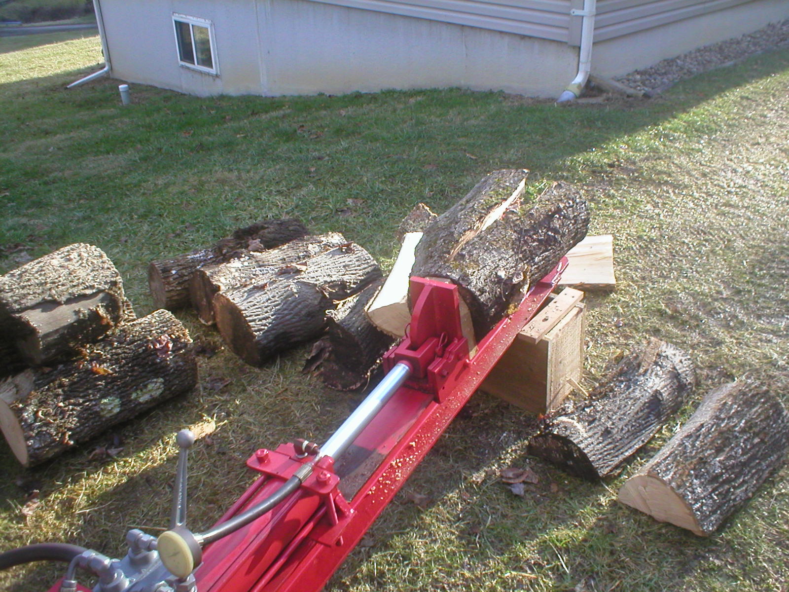

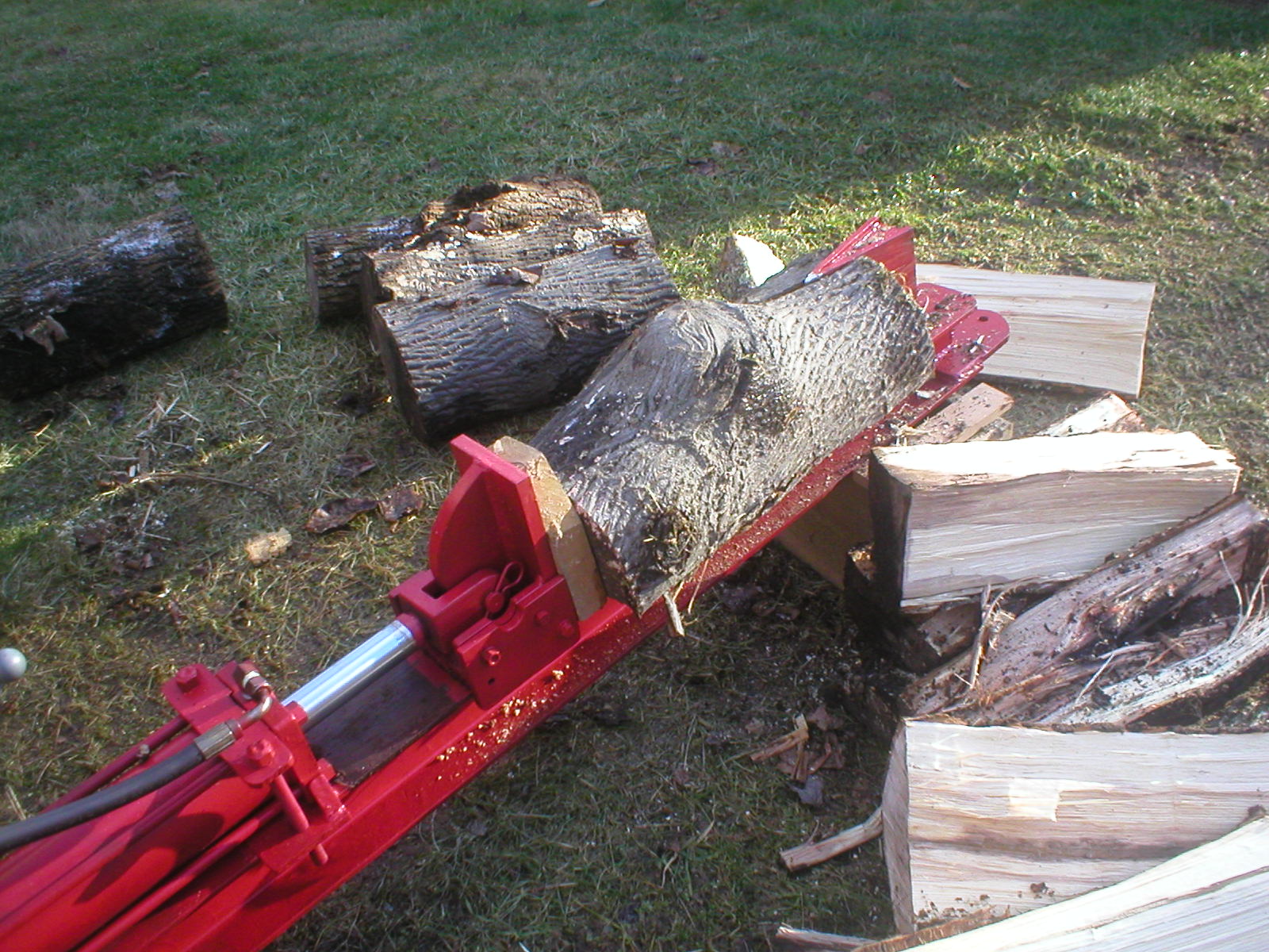

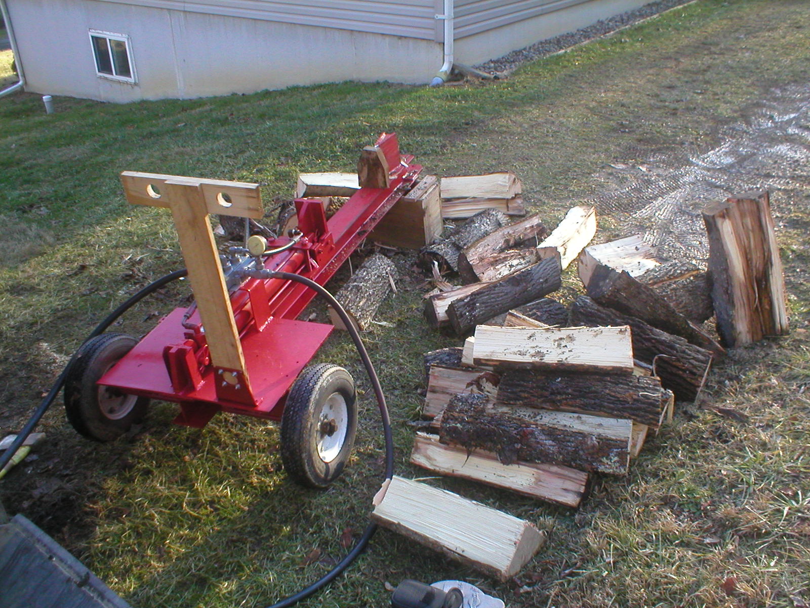

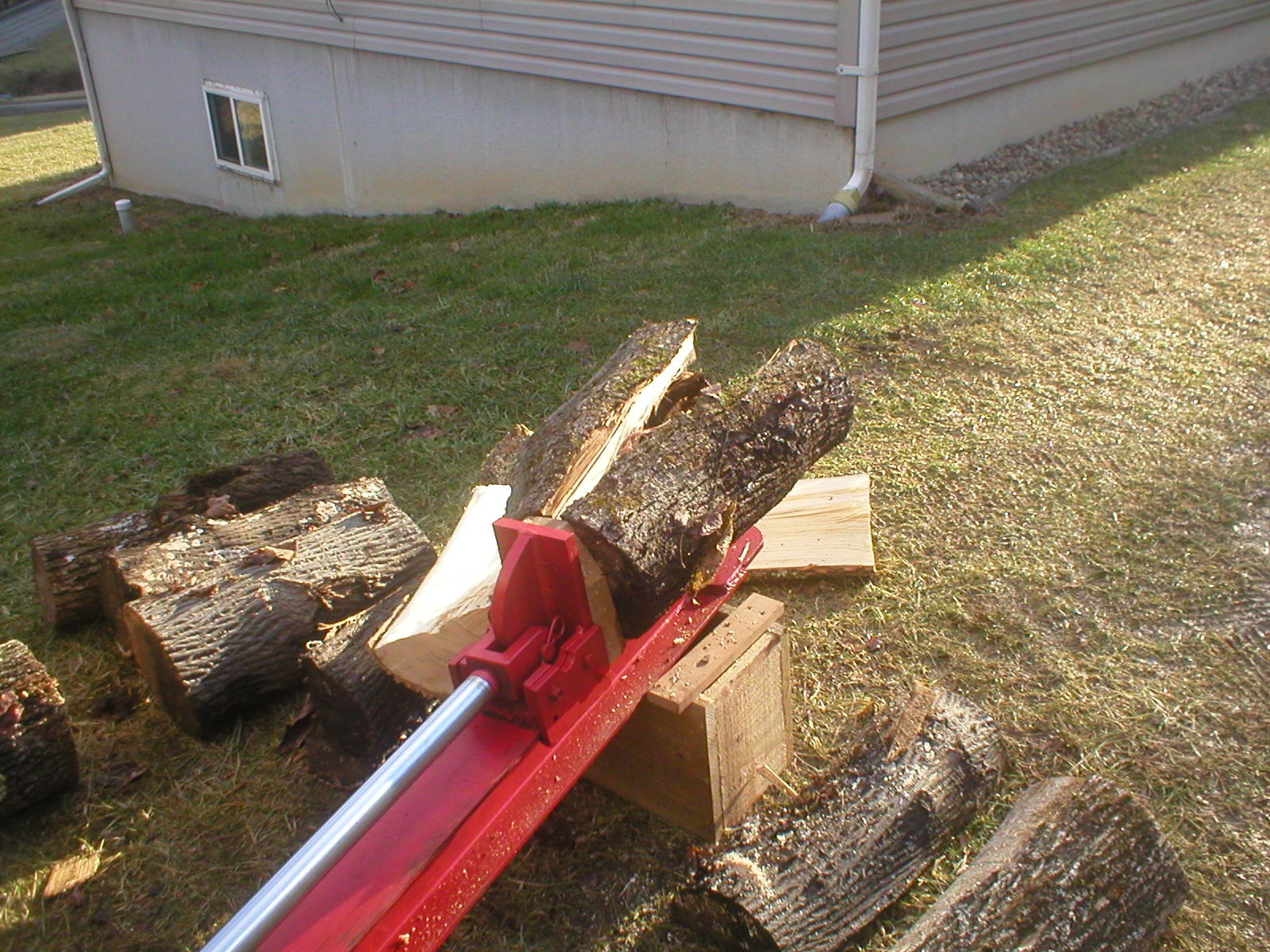

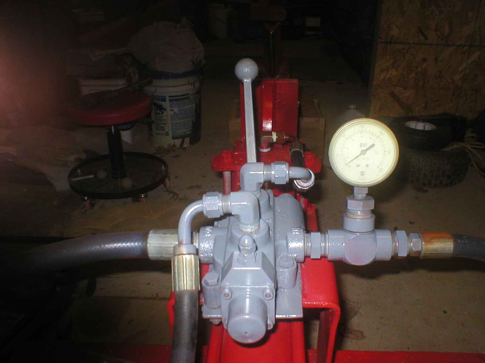

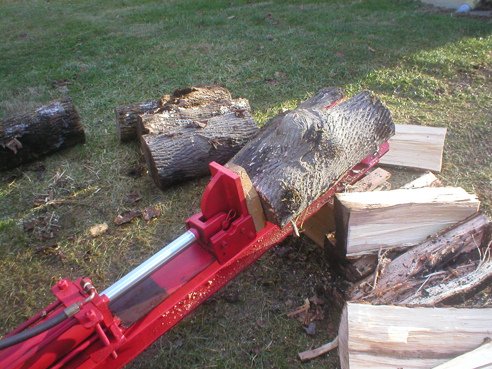

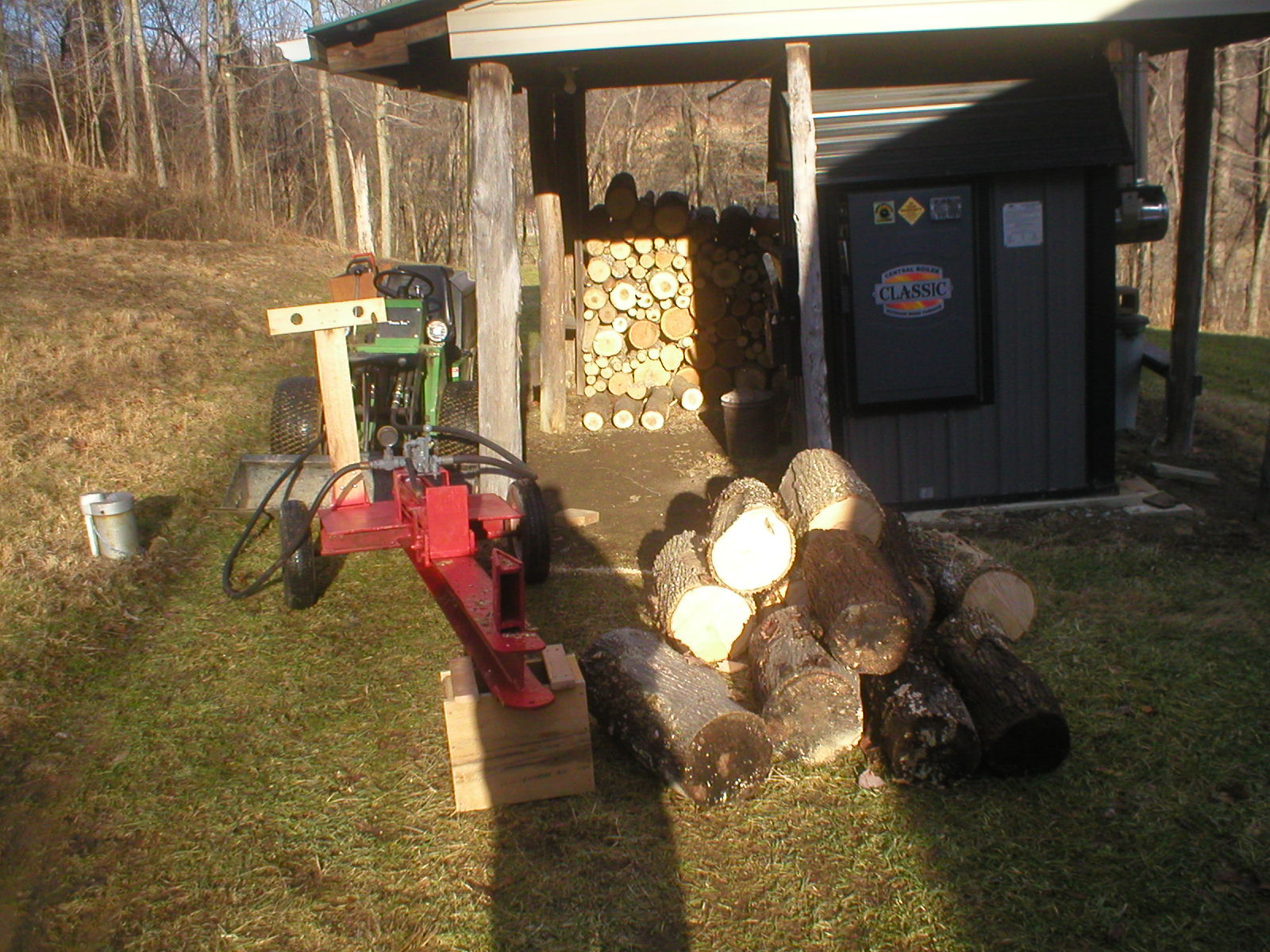

View attachment 355525View attachment 355527View attachment 355528View attachment 355526View attachment 355529View attachment 355530It warmed up to about 40 today so I decided to try the splitter out, I had some hickory and ash logs that I had cut last fall and this spring. I hooked the splitter to the pt hydraulics and set the throttle about 1/3 open and started splitting. All the logs split real easy and the pt engine speed never varied on any of the logs , it probably took about 15 minutes to split all the logs. See pictures. The only problem I found is the pressure gauge never moved off zero.
Where did you put the hyd gage?
It should have been in a tee in the IN port of the log splitter valve. The pressure side.
If you put the gage in the OUT/return side of the valve, you might show a zero pressure of little pressure.
/ Hydraulic log splitter #42
Yep, any close ups of how the gauge is hooked up? and the style of gauge and what increments it has? Cause some hydraulic gauges I have seen start at 500psi?
And we put a 0-5k gauge on our splitter once. Teed into the base end of the cylinder to see how much force it takes to split a peice. Ended up taking it off because it was hard to read. IE: most of the time it is on 0 psi, and only briefly spikes to bust open the wood. Then back down near zero as it dont take much force to finish. But by extending the cylinder all the way, and holding the valve with the cylinder out of travel, was able to see operating pressure of the splitter.

I don't believe the engine is getting very hot running at 1/3 throttle. Very seldom do I run the engine at full throttle unless I am mowing and I have never had any problems with the engine getting real hot 2,022 hours on it as of now. (Knock on wood) The pressure gauge is on the in line and goes to 3,000 psi. It can be seen in pictures 1, 2, and the last picture.

The gage should show the cyl force at any time it is working a load or when maxed out.
When maxed out, the gage will show the log splitter valve relief pressure setting. You can also use the gage to set the kick back to neutral pressure.
With the lever in neutral, the gage should show almost no pressure.

The gauge shows 0 pressure whether in neutral or splitting a log or maxed out. I believe the gauge is probably broken.

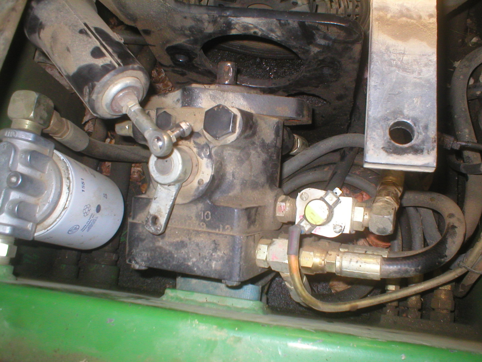

I put a new pressure gauge on the log splitter and it is showing very little pressure maybe 100 psi max. On the power trac which hose should the hose going to the in side of the valve . Currently I have the hose on the right side of the power trac (from sitting on seat) going to the in port of the valve? Is that right or wrong?

You are using the larger main PTO circuit, not the smaller aux PTO circuit, correct? Not sure which side is the in and which is the out without tracing the hoses. The one that returns to the tank is the low pressure side. Sorry I can't be of further assistance.
/ Hydraulic log splitter #53
Make an adapter with a QD on the gage and plug into your PTO hose to determine the pressure hose.
Picture below.
Another way to tell which hose is pressure.
If you apply power/pressure to a hose with 1/2 QD on it, it will flex/jump.
If you fully retract the cyl and hold the lever, you should get around 3000 psi on the gage.
I believe the male QD is used for most pressure lines.
If the male QD is the pressure line, and you put that gage setup on the male PTO QD, and hit the PTO switch, you should see the PTO relief pressure, about 3000 psi.

I'm using the main pto connectors. I don't know if when I put the pump back on whether I could have possibly connected the hoses to the wrong places.
/ Hydraulic log splitter #55
On mine, when sitting on the seat, the pressure hose connections are on the right, case drain and returns are on the left. But obviously a very different model but I suspect yours are the same.
Ken
/ Hydraulic log splitter #56
Loosen the male PTO QD and flip the PTO switch. If that QD is leaking profusely, that would be the pressure.
