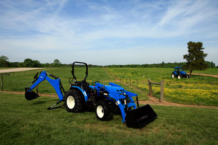

If the curl cyl on your loader is 2 in, and the rod is 1 in . With a hyd pressure of 2500 psi, you should have a push force of 7854 lbs, and a pull force of 5890 lbs on one cyl, and if you have two cyl operating the bucket, you have 15,708 lbs push force, and 11,780 lbs pull force. That is with a straight on push/pull. Angular differences of the cyl to the bucket face other than perpendicular will decrease that force.
Depending on the orientation of you FEL valve, does your levers for the curl cyl's work like this?
Up or fwd motion will cause the bucket to to roll down or dump, and down or reverse on the FEL levers will cause the bucket to curl up?
Does you FEL valve have regen? Otherwise, a forth position.
   / Hydraulic Lines: Fear of Failure #24
After looking at this picture, I see the negative aspect of the bucket and cyl arrangement. Very poor setup in my opinion. The mechanical disadvantage is there from the start.
Specs on that loader show a lift force of 2500 lbs, and a breakout force of 4354 lbs.
So if you had a 1500 lb log on the forks and the center of the log was no more than 15 in from the pin, you should be able to lift that log and curl it anytime.
The specs say the rollback time is 1.7 sec

Since I'm using my homemade bucket forks and I can have the log no closer to the pivot than 33 inches, adding another several inches out to where the center of the log rests on the forks, and with the upper and lower pins being so close together, it adds up to nothing but mechanical disadvantage at every opportunity.
The loader in the picture you posted is not like the one I have. Mine doesn't have those curved booms. It looks like most loaders, until you get to where the bucket release hardware is. I see there are different approaches to that feature by different manufacturers.

All righty then, the dealer mechanic loaned me a gauge and I just checked roll-back pressure. It was right up there near the rated pump pressure: 2400 psi. Granted it was a 10,000 psi (full scale) gauge, but whatever the exact reading, it was close enough for me in any case. I'm at the point of admitting that it is just not going to do what my old Cub Cadet could do in the way of bucket roll-back strength, for the leverage reasons I theorized above.

I'm resigned that the problem is the two ways that the leverage issues differ from my old loader. There is nothing that I can do easily to widen the close spread of the top and bottom pins. As for the distance out from the pin to the base of the forks, that I can reduce from 33 inches to 11 inches, putting the center of a 20 inch log at 21 inches out, instead of 43.
Today, I'm going to get the steel to build my own six foot, on center, fork setup that will bring the base of the forks two thirds closer to the lower pin. This should be better for what I'm doing in every way. The other day, I had to move some logs from where my old tractor easily placed them. I could barely do it, and had to pick them from down slope so they wouldn't roll off the forks, as the curl force couldn't touch them.

On Wednesday I was at the LS dealer and side by side on the lot was a 2010 R4020 (with the same loader as my R4010) and a 2011 R4047, the newer iteration standing next to the older one. One difference I could see in the loader, besides moving the joystick position, was larger bucket cylinders.
I think it's time to contact LS and see if they'll trade me straight across for my smaller ones. Obviously, they've got a notion about this problem now.
