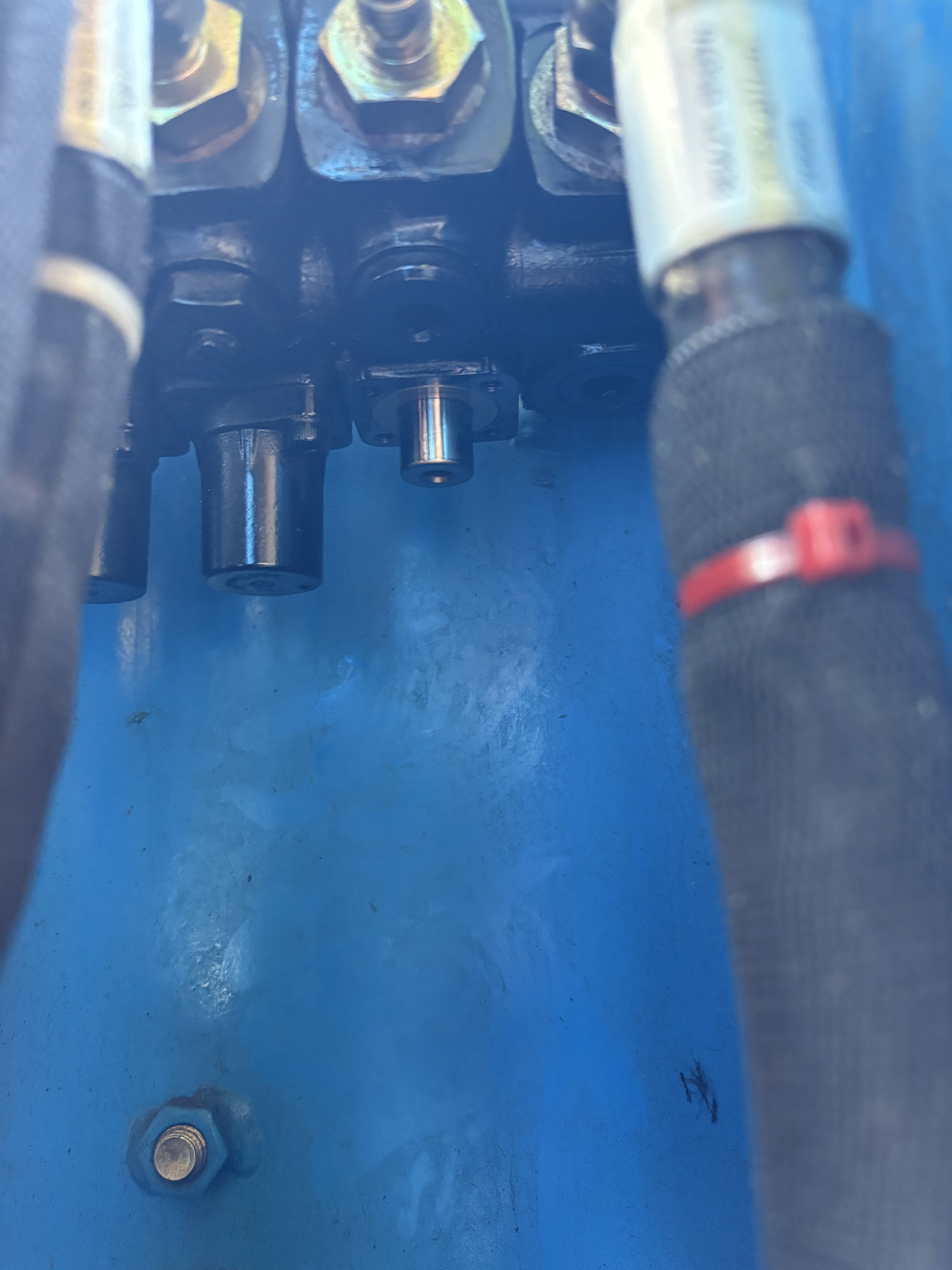

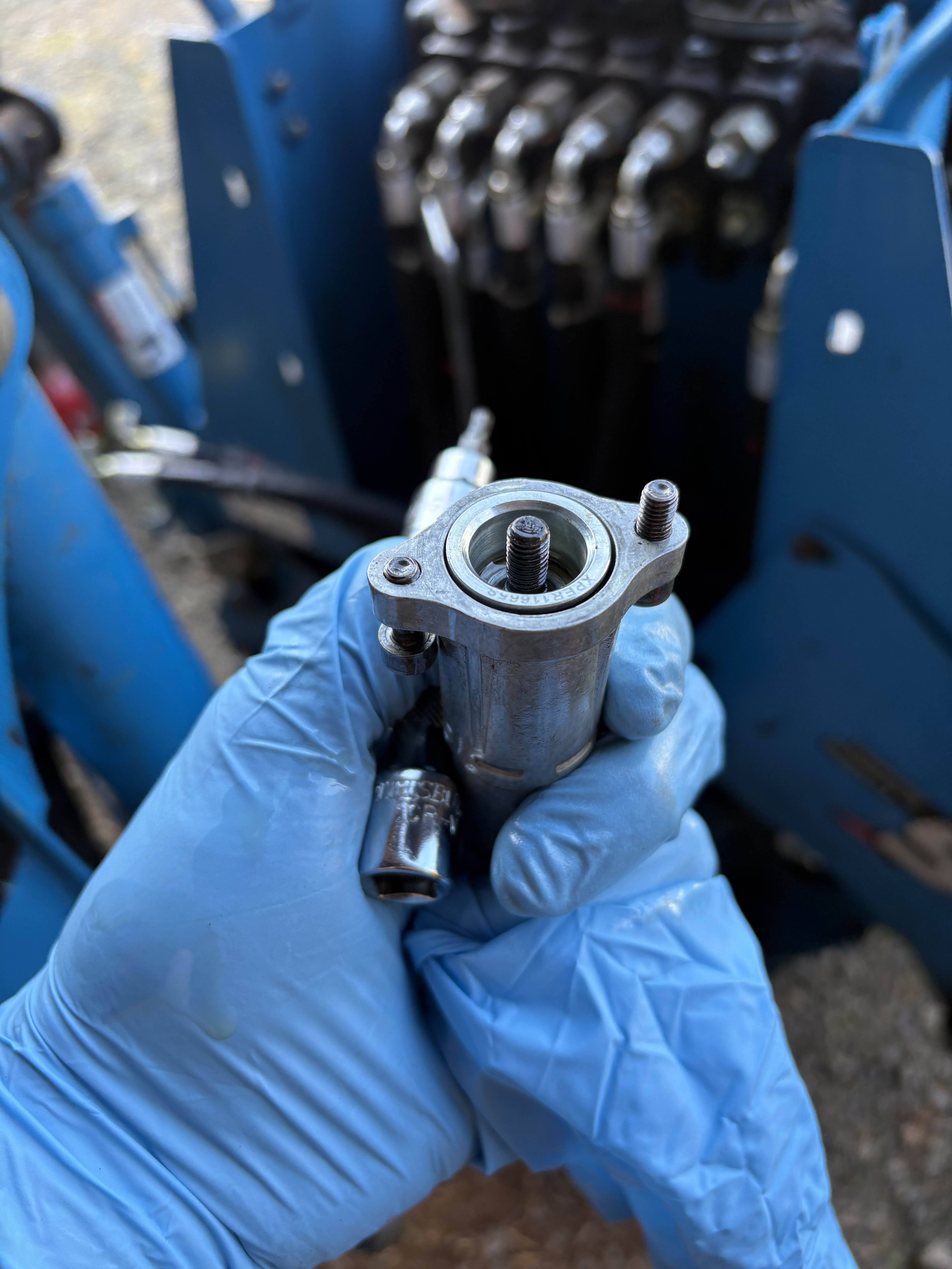

On a whim I decided to unscrew the cap on this and wasn’t expecting the over pressure valve to be a part of the cap. Is this right? It rattles a bit in there, but I haven’t pulled too hard to get it out for fear that it’s supposed to be held on like this.

Fixed. That valve had come unscrewed over time and was the issue. I was able to gently pop it out of the valve cover and screw it snugly into place with a bit of blue lock tight. Put the cover back on and it works better, smoother than since I’ve owned it. Which isn’t long.
Thanks again for the help in understanding these things and the ideas to try!
