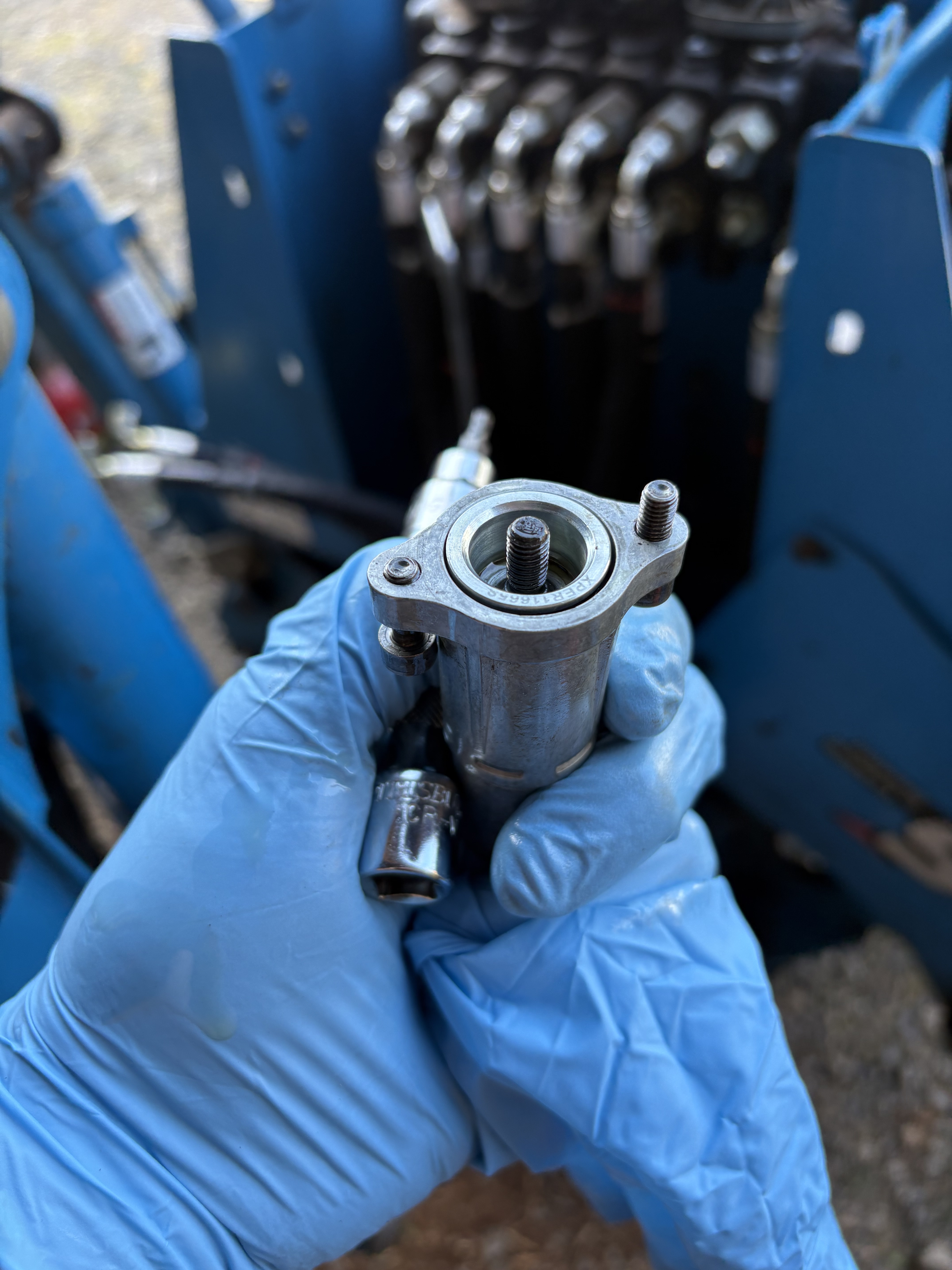

On a whim I decided to unscrew the cap on this and wasn’t expecting the over pressure valve to be a part of the cap. Is this right? It rattles a bit in there, but I haven’t pulled too hard to get it out for fear that it’s supposed to be held on like this.
/ Backhoe boom power loss
#28
Fixed. That valve had come unscrewed over time and was the issue. I was able to gently pop it out of the valve cover and screw it snugly into place with a bit of blue lock tight. Put the cover back on and it works better, smoother than since I’ve owned it. Which isn’t long.
