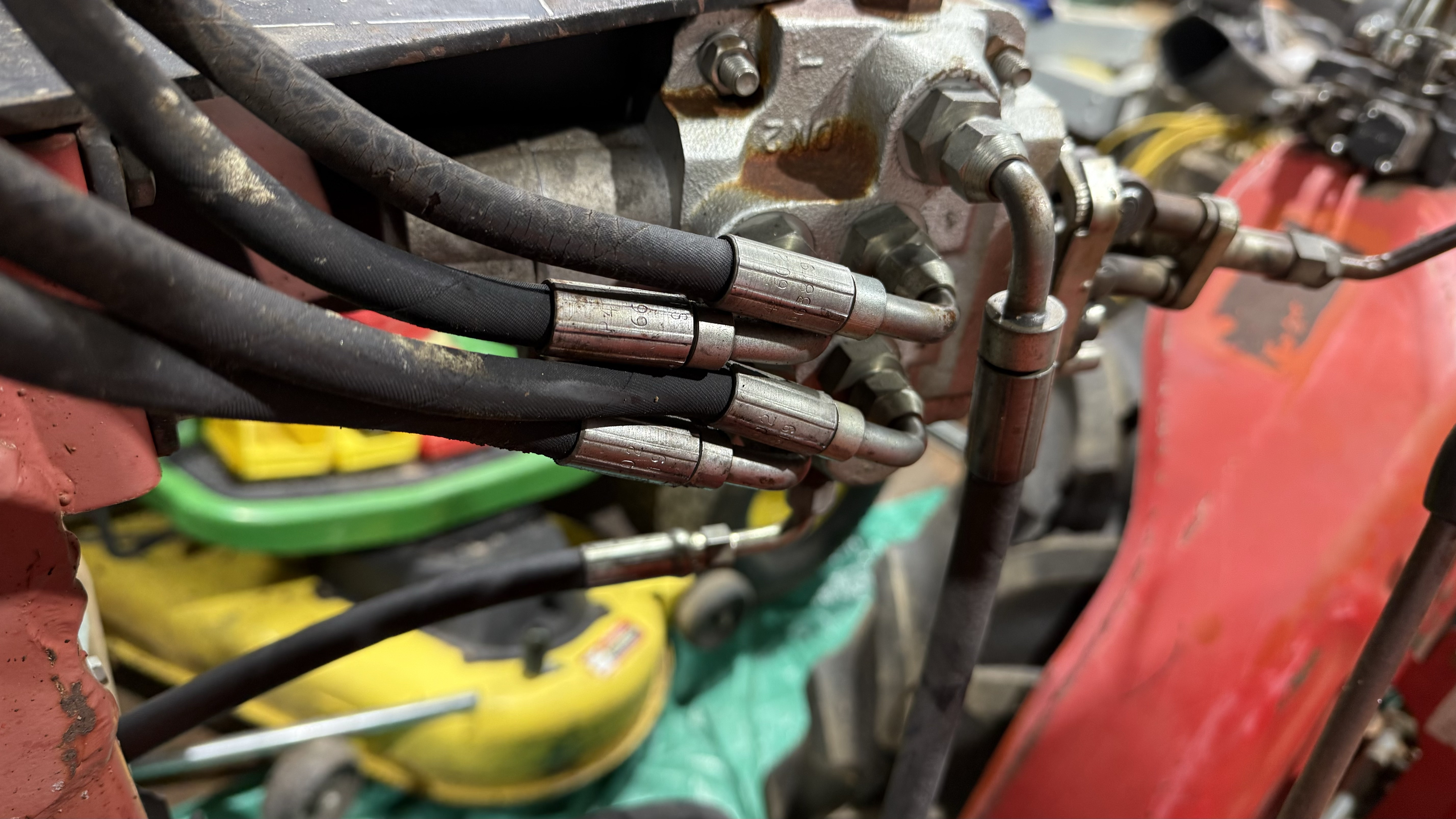

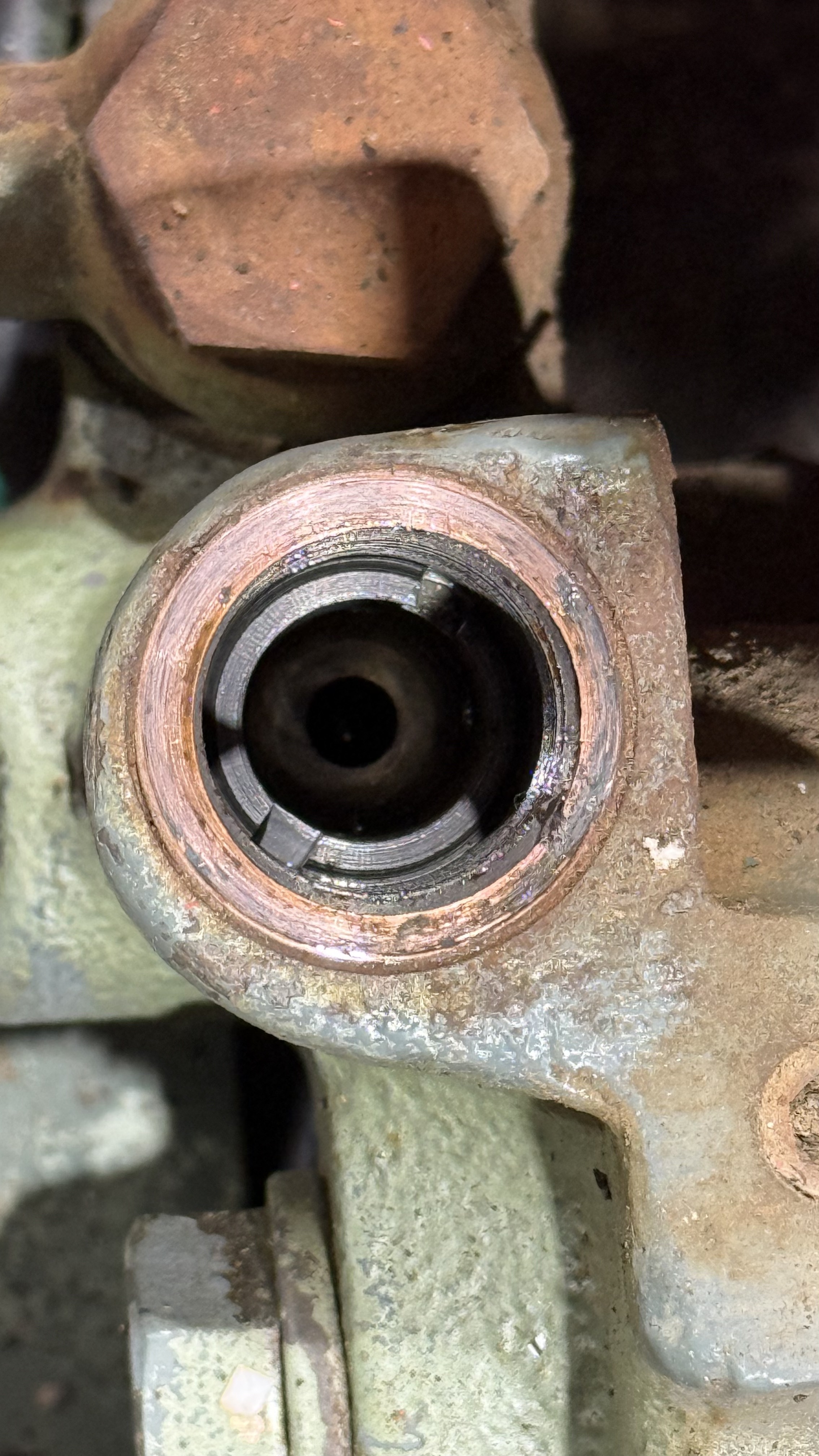

Okay, here is more info.
Still have jerky minimal control for a few moments after start up.
What I've taken apart/seen.
Intake Screen - cleaned
Pump seems to be able to build pressure, cant seem to sustain it.

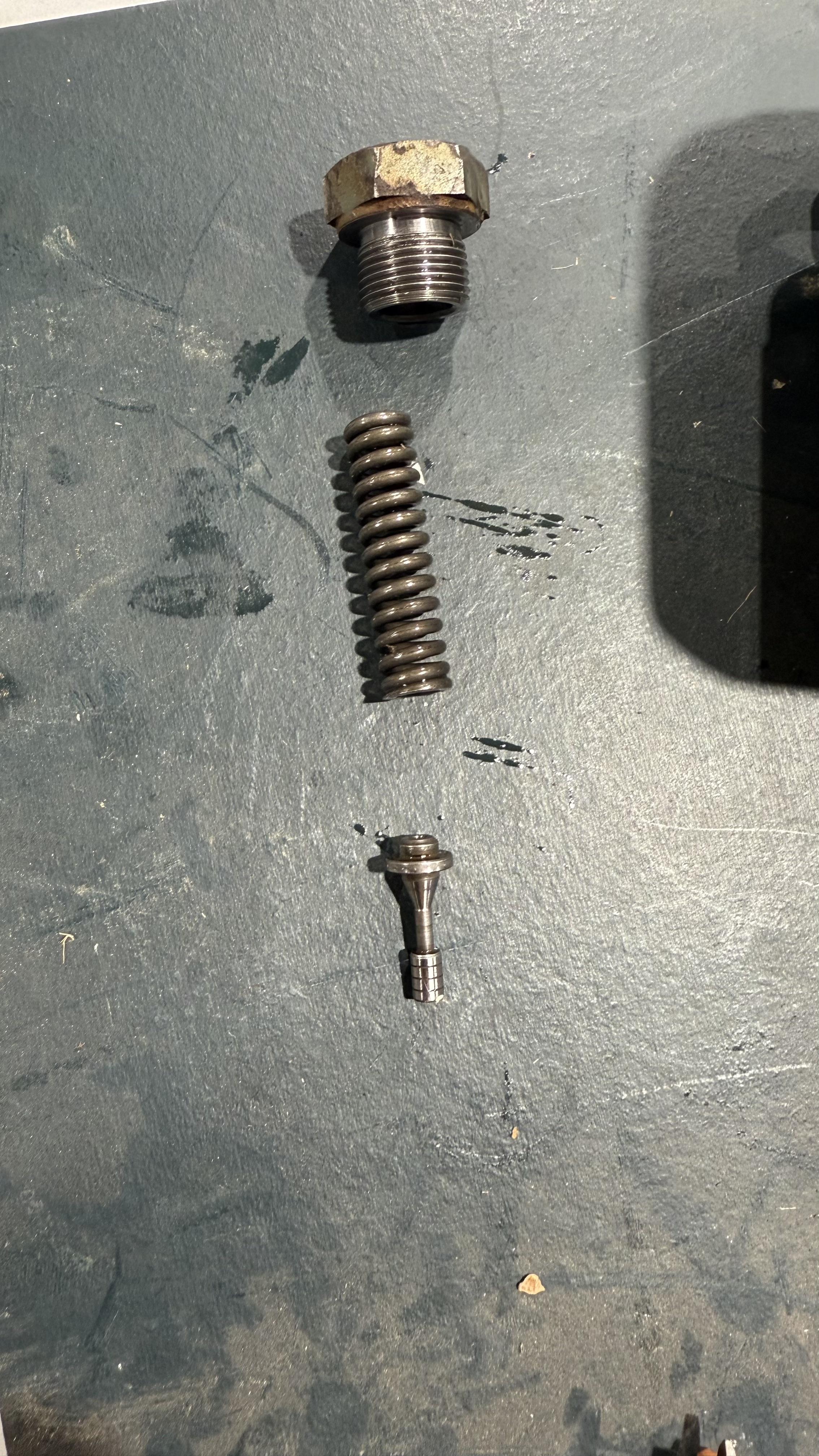

Took apart the relief valve to the parts shown- Spring and valve pin. Valve pin had slightly burred edge. used ceramic edge to smooth.
Replaced all. Can get oil to flow from top of pressure relieve. Tighten back down and bucket performs the same jerky movements.
That one with the O-Ring seems to be where I'm headed next. Though I'm not sure?

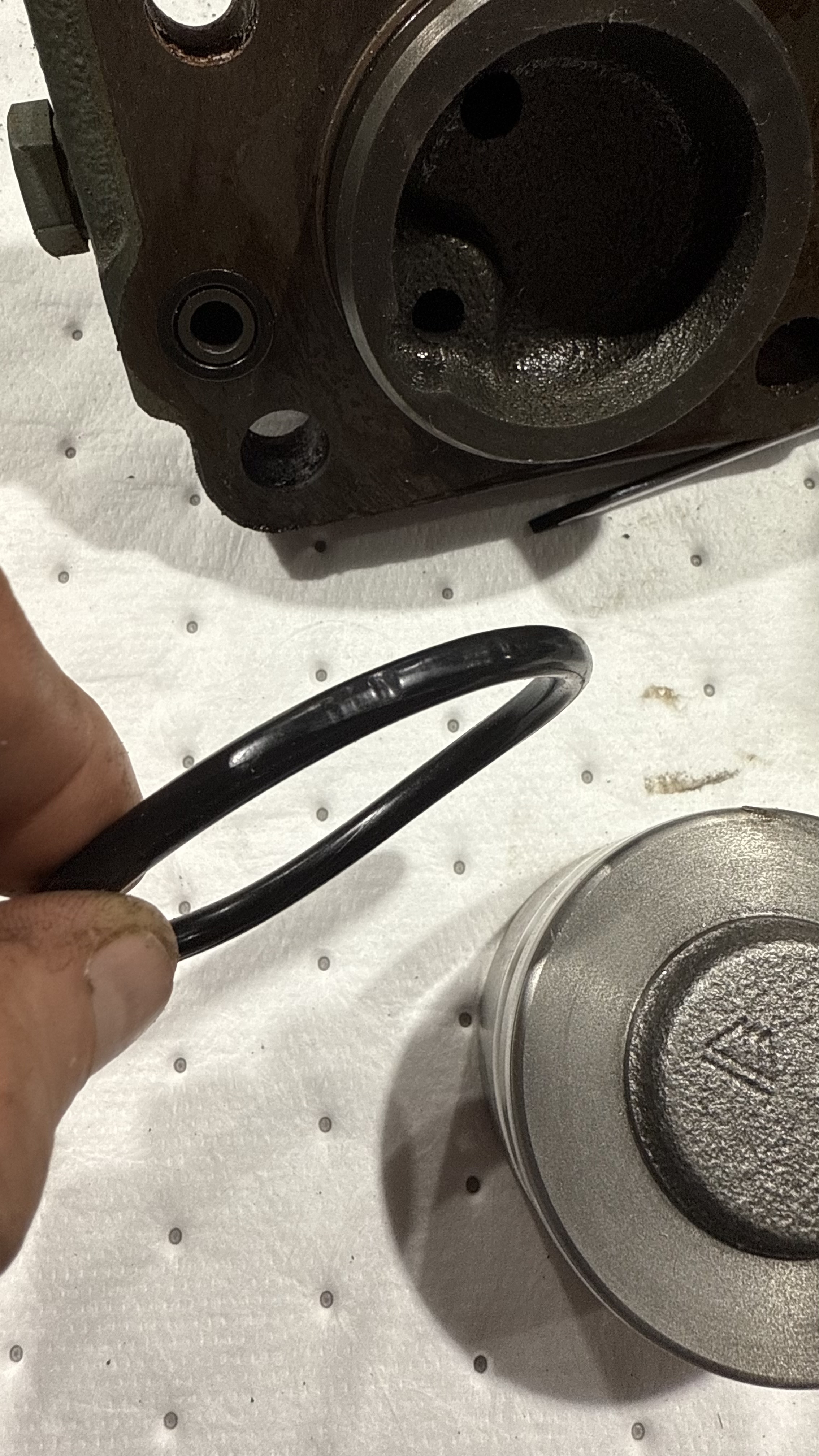

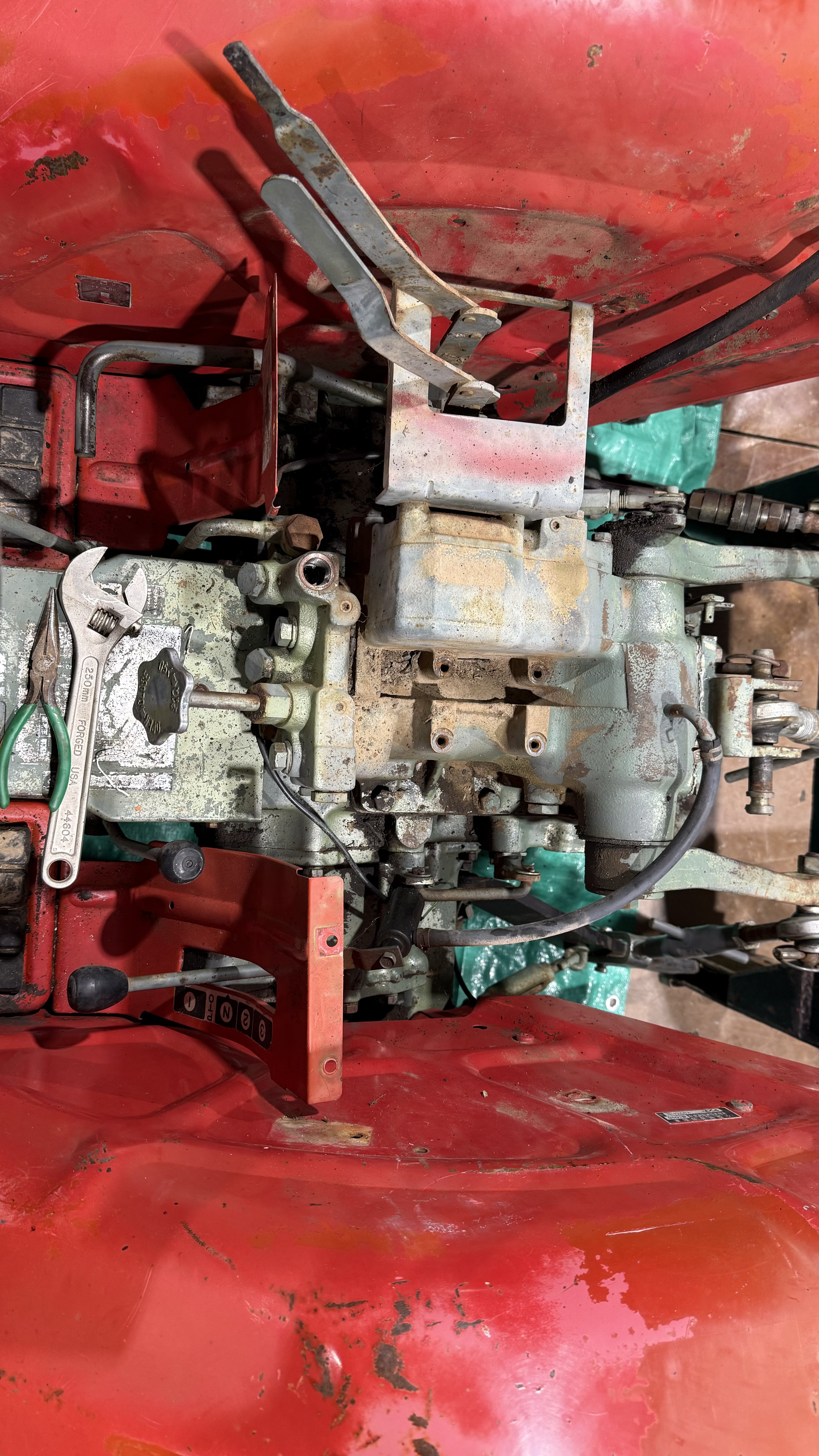

I was able to remove the bucket controls from the line. So it’s just the screen, filter, Pump QuickConnect, then back into Hydraulic control valve.
3Pt was still wacky.
Pressure gauge shows not even 500PSI when put inline.
Pressure gauge pegged passed 3000 when I cranked the engine (no gas).

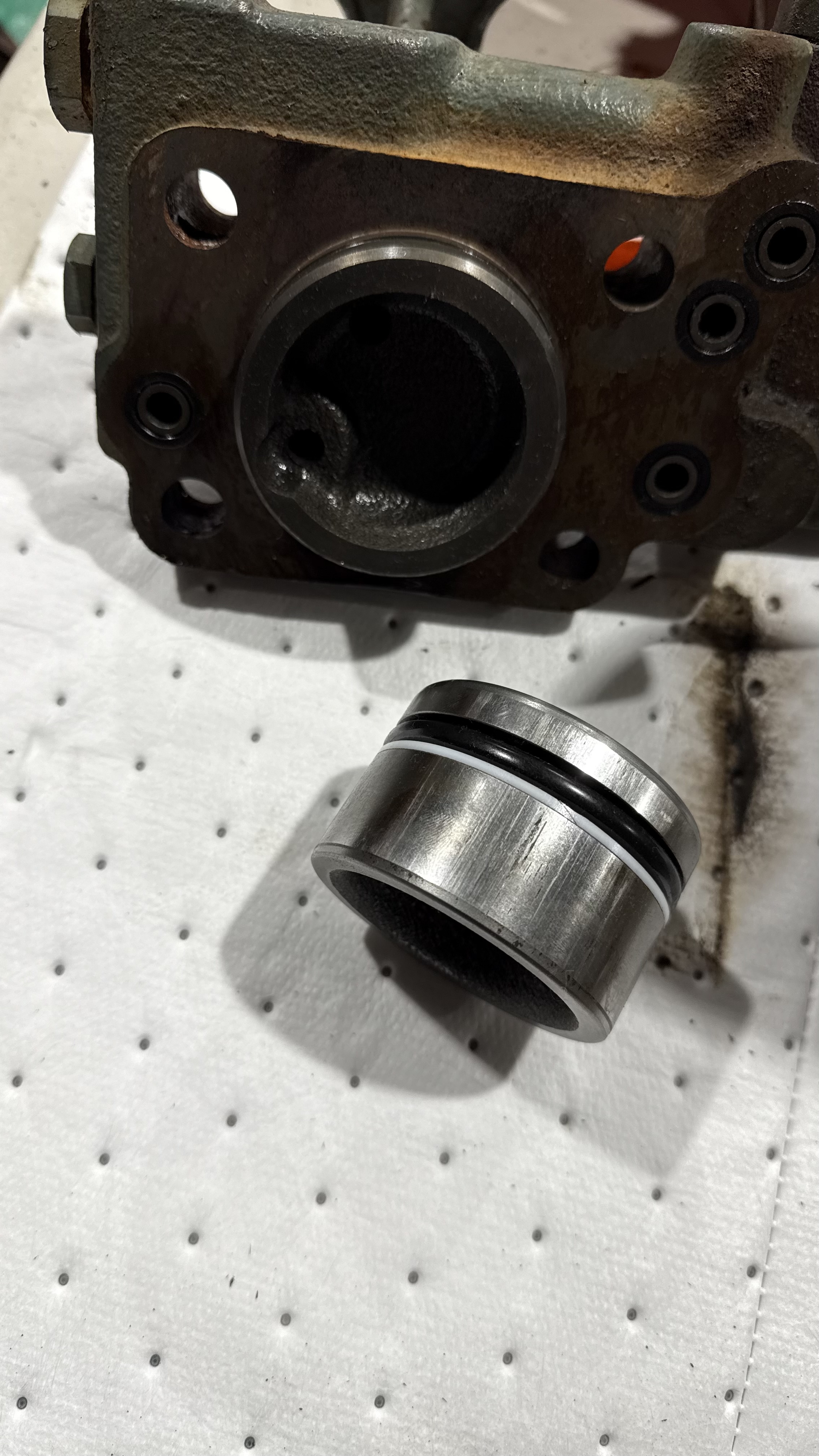

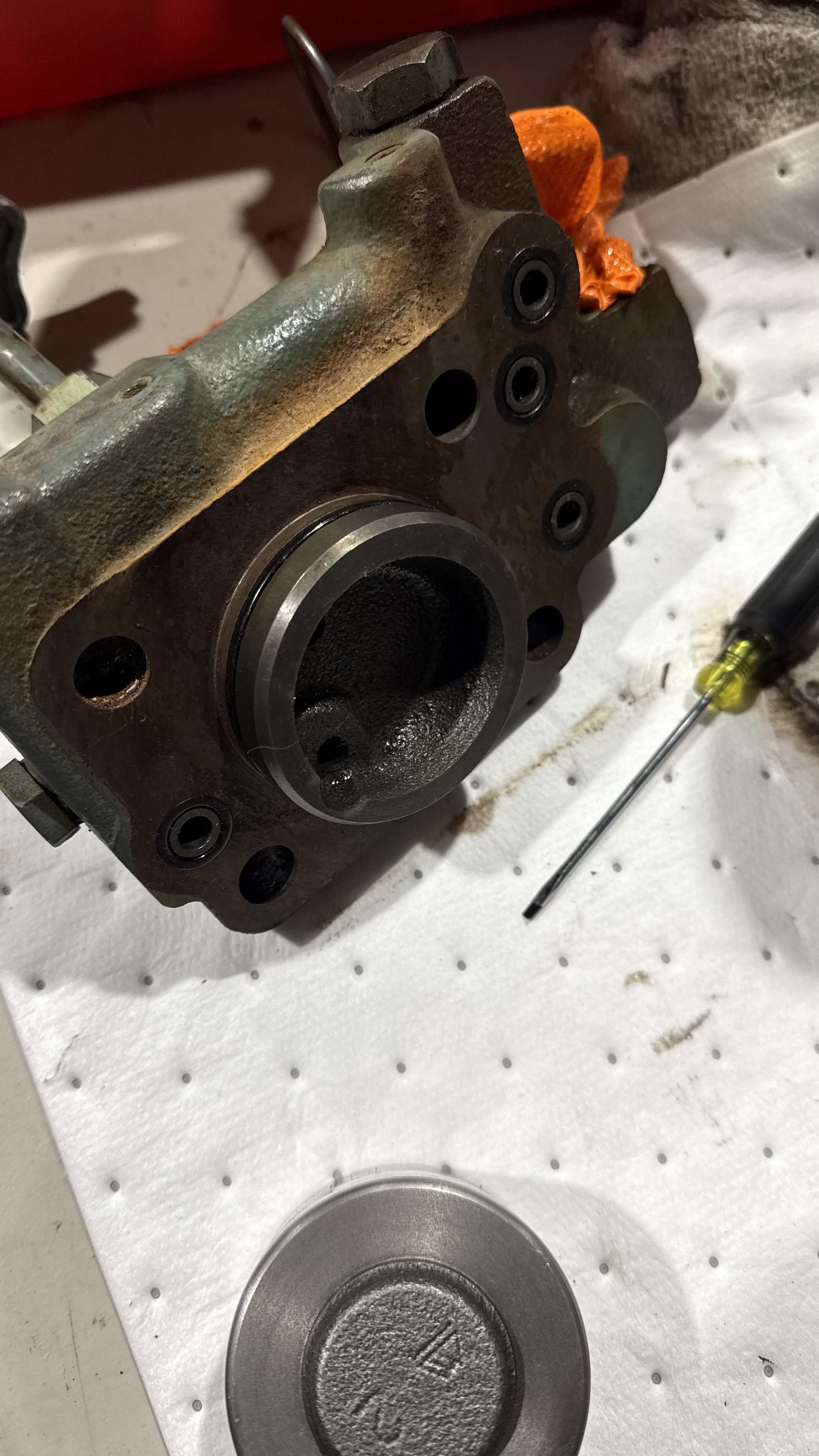

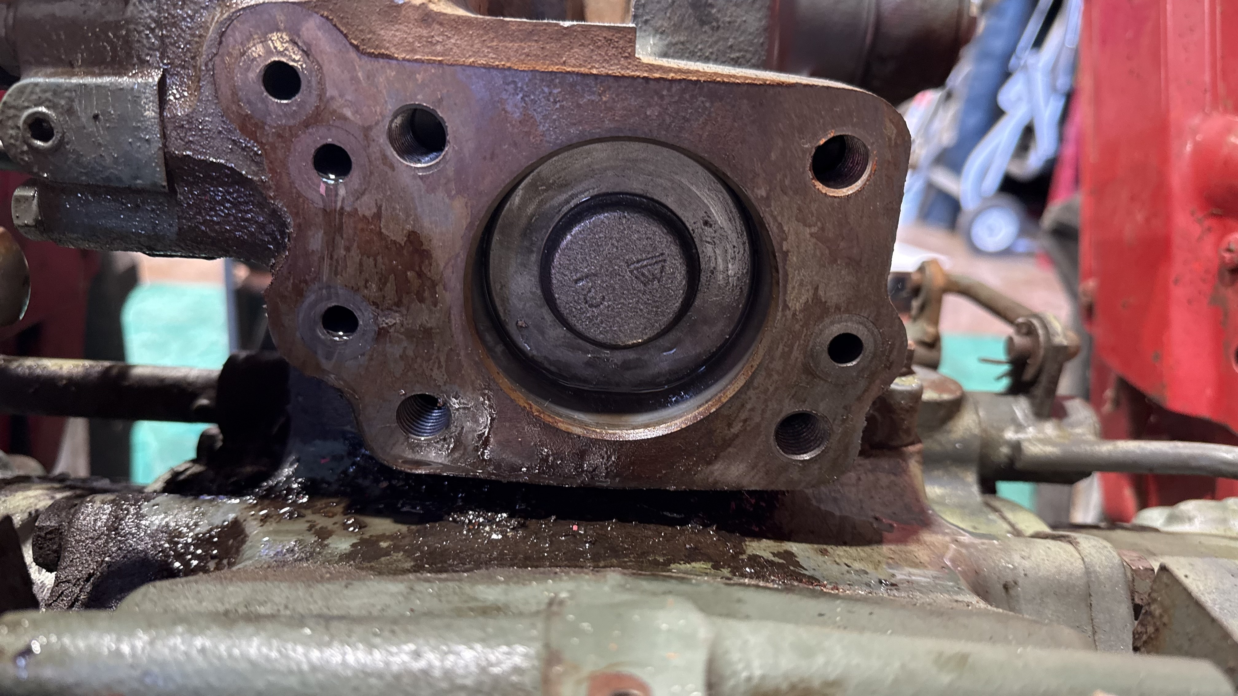

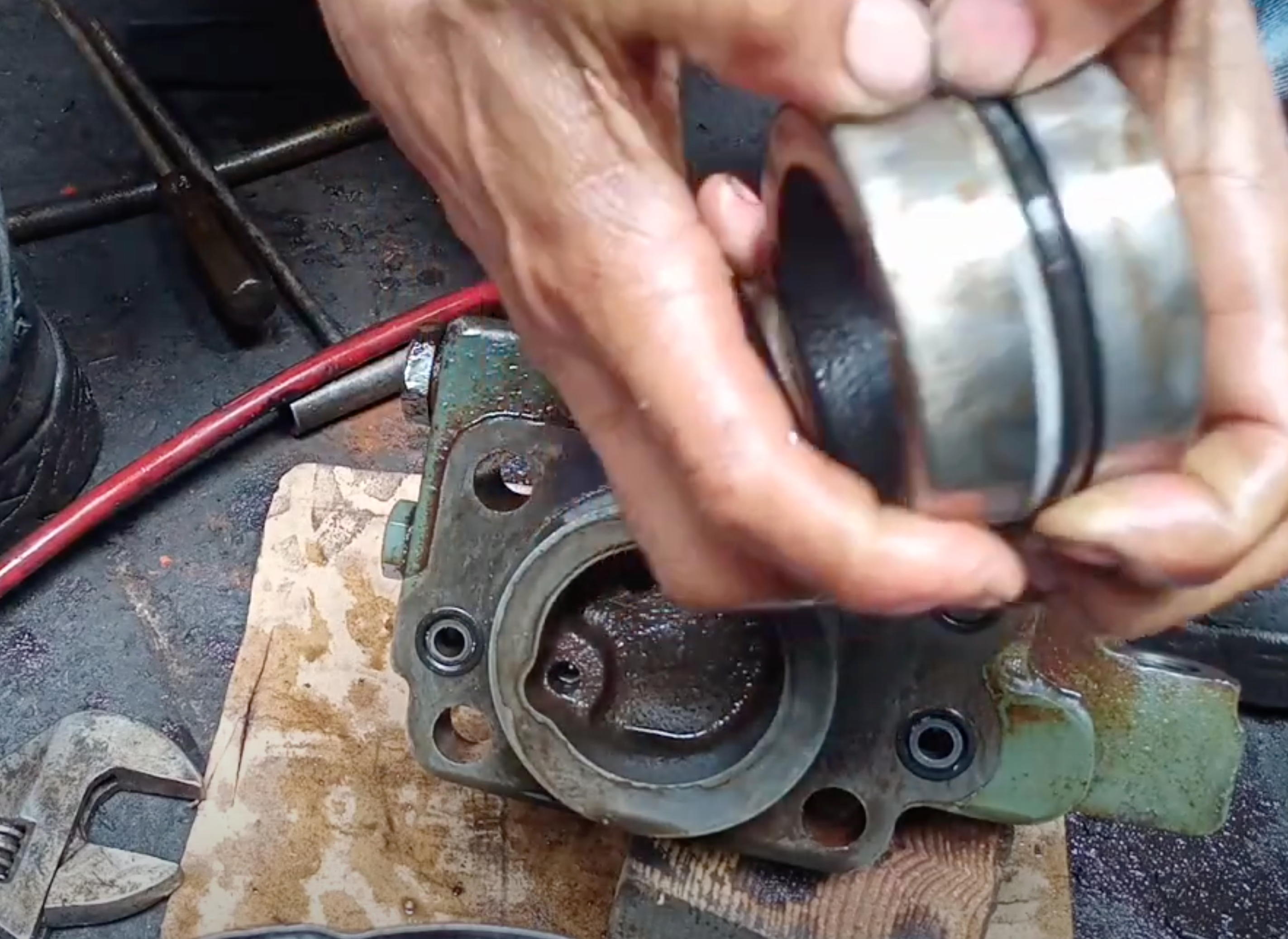

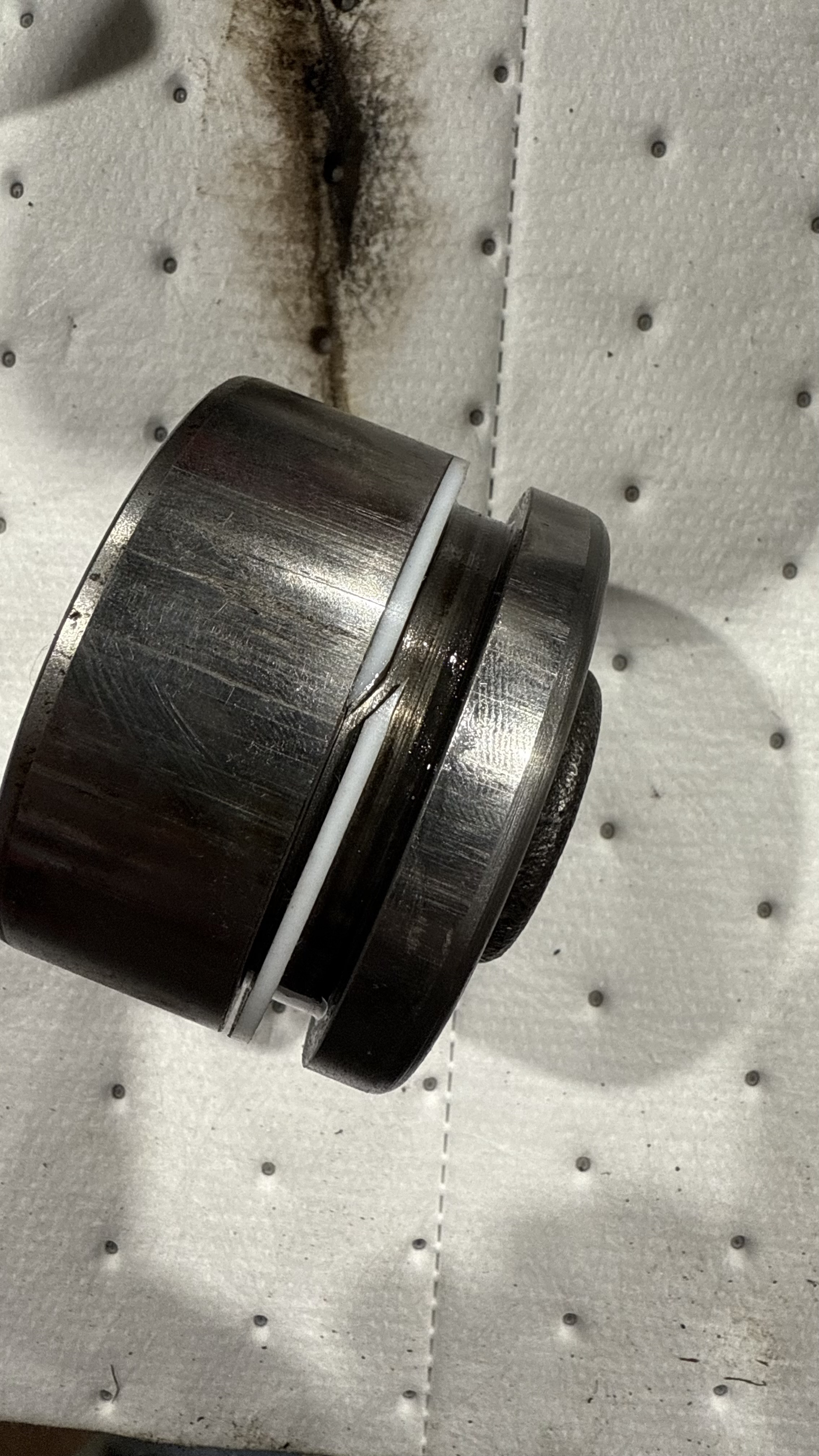

Took apart the Hydraulic controller. The O-Ring on the cylinder in there has some rough spots. Looking for the replacement O-Ring.
Took quite a bit to get the Cylinder out of there. Most of the videos I watched it just slides out. I need to Add compressed Air to push it out. I was stuck or so it seemed?

I’ll Check out the lines out, though I am getting flow to the Hydraulic valve Controller, It gushed out of the input there when I loosened the connectors.
Yes, that o-ring looks bad to me, both in this photo and the slightly out of focus one before. However, I would look inside to see if there is rust or scars or scratches that could have caused the nicks/wear in the o-ring. It would be great to find the cause of the wear on the o-ring. If you don't, I think that you run the risk of this repeating itself.
I would not rule out the thought that part of your issues is water in the hydraulic oil, causing a clogged suction screen.
The nicked o-ring might explain the "glitches", but it probably doesn't entirely explain the low pressure.
Good luck!

Not understanding the 3000psi when cranking the engine. You are not going to have much pressure unless your lift is requiring it. (big load). On the 20002 you can slowly close down on the stop valve and watch your pressure gauge. The 2002d has a relief valve built in the 3 point control and it will or should relieve a little over 2200psi. I wouldn't necessarily recommending making it relieve, just close the valve enough to watch the pressure rise. If it doesn't rise then there is something rotten in Denmark.
