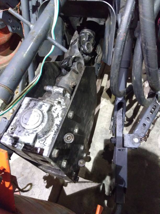

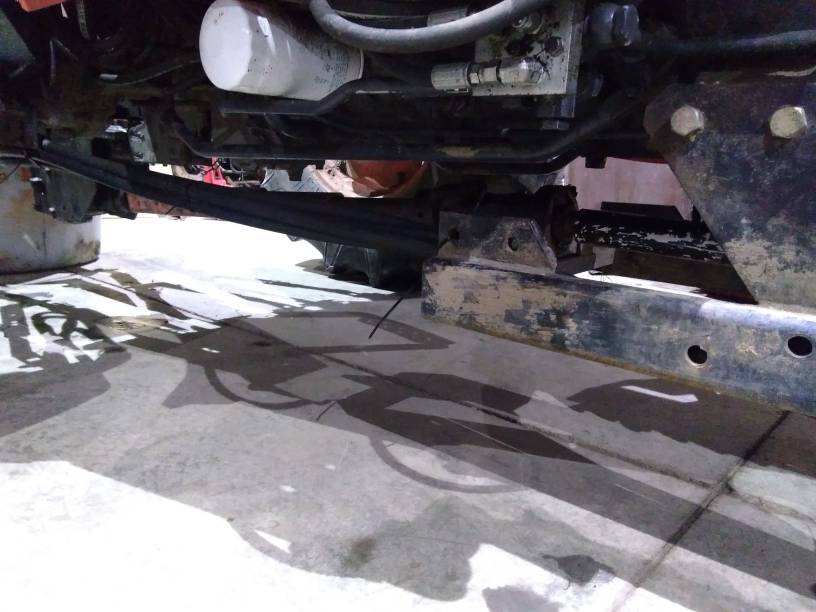

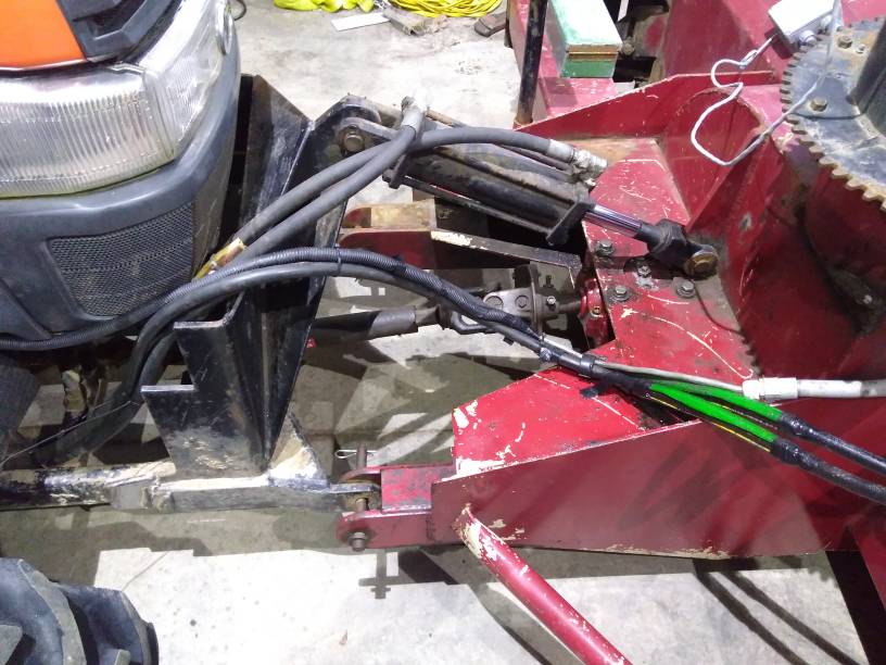

Here is the setup we have on our L3830 with a 7' Loftness front snowblower.
Rear gearbox:
First rear to front PTO section:
Second rear to front PTO section and mounting frame:
Front frame and snowblower:
It was originally on a larger NH, but I adapted it to our L3830 and it works well, have to go slow in heavy stuff though.

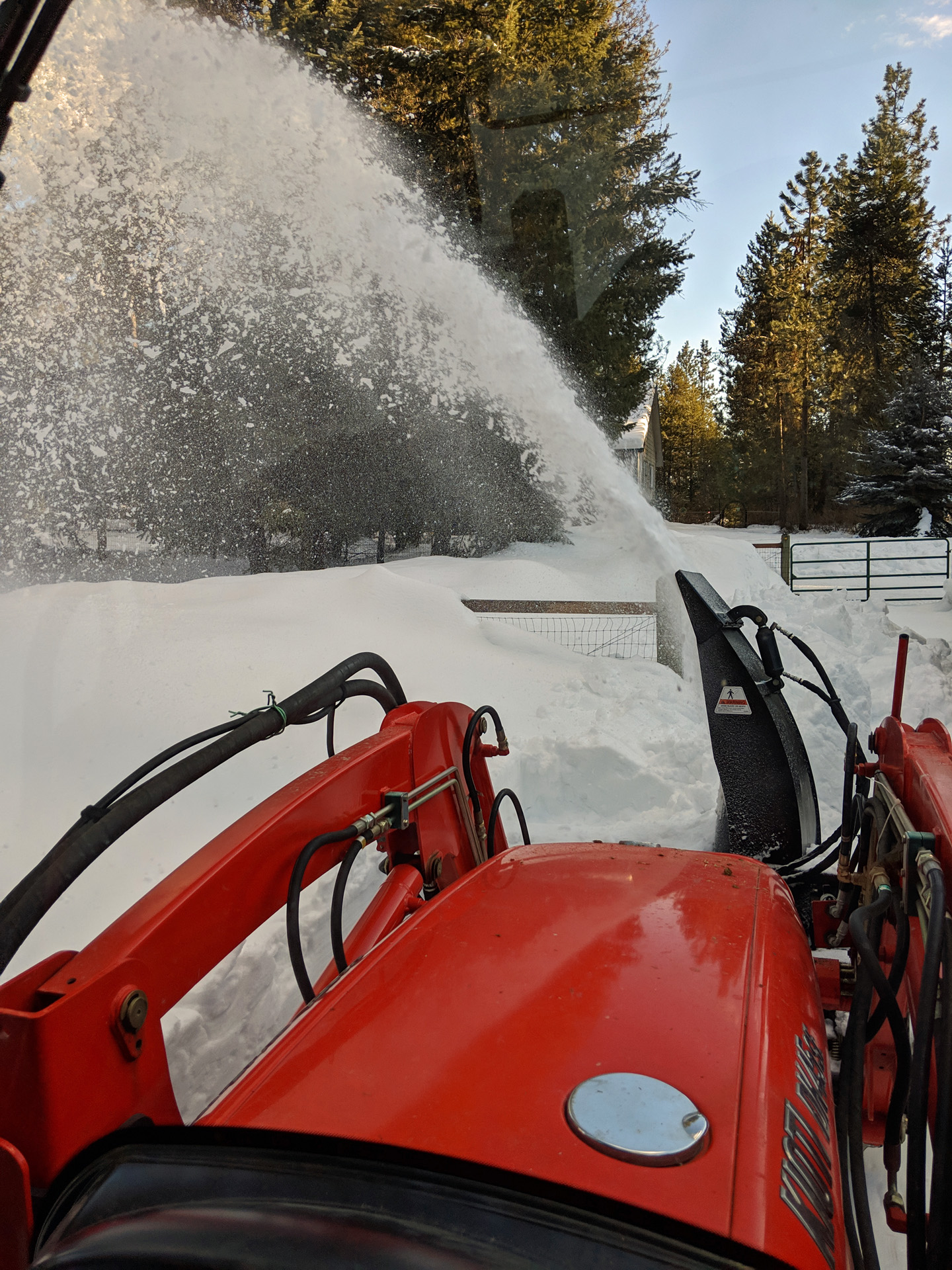

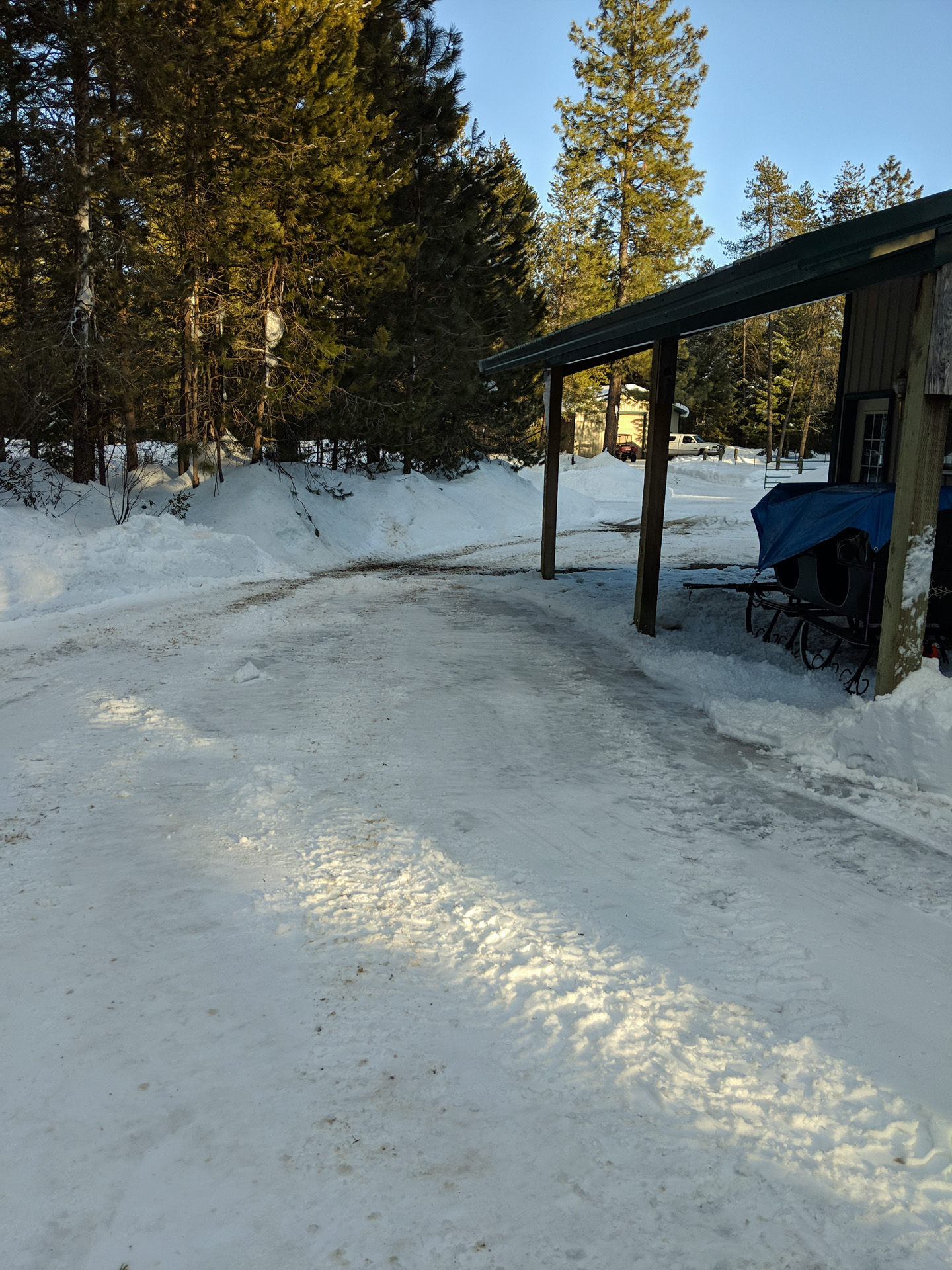

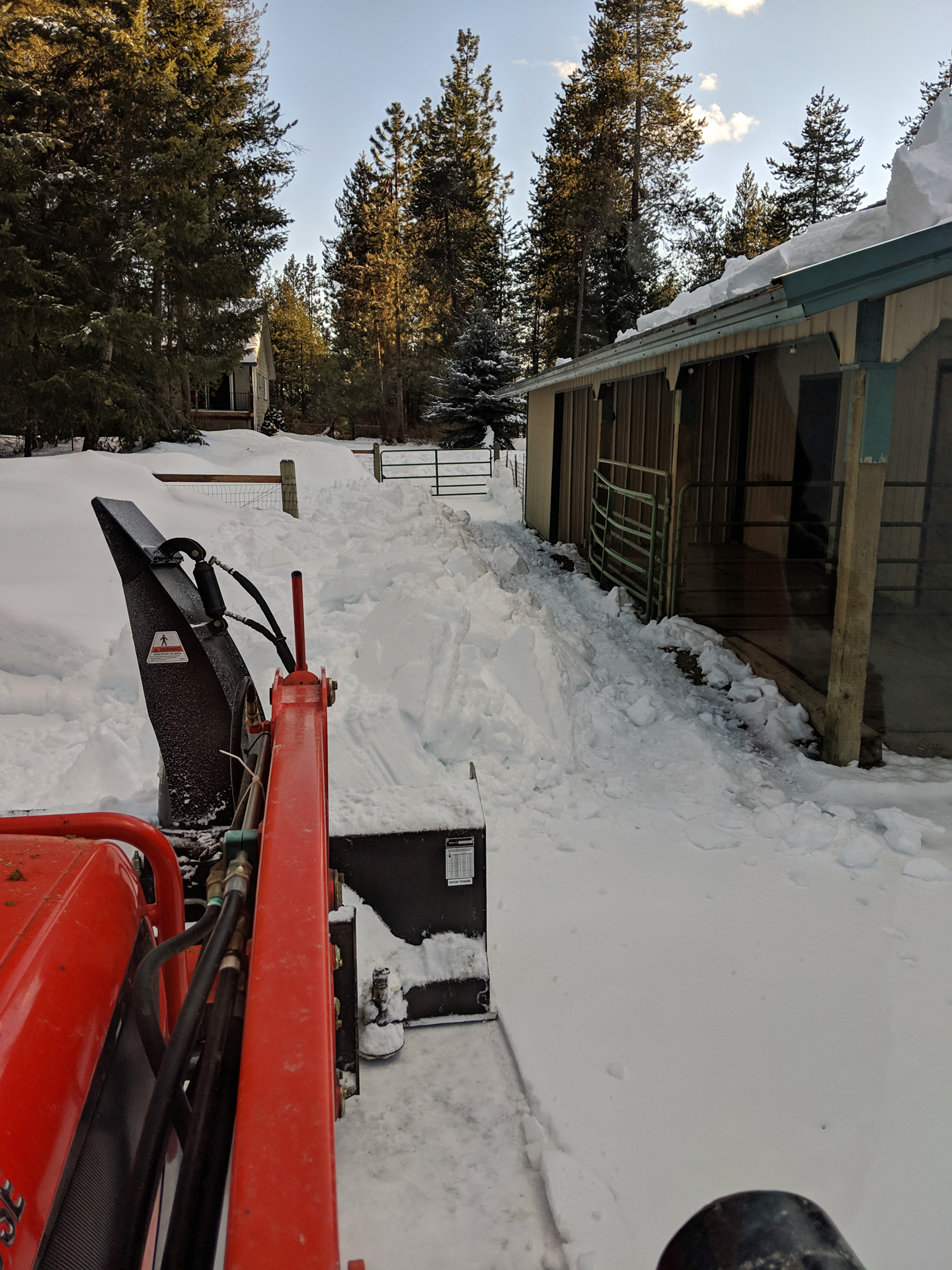

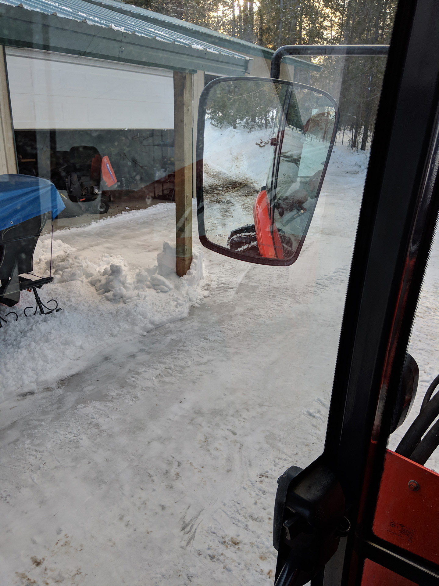

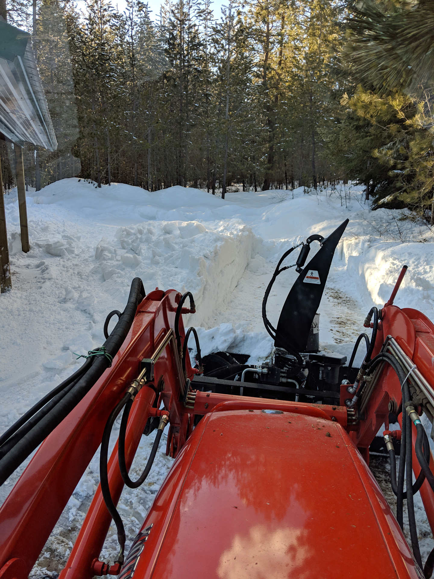

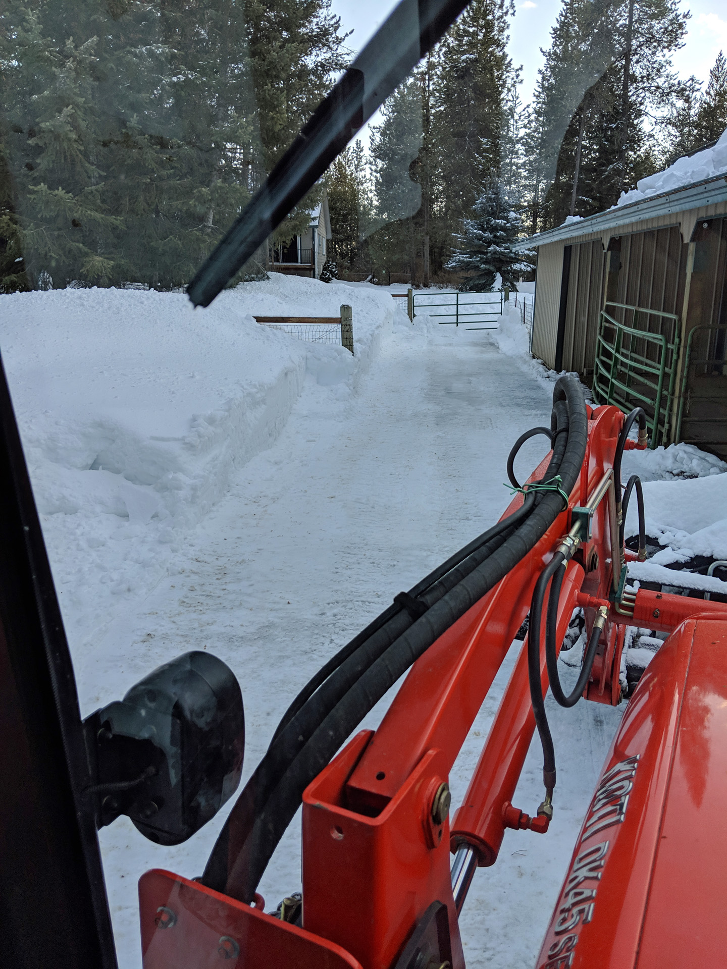

This is one of the reasons i needed a loader mounted unit. when my buildings shed, i have a real mess. The horses need to get out and i need to get into my shop. When the roofs shed in bad snow years it could be 6' high. Not as bad this year, but the packs are about 3-4' tall.
IMG_20190309_155904.jpg IMG_20190309_155957.jpg I had to cut off top layer first. IMG_20190309_160227.jpg heres it all cleaned up. IMG_20190309_162053.jpg IMG_20190309_162151.jpg
The barn wasnt fully shed off, but its 10F outside and i wanted to get rid of whats on the ground for the horses. IMG_20190309_162358.jpg Going going IMG_20190309_162549.jpg goneIMG_20190309_163554.jpg
The shop took 19 minutes start to finish. The barn took 11 . Back in 2008 when the barn shed, it took me 4 hours to clear it with my old 3 point blower and JD870 tractor. Mind you there was more snow. Back then i had to keep turning around to knock down piles with loader then turn and blow. P2071221.JPG P2071222.JPG P2071223.JPG P1201121.JPG
