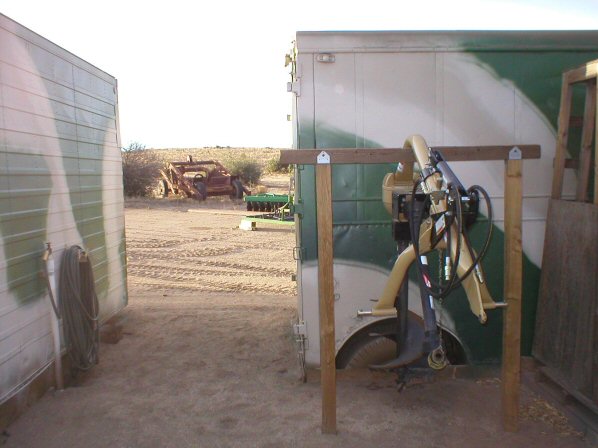

Last year I purchased a new Bush Hog 3pt PHD with hydraulics for my Kubotta M 4700 tractor.
I recently put the PHD together and it is working great but have not figured out how to install the hydraulics. The hydraulic kit came with one large hydraulic line and one smaller hydraulic line. Also, there is a hydraulic plug they gave me but I am not sure what that is far.
Do I not need two large hydraulic lines, one in and one out for pressure lines ? Hope that made sense. :confused:
Does any one have pictures of their hydraulics installed on a similar setup of a 3 pt. PHD they could post ?

My PHD is a Bush Hog 2102 that attaches to my 3PT and is PTO driven.
I have the optional down force kit for the PHD that works off the hydraulic system outlets at the rear of my tractor. The down force kit came in pieces with several hydraulic hoses. The generic instructions that came with the kit and what I can find from Bush Hog website are not clear to me.
I have emailed Bush Hog for answers, with no replys so far. My local dealer has not installed the kit, but they said their parent company branch dealership in the next town will help me. Of course getting all this done with my tractor parked 95 miles away at my farm is another "work in progress". I will get there though with good ole Tractor net.

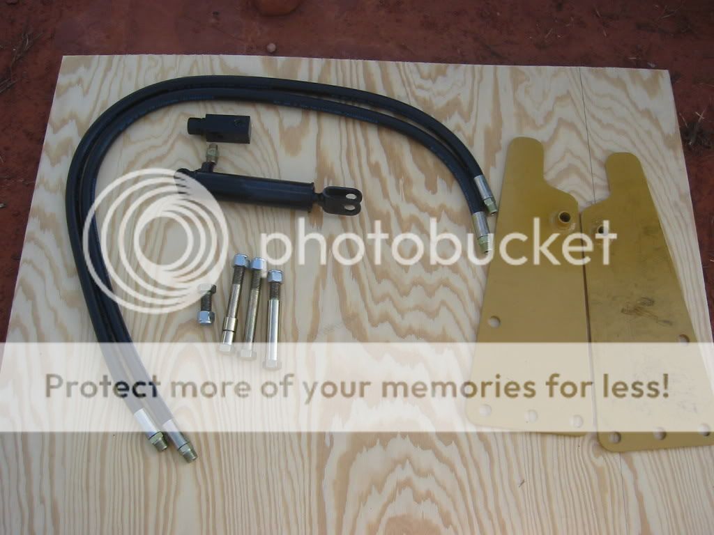

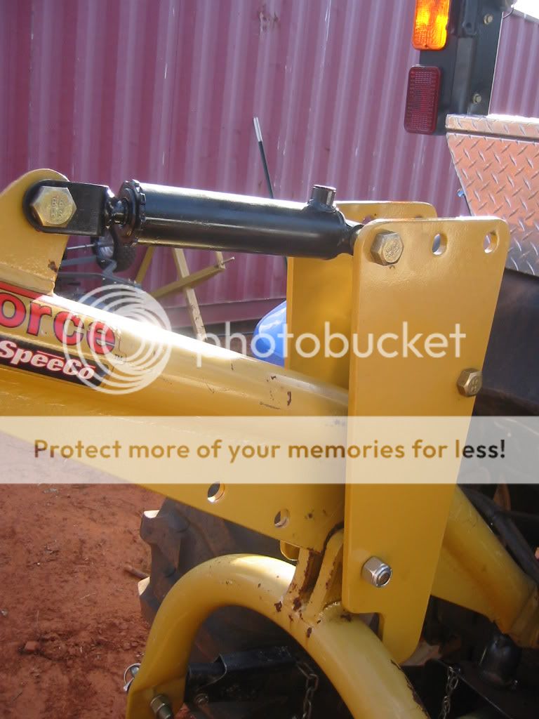

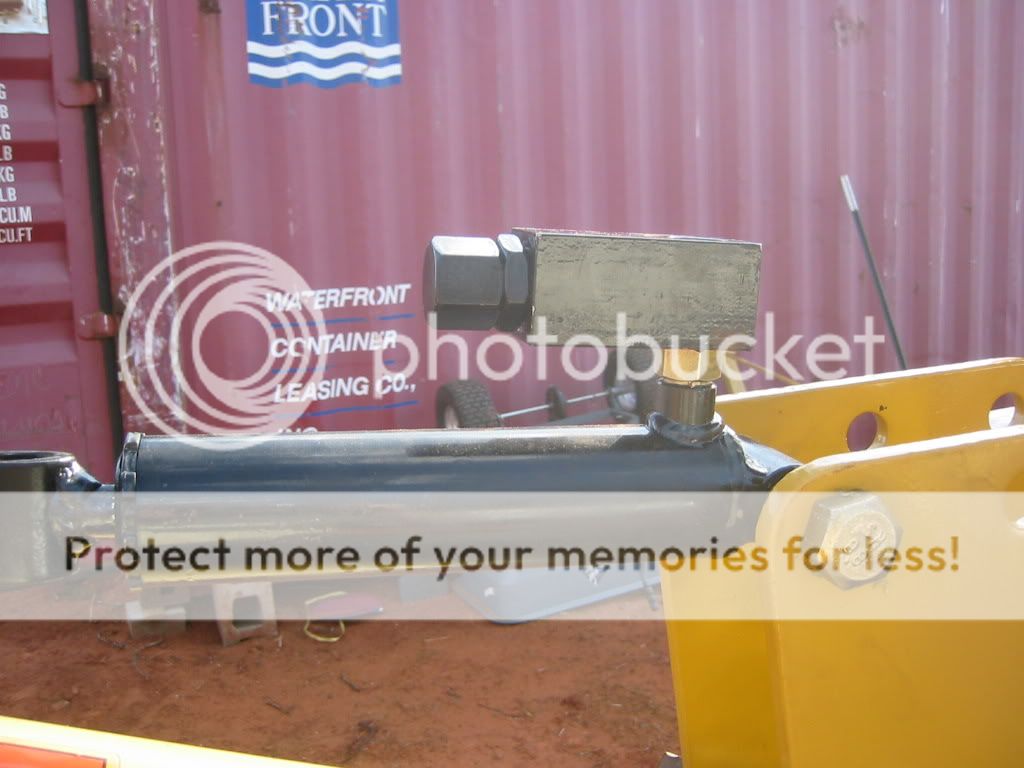

G McCall: Here's the pics as promised. The whole job took less than 45 min to put together.
On the NH TC45DA this is where the return line plumbs into the tractor:
A pic of the kit:
Plates and cylinder installed:
Relief valve installed on the cylinder:
Hoses intalled on relief valve (I added the 90 deg fittings as I didn't like the hoses sticking straigh up and out) Top hose is pressure, side is return:
Hoses pluged into tractor, top is pressure, bottom is return:
Hope this helps you out
