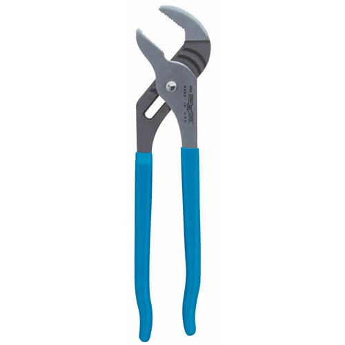

I just removed all the spin-on filters on my Yanmar with a large pair of channel lock pliers, maybe the same would work for you.
