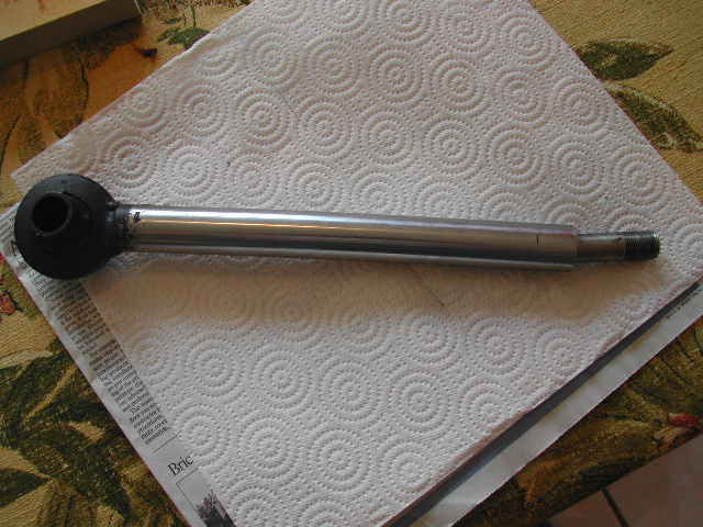

I ordered a replacement hydraulic cylinder today from PT for $120. Also ordered 4 seal kits for the other cylinders at $12 each.
While I take JJ's point about not fixing stuff until it is broken, I'm thinking that rebuilding the cylinders comes under the header 'preventive maintenence' since this is an old machine. Last thing I'd want happening is another cylinder jamming, especially as all the other hydraulic actions have two cylinders controlling them. If one cylinder jams and the other is still actuating, I might get stuff bending that I don't want bending! Refurbishing this machine may end up being a winter project.

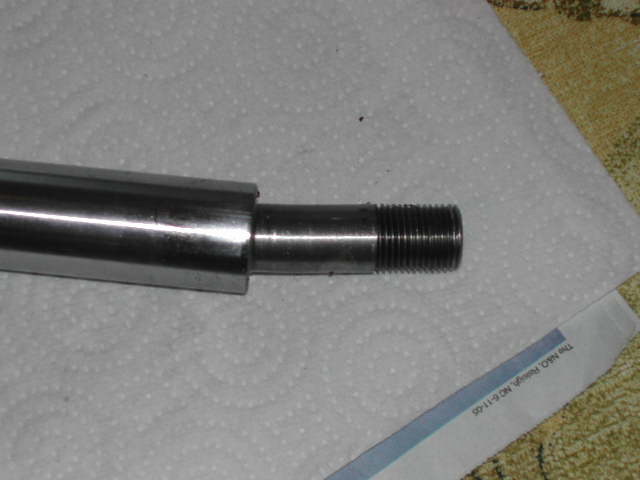

Well I received the new hydraulic cylinder today, along with the rebuild kits from PT. The rebuild kits are basically seal kits with replacement seals for the cylinders. It turns out that all of the cylinders have the same seal kit (at least on my PT 1418.) So, I have some rainy day projects rebuilding the other cylinders. After that I'll probably start going through the rest of the mechanicals to make sure that they're solid.
Question regarding connecting up a new or rebuilt cylinder: What do you do about air in the lines or in the cylinder for that matter? Do the gear pumps and cylinders push out the air naturally into the resevoir as you work them or is there a recommended procedure for bleeding them?

Good deal, Ben. I don't know how you'd check the rest of the cylinders for a loose piston nut short of taking them all apart and visually examining the rod and piston (and at that point, you might as well install the new seals).
You don't have to bleed any of the cylinders or anything else on the pressure side of the pumps...they will push the air out of the lines and into the reservoir. Just install the hoses and work the tilt operation on the joystick a few times...they'll fill right up. The only thing you ever have to bleed is the suction side of the tram pump (the side coming from the bottom of the reservoir and through the filter). You would normally have to bleed the gear pumps I think, but to my understanding the tram pump supplies charge pressure to the tandem gear pumps, so air gets pushed through them quickly without doing any damage.

I am thinking is your case, the nut somehow worked itself loose and caused that problem. I have known this to have happen before, on other hyd cyl , but yours is the first for the PT that I know of.
