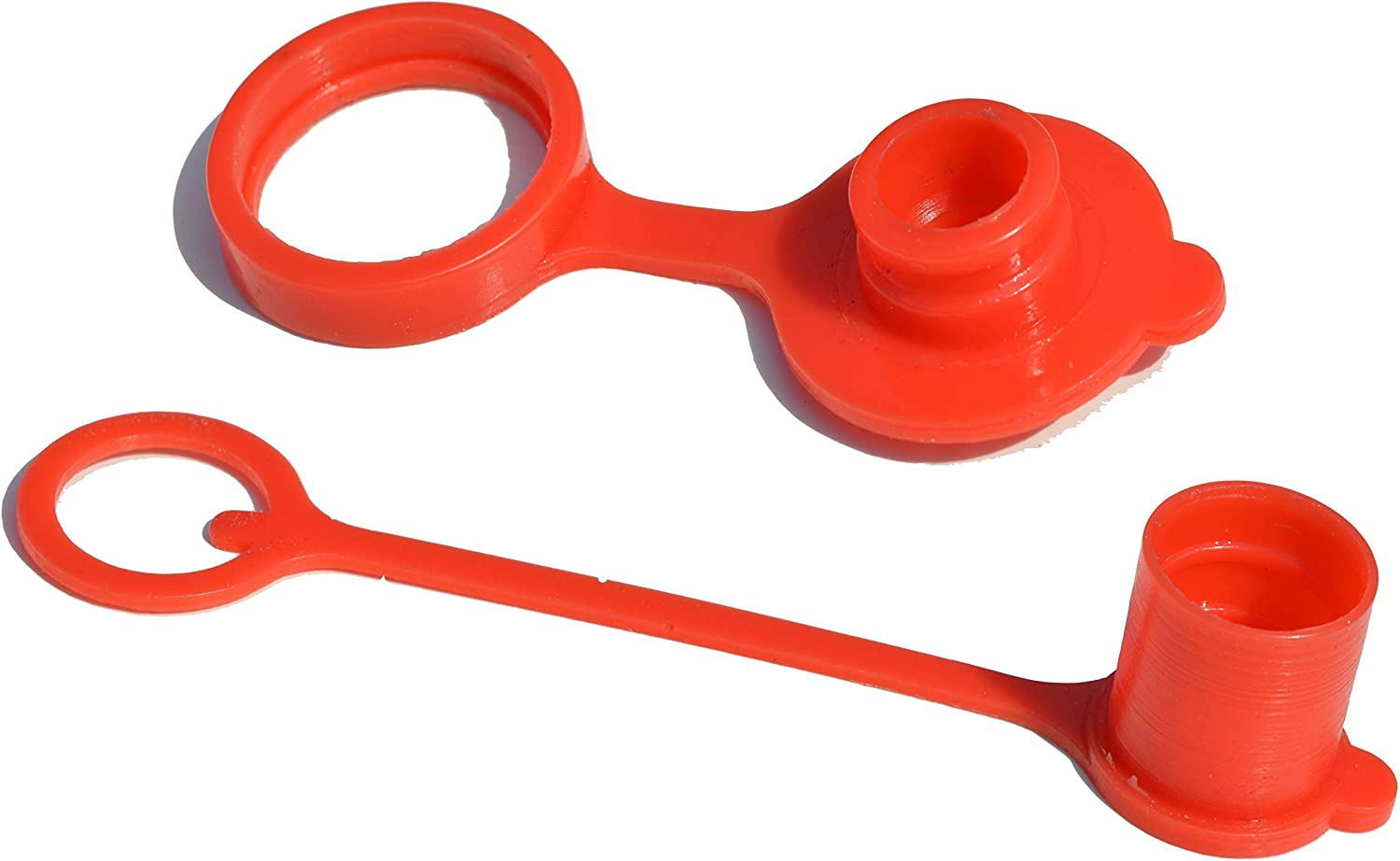

If you do this, the connectors can become pressure bound due to temperature changes. loosening the fitting is then the only way to get them apart.
The best approach is to leave the male ends unconnected and cover with the rubber boots mentioned above. Bleed off any pressure build up by tapping the ball end on a block of wood.
You can also make a tee with female AG's on each end and a relief valve in the center. Plug the Male AG's into the ends and bleed off the pressure to remove. This gets expensive though if you have many hydraulic implements.
