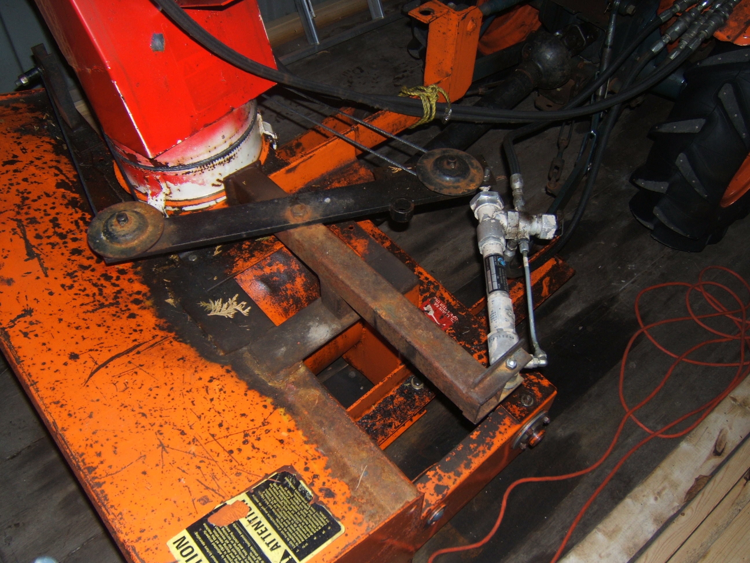

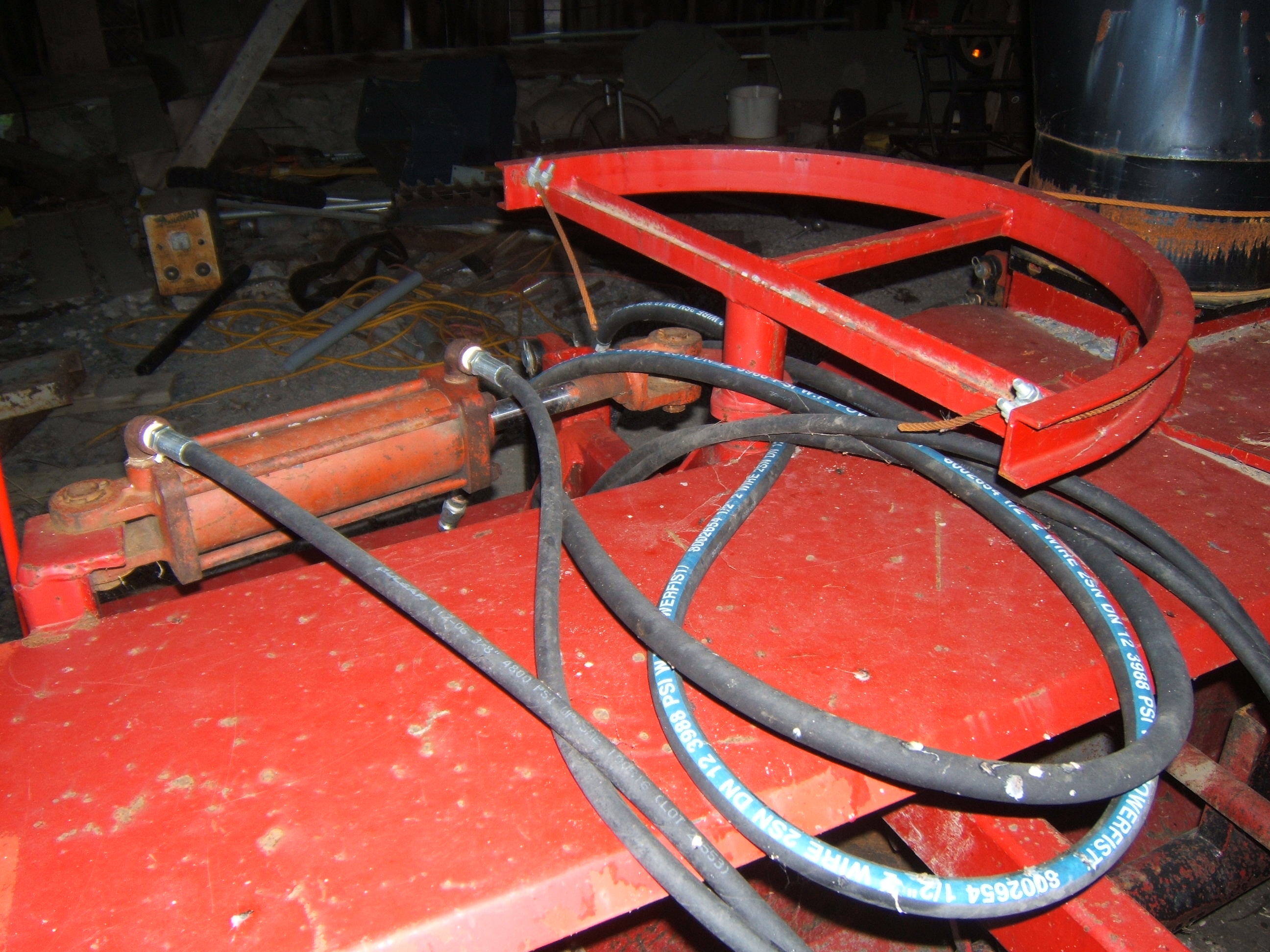

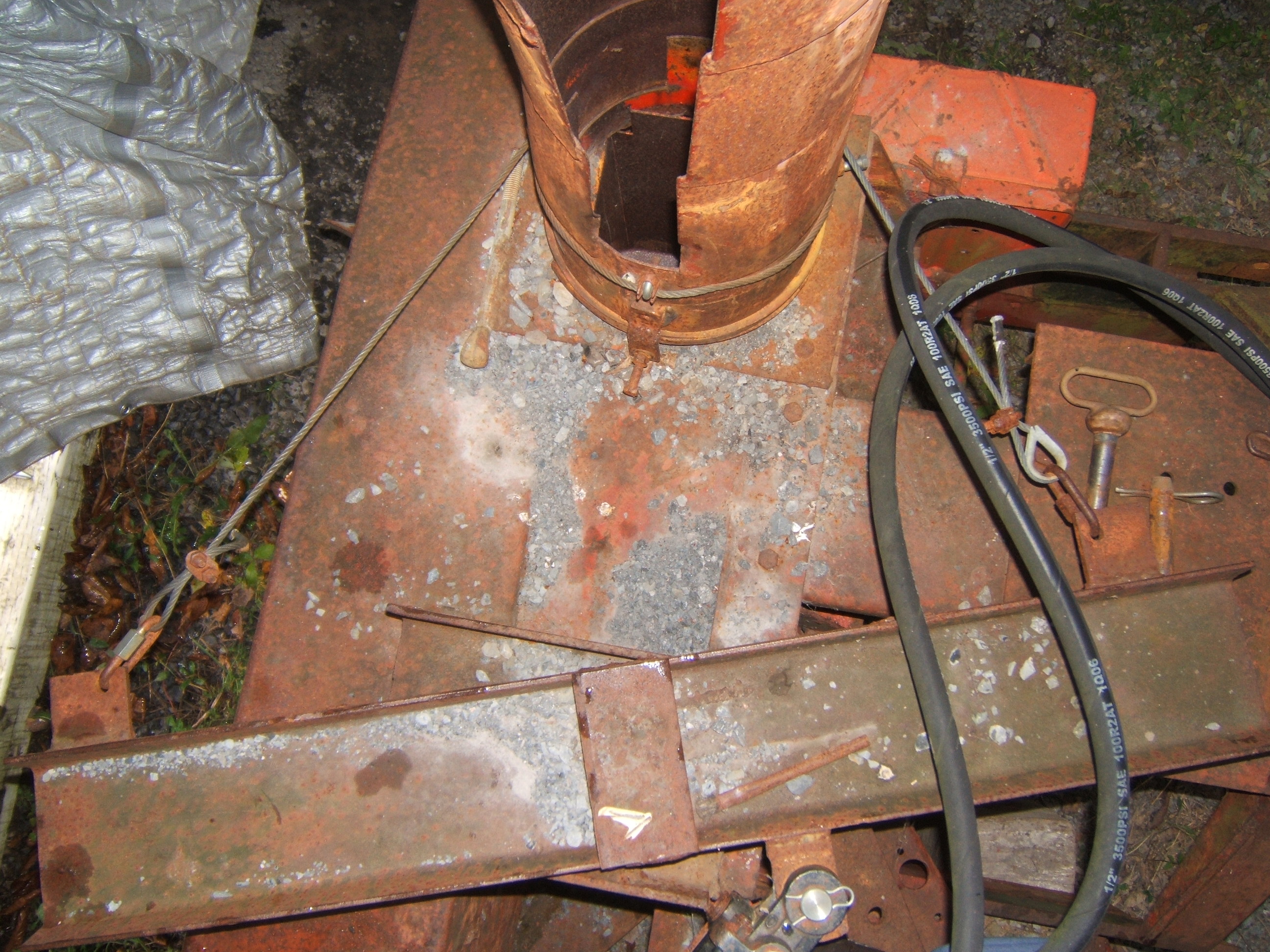

There are simple do it yourself alternatives to a hydraulic motor for chute rotation.
I will provide pictures of a few.
In the simplest style, a bar is swung by a hydraulic cylinder. A cable wraps around the chute and is pulled by the ends of the bar.
You need to view the chute and whatever pulls on the cable as two sprockets. Each needing to move through a circular path. With the bar, its movement is not following a circular path and for this reason, the trick is to not fasten the cable to the ends of the bar but rather to have the cable go around a pulley or roller at each end of the bar and then be fixed to something immovable. This ability to slip at the ends of the bar makes up for the fact that the ends of the bar do not follow a circular path.
The second example has a piece of light channel bent into a semi circle. This semi circle has the cable affixed to each end. Because the semi circular channel moves in a circular way, the cable can be fixed directly to each end of the semi circular channel.
The last example shows what not to do. The cable is fixed directly to each end of a pivoting bar but because the ends of the bar do not follow a circular path, the cable's movement if unacceptable.
In each of these designs a simple double acting hydraulic cylinder can be used. Typically a 2" diameter x 8" stroke cylinder.
