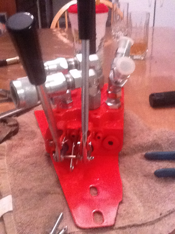

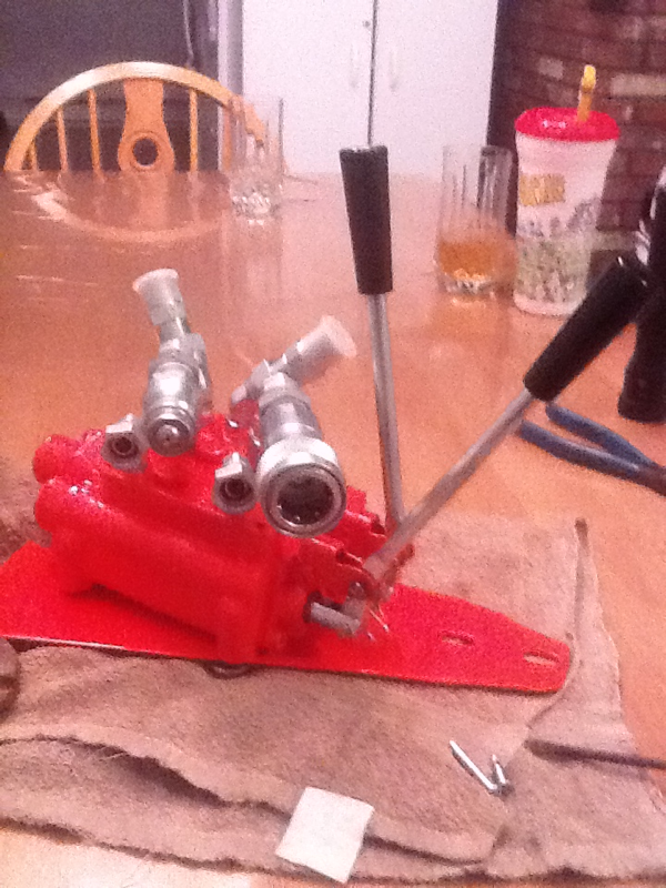

See the attached pics of my 2 spool valve , the QC are for the hydraulic Top link, and the 8's are for a chute rotator that I still have to figure out,,,,I will post more when I mount it on the tractor tomorrow

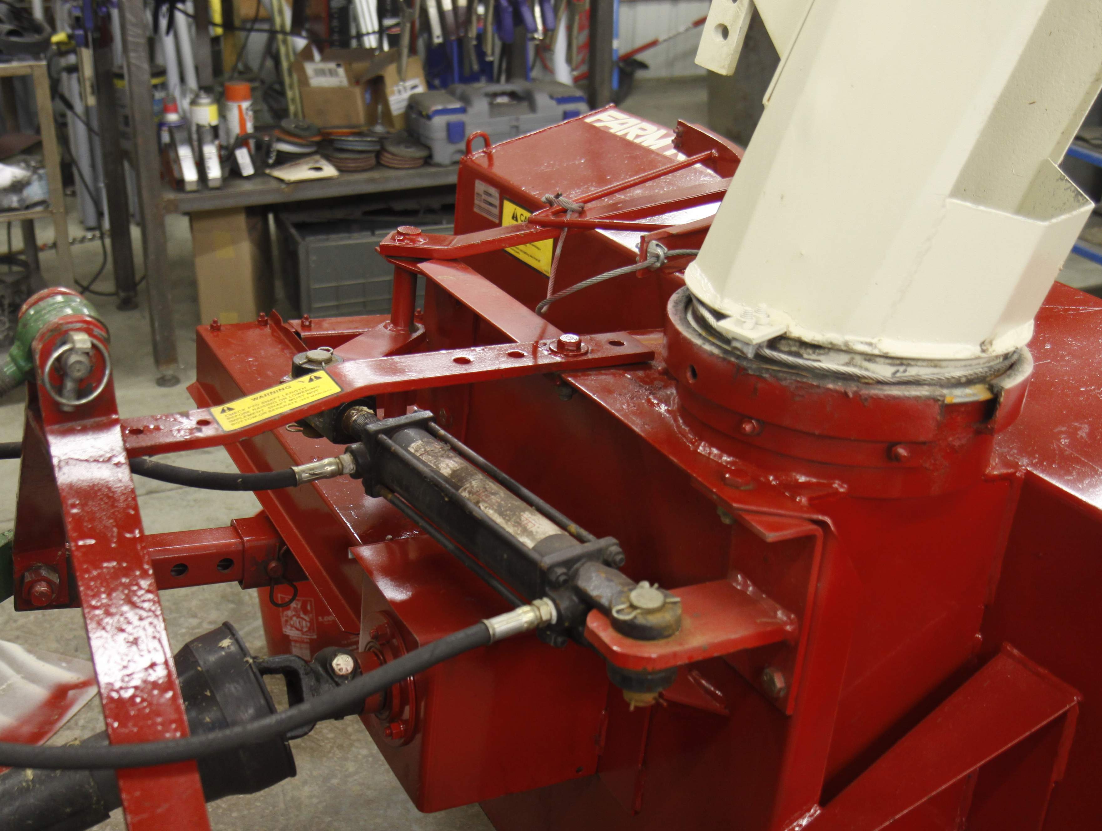

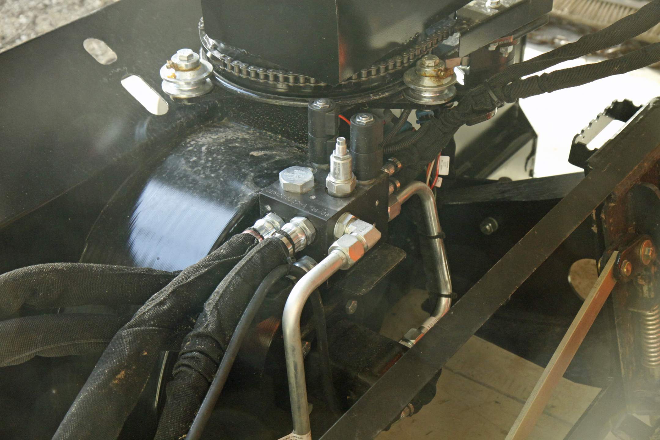

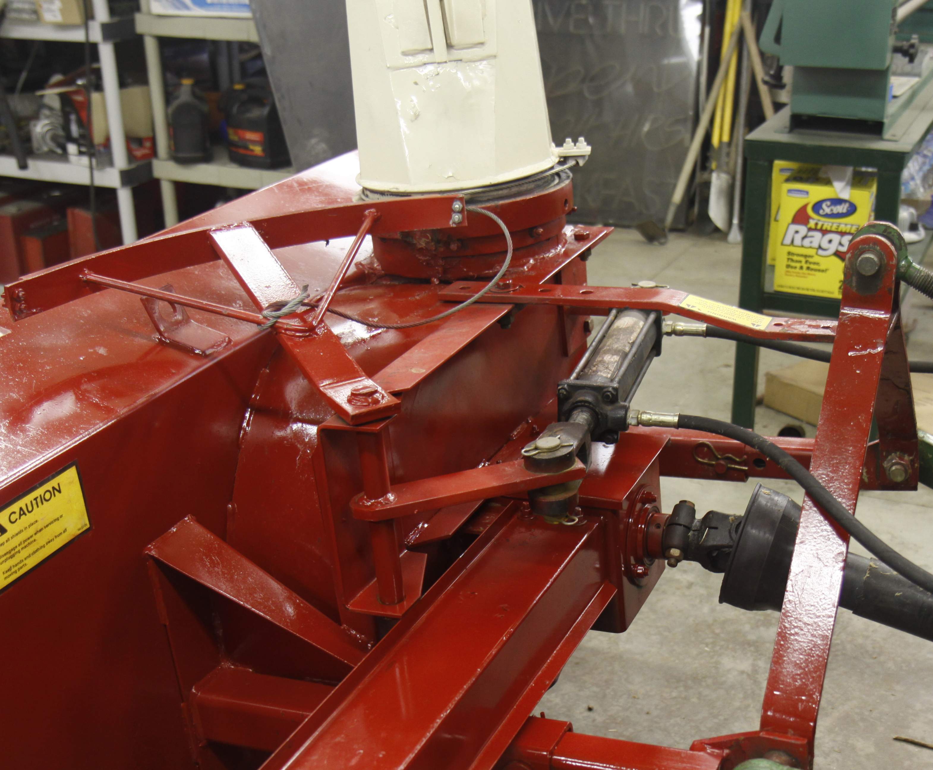

My old farmking used a simple radius pulley and a piece of wire rope. A 8" double acting cylinder would then rotate the chute in about 1-2 seconds thru 200 degree turn. The parts were about $100 for the pulley and i had the cylinder in storage already. My new blower is super complicated thing....hydraulic motors, chains, relays.....looks like a mess if i had to work on it. Works amazingly fast though.
