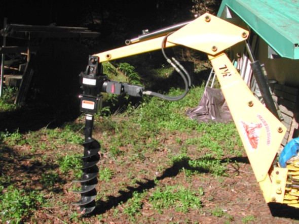

I adapted the Worksaver 714H to my 7.5' backhoe. It
works well, but I have not put it to production use. The
tractor is a Kioti CK30H. Hydraulic seems the only way to
go, IMHO.

I currently have both the Worksaver std duty 3-pt
PHD and their 714 hyd unit for my Prairie Dog b/h.
I have tried them both with the same 9" HD dual-
flight auger.
I have a lot of rocks here, so drilling is not really an
option, even when I hired excavation contractors.
That said, the hyd unit has down pressure, is reversible,
is protected by a relief valve, and when mounted to a
b/h it has much greater fleibility of hole placement and
control.
The 3 pt PHD is scary if there are any rocks because it
can suddenly grab one and drill itself into the ground. Then
you have to unscrew it by hand or dig it out. You have to
drive your tractor fwd or back to try to maintain plumb. You
have to keep your foot on the clutch and hand on 3-pt
control to avoid "getting screwed".
Basicly you are looking at $1500 vs $500, plus the auger.

The Worksaver 714H is designed for the lower GPM of a CUT.
It uses a 3.18:1 gear reduction box for torque multiplication.
The relief valve is adjustable, but protects everything when
you hit that pressure. It comes with the brackets to mount
to a loader bucket, as well as a counter-weight so it initially
hangs vertical. I made my own plumb indicator, however.
The torque you need to drill a 12" hole is much higher than
drilling a 9" hole. Keep that in mind. Dual vs sgl flight
augers remove material faster at the same speed, but 2
edges are cutting, rather than one. Potentially greater
digging speed with the dual at the same RPM.
