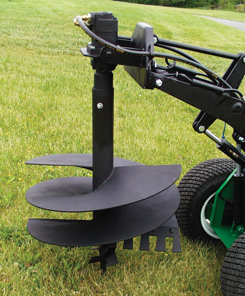

I have a JD5083e that suppose to have 15.9 GPM pump flow on rear remotes (~22 GPM total). Open system.
From what I understand the valves (FEL, rear) are in series so the total pressure (~2800 psi) will be shared ???
Not sure how using loader up/down movement will affect the flow/pressure to the hydraulic drive which will be connected to the rear remotes.
I'm considering Belltec (htls6k or m300) OR Danuser (EP10 or Pro 1025H) drives.
HTLS6K | Belltec Industries Inc.
NC300, M300, H300 | Belltec Industries Inc.
Model EP10 | Danuser
Model 1025H | Danuser
htls6k should spin my auger at 25 rpm and deliver more than 5000 ft-lbs of torque.
My questions are:
1. Would 25 rpm be too slow to drill holes? Or would it be of benefit in case I get stones and the bit would be easier
to control at such low speed.
2. Would the flow to the drive be affected by the operation of the loader? i.e. in open system would the pressure
/flow remain the same when I use loader and auger at the same time.
3. Which drive would you recommend for my tractor? EP10, Pro 1025H, M300, Htls6K?
4. I see the hoses I have on the tractor are 1/2" ID and about 3/4" OD, what threads are the hose endings on JD tractors, or any tractors? 1/2" NPTF?. Just asking as I'm not sure what to order from discounthydraulichose.
5. If I order 2" hex drive from Belltec, can I use bits from other manufacturers? Are the 2" hex, bolts standarized so that the bit will be interchangeable between different manufacturer's drives?
I'm planning to get a rock bit, my drilling soil will be rocky gravel, occasional 8-15" rocks.
Sorry for asking so many newbie questions, but the dealers don't seem to answer them. They want to sell whatever they can. You want A? We have it. You want B? no problem. Is A better than B? Well, they both are good, etc.
Thanks,
Peter

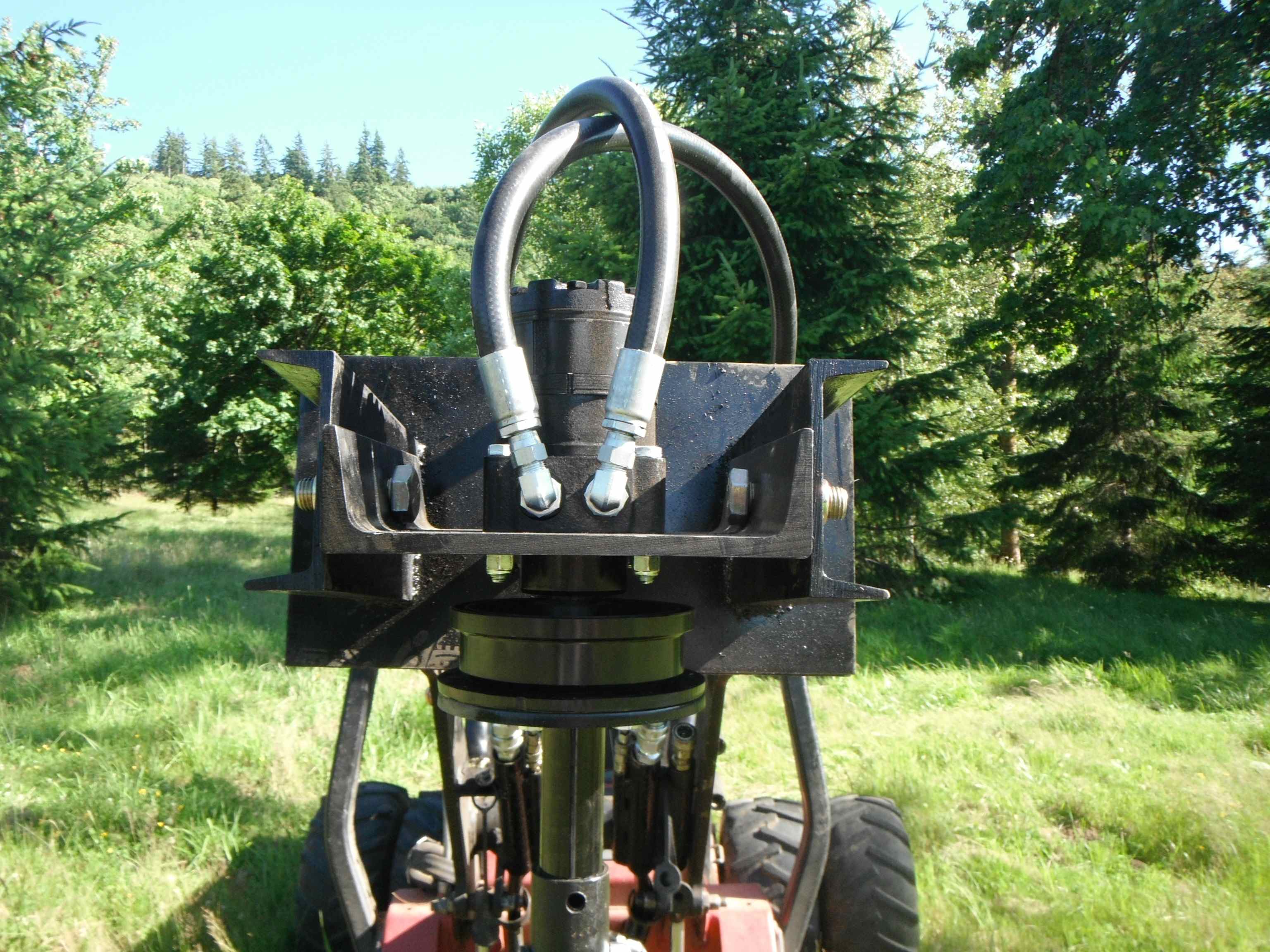

/ Hydraulic auger question #8
Are you buying retail or do you want to make a hyd auger.
You simply get a large cu in hyd motor and adapt a fitting that will take a hex, round, or square shaft.
A hanging mount for the loader bucket with down pressure and an auger of your choice, at much less money.
The second picture uses a hydwheel motor .
What hydraulic motor would you recommend? 2" hex adapter? Valve?
The loader mount I can weld.
Never done hydraulics projects, so go easy on me.
GPM = Motor Displacement x Motor RPM ÷ 231
Motor Displacement = 231*GPM/RPM
16*231/30 = 336 cu
Torque=PSI x Motor Displacement ÷ (2 x π)/12
2800*336*(2 x π)/12= 471 ft-lbs
But motors have much smaller displacement, so I'd need to run it at higher RPM and have a gearbox to slow down the bit? On your picture you mounted the bit on the motor shaft, right?
What is wrong with my math? How can I achieve 4000 ft-lbs at 20 RPM from 16 GPM? That is what Belltec claims to do. Is this just marketing mumbo jumbo?
57.4 cu in CHARLYNN 10000 SERIES MOTOR 119-1035
would be about 2000 ft-lbs and 60 RPM @ 16 GPM

/ Hydraulic auger question #11
I would probably guess that some of the larger hyd augers use a large hyd motor into a planetary gear housing and develop a lot of torque.
What all this means is that if you can round up all the parts at a reasonable price and have medium mechanical skills, you can do it.
Adapters can be purchased, built, etc.
Looking at the picture of the Power-Trac with home built auger, he used a large wheel motor with wheel hub and then bolted on a matching plate with matching holes and then welded a shaft adapter to fit an auger.
The adapter could be 2 in round stock, hex shape or square depending on the auger you have available.
This motor would be a good starting point. Reasonable price.
22.63 cu in DYNAMIC BMER-1-375-WS-T4 WHEEL MOTOR
Then add an adapter, maybe a wheel hub like this at 1 1/4 taper.
4 BOLT WHEEL HUB 1-1/4" TAPERED
Then bolt on a plate with the adapter you need.
Again the torque is based on the cu in and psi.
GPM's determine the speed.
