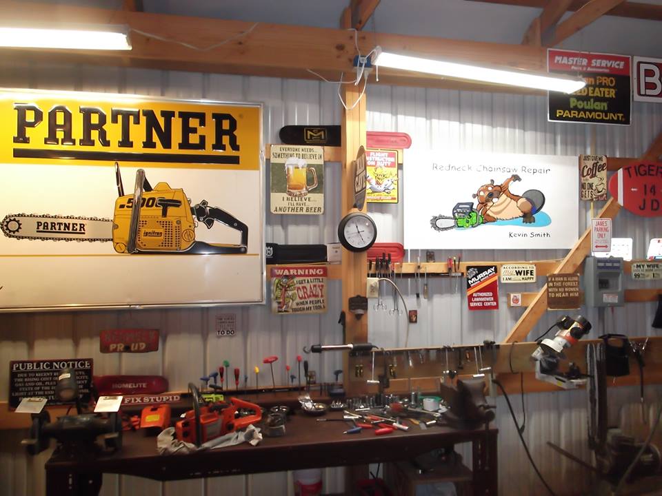

I'm just a redneck chainsaw shop. But dang this guy :confused2:
Reason I wanted to know the name of shop, I booted a guy from Maine that worked out of a trailer. Booted him a few years ago from the group. Could see through his BS if it is him. But who knows. PM me shop name if you like.
This is just bench #1 at my place and I have 3 benches.
See REDNECK is my shop name to the right.

I hope I can read those signs when I zoom in, I love a shop with humerus signs especially if pro 2nd ammen. This guy used to work at this saw shop 10 years ago at Cousins saw shop with lumber mill, all closed up now and dont look like that mill has been run in several years, but it made a good location to sell saws, dont know what happen there but seems so when I bought a saw there I vaguely remember him 10 years ago. Then around 7 years ago a younger kid was there and that's who I bought this 550xp from, now he's gone, where I don know, all's there now is a faded sign of Jonsered.

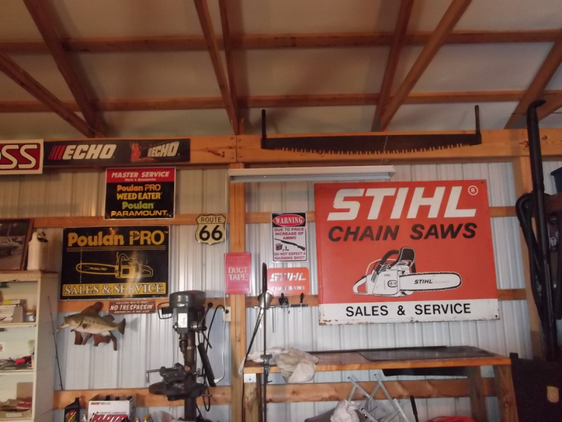

Signs for OP, still not all of them. Just some on HD.
1 is on pole on 700' driveway ;)
