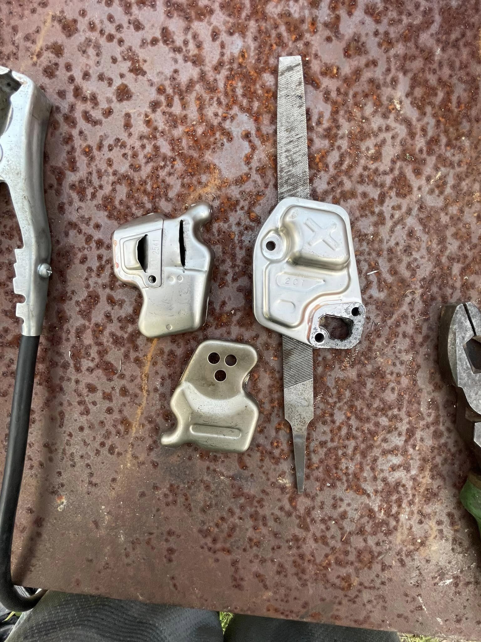

First thing I do with any new saw is remove the muff (it's easier when the saw is still a virgin) and mod the muff for easier breathing. If you really want to go 'all out', get yourself an expansion chamber for the saw but that is a cumbersome alternative and will require rejetting and other expensive mods as well.

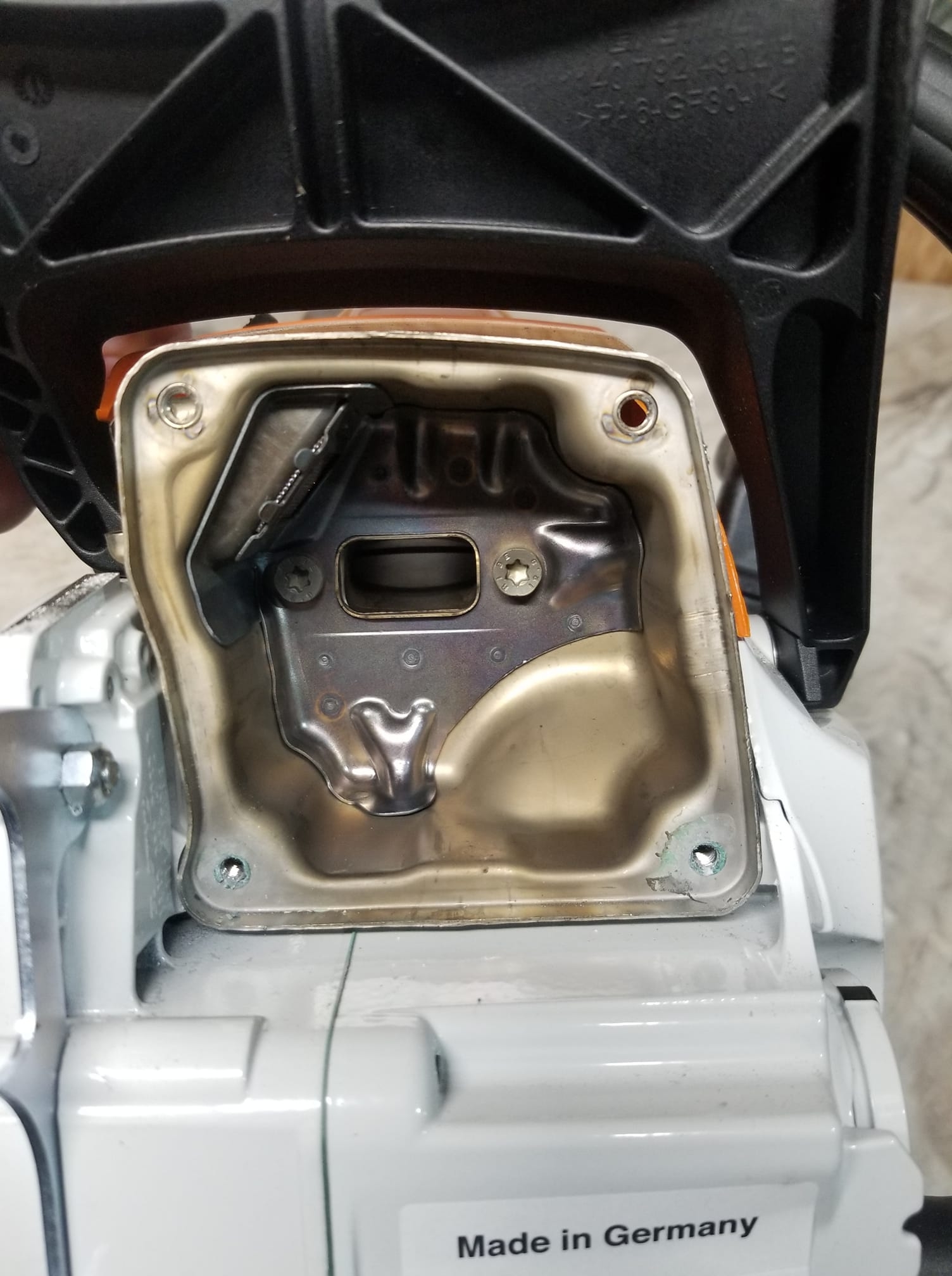

Stock muffs hold ALL of them back from potential. least in my view, but especially Stihl saws and especially the newer ones.
Especially Echo's IMHO worse then stihl
Pretty dang open stihl right there and a new saw.
Cant BS your way through with me. ;) I own echo's
Then inside a echo all stuff up.
