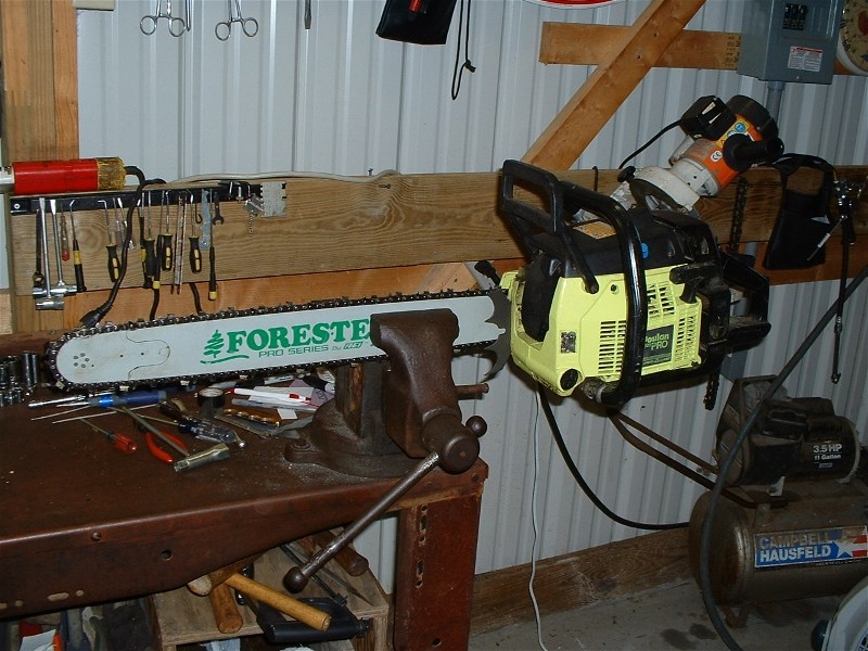

I've got three saws, but am only one man. It takes less than five minutes to file a chain. I can't imagine dedicating bench or shelf space to a grinder.

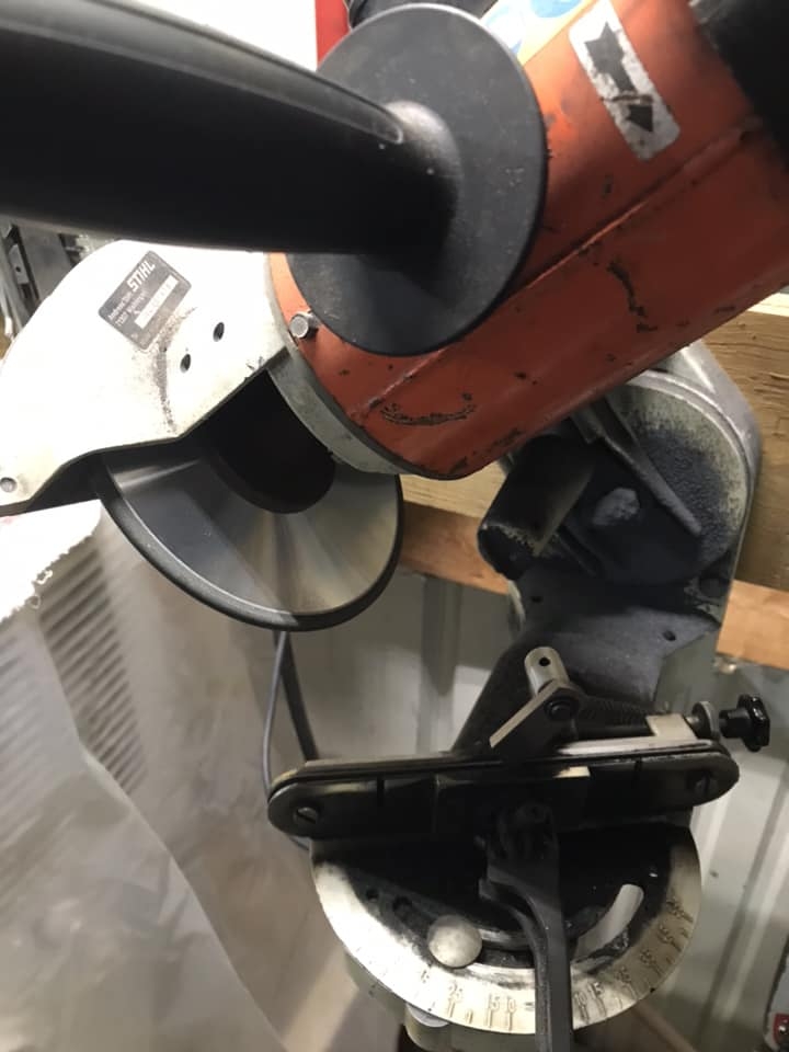

I have a stihl USG grinder and I still hand file my own. Unless I get behind.
I just mount in vise on saw and go through one in no time.
Takes more time to take chain off, put on grinder, set up and then back on saw.
Only reason I bought a grinder was because of everyone else bringing me bulk trashed chains all the time.
To me doing a chain on grinder is repetition work for crap pay and kid could do it if trained right way. So boring to me to do that way.
