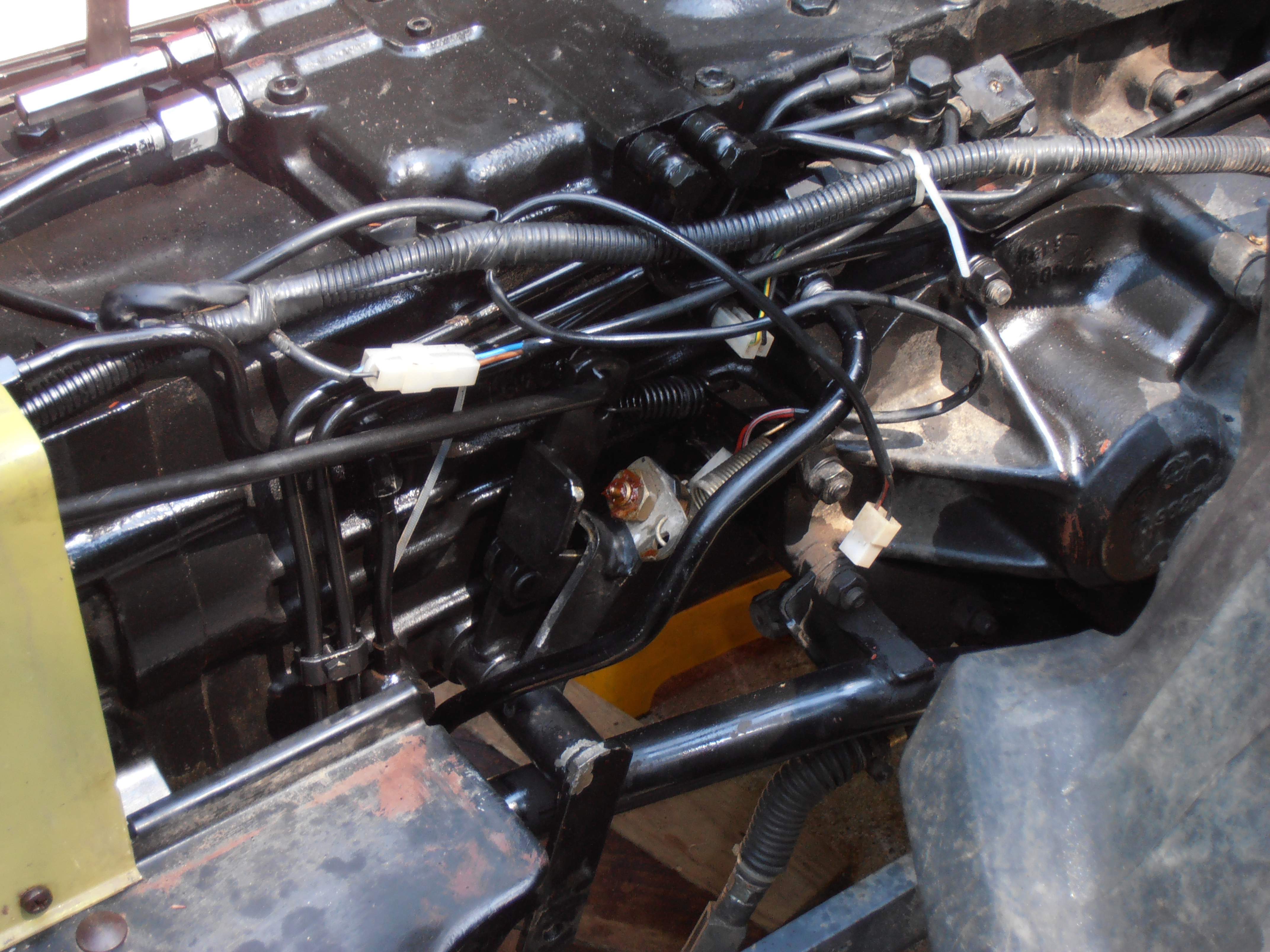

PRogress,

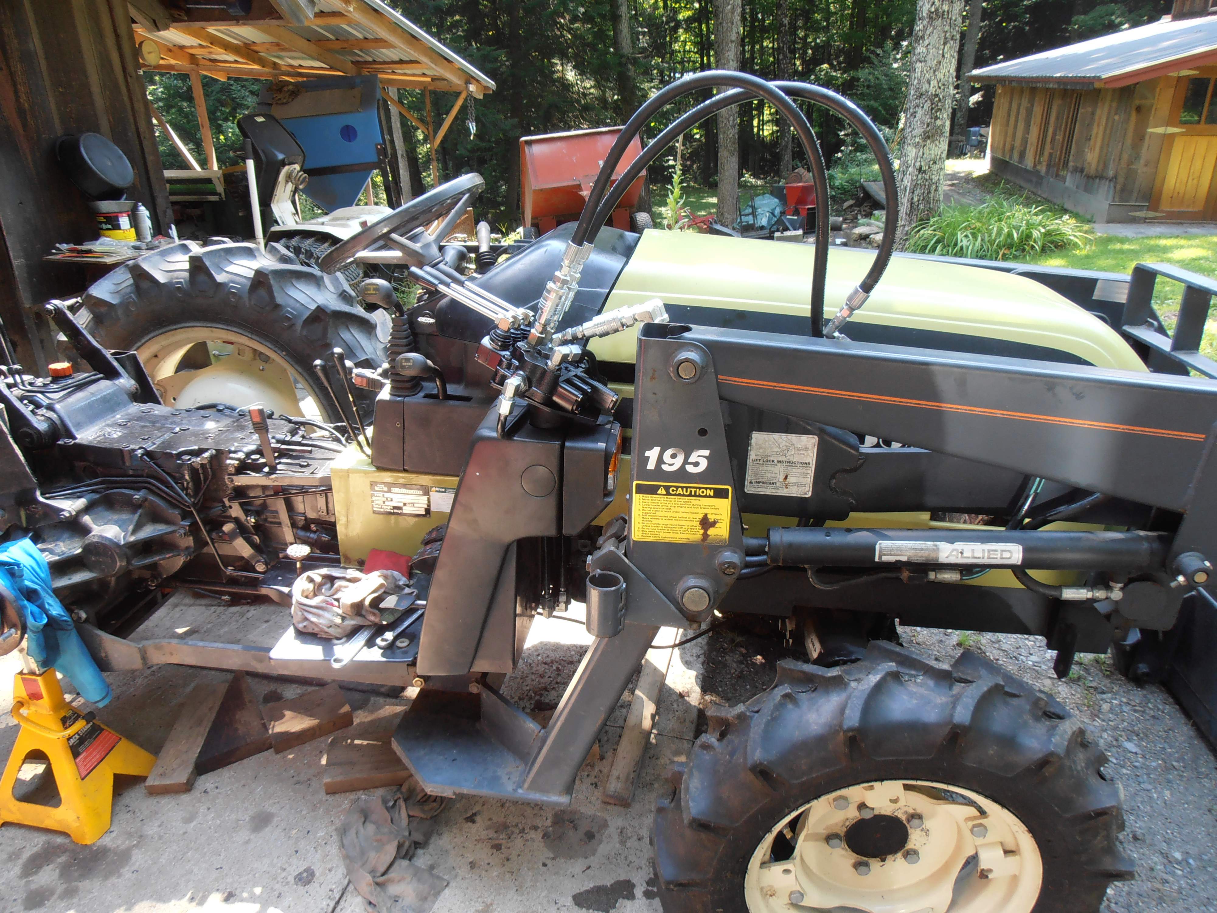

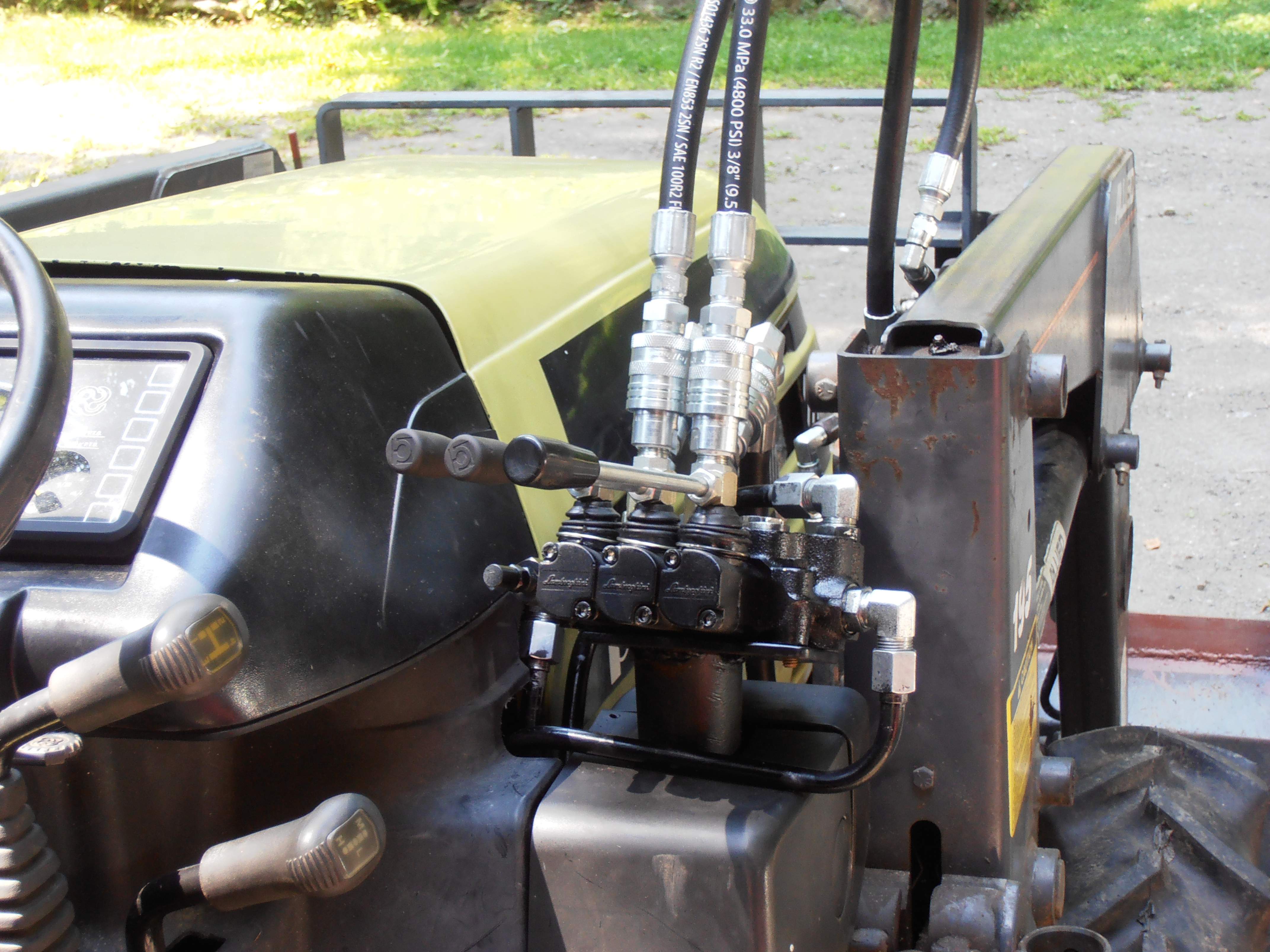

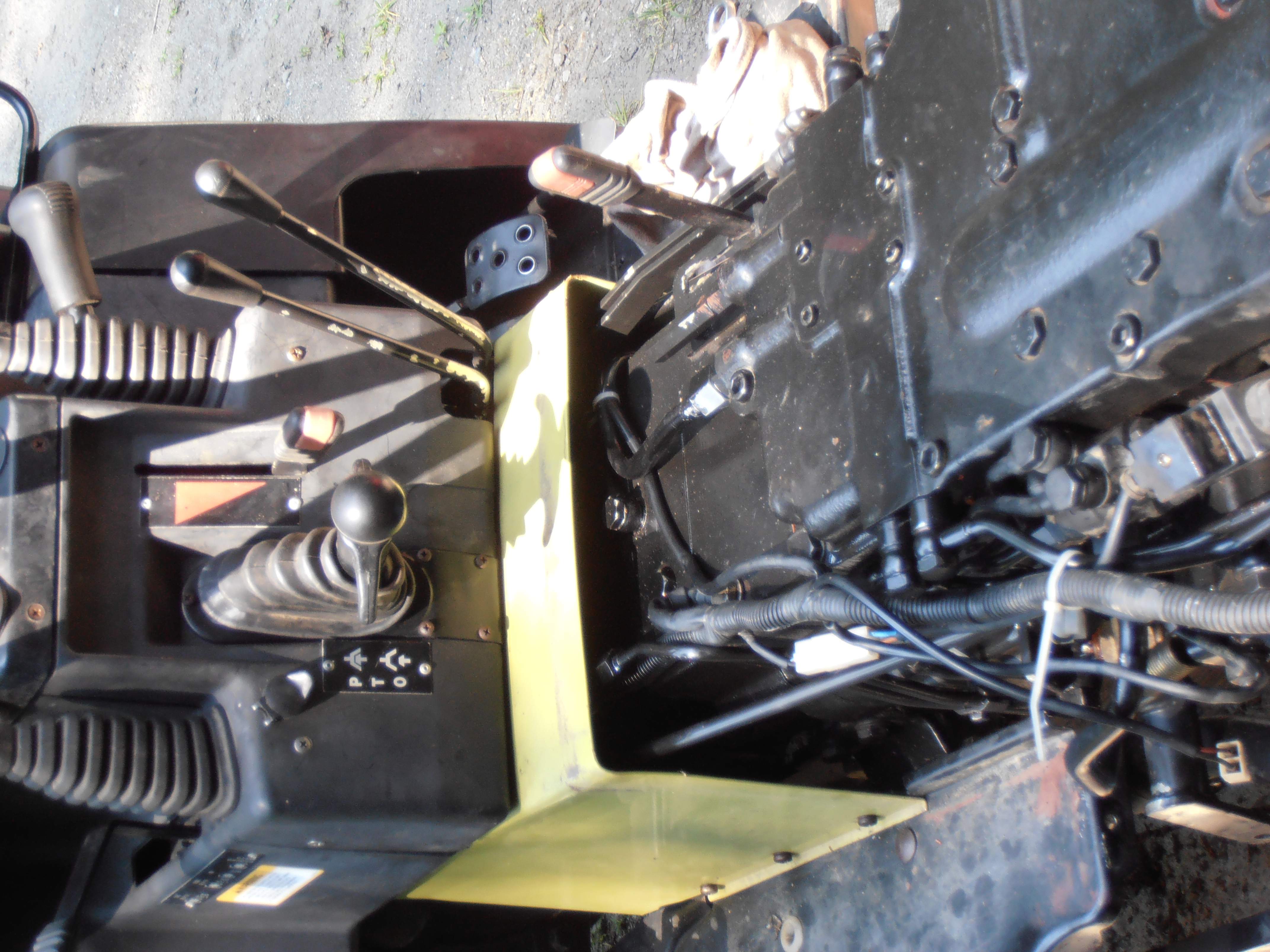

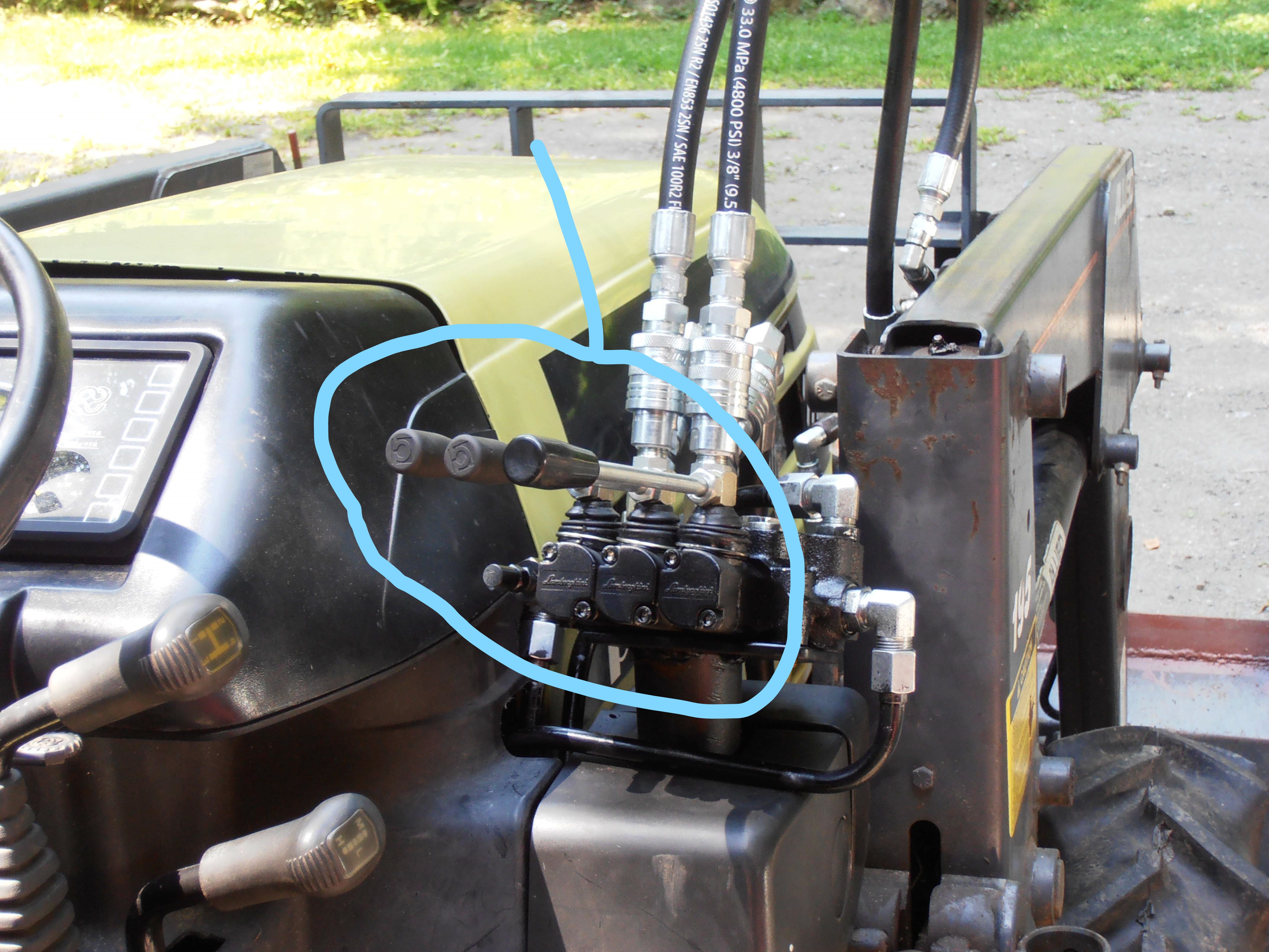

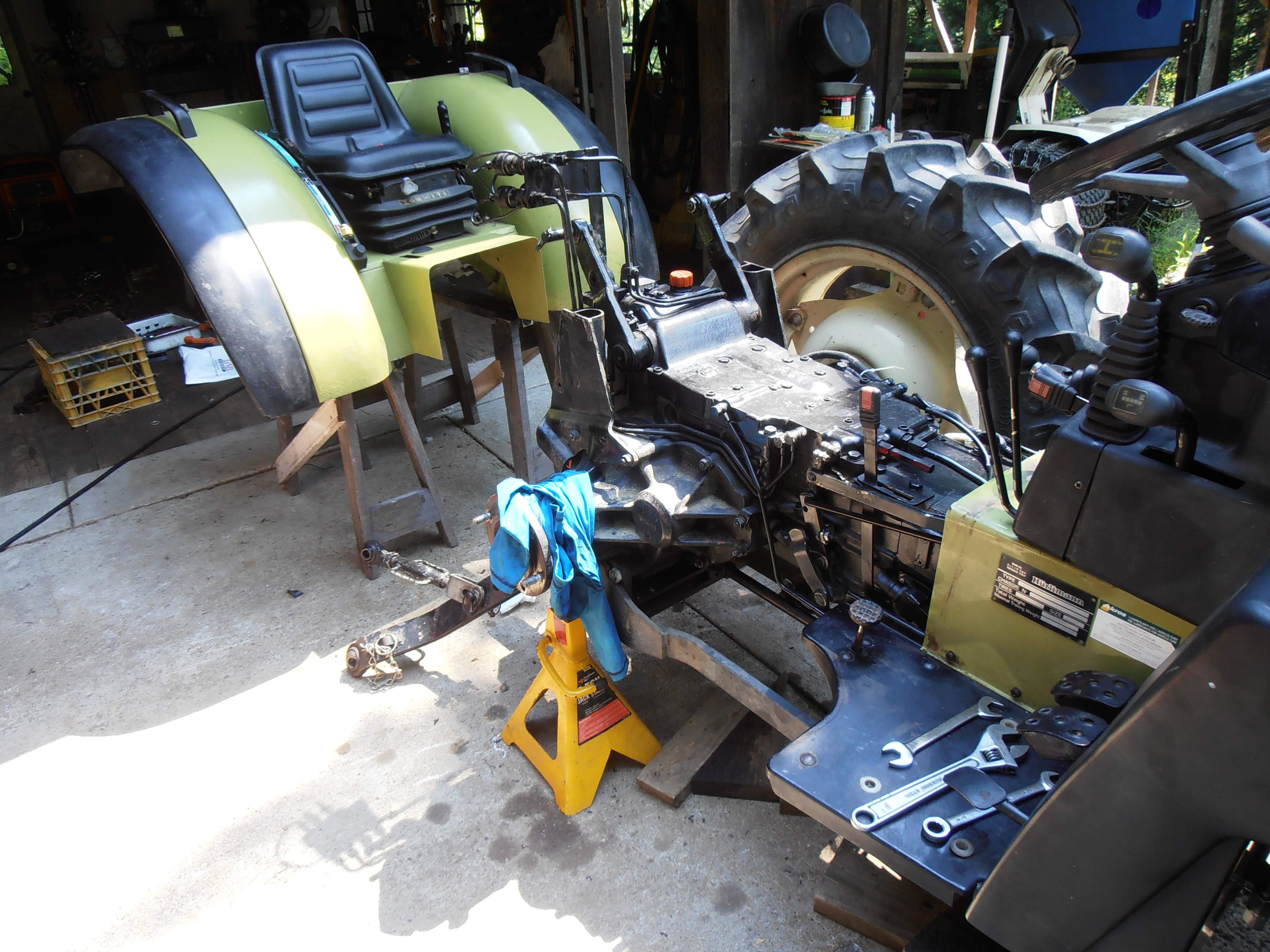

Valve and plumbing in, System works as desired!
I took photos while everything was exposed, but this morning my wife tried to move them.....vaporized
Here are some "make up shots" as things are going back together.
It's nice to have float on the boom, and the freed up aux ports will be a boon for the blade and york rake.
Sure does suck up the time. And I'm not realy happy with the "arches" for that pair of lines. might need to see what can be done to route them low like the other pair.
While the hard lines were out for painting, It looked like a congregation of snakes on the sheet of card board.
I got real lucky with a few of the bends in the 1/2 inch steel line, snaking through what I thought would be near impossible. There is really NO ROOM for much of anything to pass under or between things. Certainly some of the runs would not have fit rubber hose.
Now if I could just figure why the 3PH doesn't fall when the lever is in float and the engine off...... ;-)

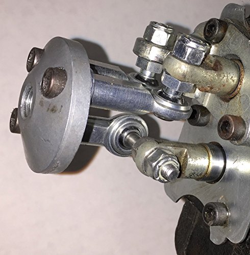

Yes, I'm working on a single lever mechanism for the LAMBORGHINI three spool directional control valve that was purchased for the Princely sum of $85 NEW with the PWB plug ;-)
I had to have it cause it was a Lambo......but I wish I would have fitted a control block with single lever for the loader. The third spool has gone unused so far.

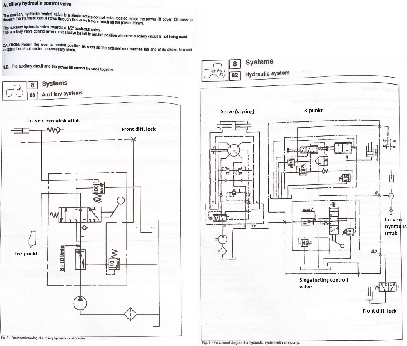

Hi!
I have a Hurliman Prince 325. 1999 model.
The tractor has only one hydraulic outlet.
I find this post very helpful, but I wish to ask some questions about the installation if you, or someone else remembered the answer to.
Im looking for the main supply from the hydraulic pump? Underneath the tractor i have found a pipe from the same area that the hydraulic pump got it oil supply. Can this be the main pipe from the hydraulic pump? (see last picture)?
Im looking for a place to drop inn and get hi pressure to a new control valve.
Trygve Andre

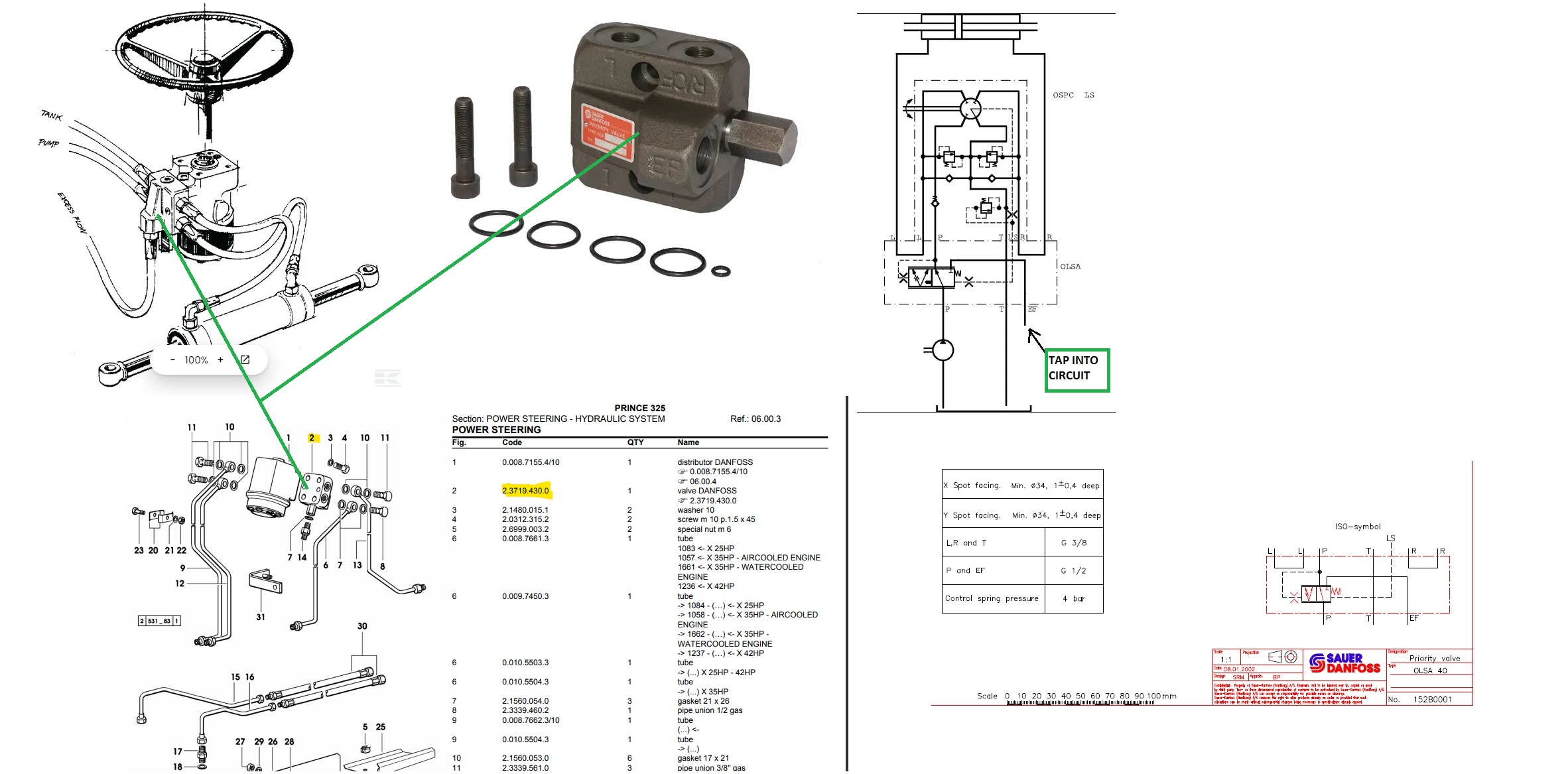

Amasonic
I tapped into the Power Steering priority valve as the high pressure source.
One could follow the output line from the pump and tee off of that, but then the steering would not be prioritized.

Amosonic
Thanks for quick answer CalG.
The Power Steering priority valve is located together with the Hydraulic steering control.
Now I know how to connect my future external hydraulic control valve (open centre) in serie with the rest of the hydraulic system. I will also drop in the "T" connection at the power steering priority valve for the "pressure relief valve" who is build-in the new valve-block.
