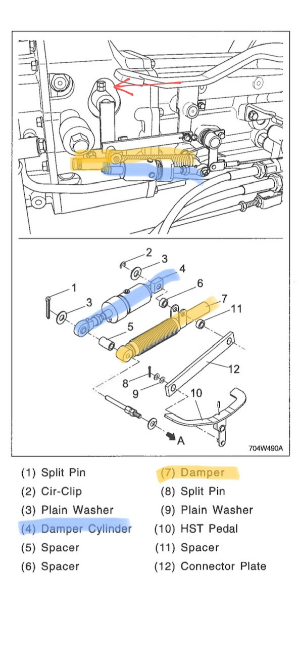

HST pedal creeping - how does this system work?!

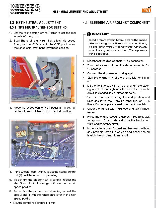

I agree with TN8 on the HST Neutral Adjustment....here's what my shop manual says for the NX series tractors. HST Neutral adjust Procedure.JPG
Hope this helps.

You mean the adjustment of the linkage? Yes, it did not help. As I explained I tried it with all the linkage disconnected to isolate if it is a linkage issue or hydraulic issue. Still tough to tell but the easiest quickest test would be to throw in a stiffer spring. My plan to stack washers behind the spring is effort to mimic that.
   / HST pedal creeping - how does this system work?! #34
I would not think disconnecting the linkage would result in no motion creep. Adjusting the linkage with wheels lifted is performed to find the neutral (no creep) zone.
   / HST pedal creeping - how does this system work?! #35
I agree with TN8 on the HST Neutral Adjustment....here's what my shop manual says for the NX series tractors.View attachment 679406
Hope this helps.
Thank you. I will try this. It creeps much worst when I first start the tractor. I take that is because the fluid is cold and thicker right?
   / HST pedal creeping - how does this system work?! #36
Not sure to be honest. I've not had to do this procedure on my tractor...if it were me, I would do this neutral zone procedure after the tractor's up to operating temp. Good luck, hope you can update us.
