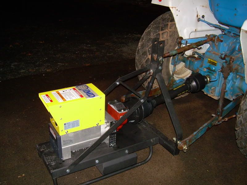

Thanks for all the info guys. Just fired off an email to IMD for a hertz meter. My 15 kw pto unit is not running at the right hertz and hasn't been for some time. I can't seem to find the sweet spot to get everything to run properly.
I backfeed from the garage 200' away through a 100 amp sub panel. The main is always shut off first, as well as the submain feed to the garage. I then go fire up the generator then I go back to the main, confirm it is off and turn on the submain feed from/to the garage.
The generator is currently on a heavy 4 wheeled cart in the garage, soon to be remounted onto a 3pth lift with casters. That will allow me to roll it over into the back of the garage out of the way during use.
I will say, when it was not secured to the cart tightly, when the switch is thrown it will flip over.:eek: Done that once or twice.
As for run times, my 4150 Kubota runs the generator fairly easily powering our entire house. I have let it run for 18-20 hours before with no problems and it uses very little fuel. We loose power for more than 2 hours 6-8 times per year and at least 3-4 times per year for 16 hours or more.
When we loose power I tend to let it run overnight and allows everything to function as normal. The only issue I have is the boiler as it is 110v and upon start-up it will make the tractor stumble slightly. All the 220 stuff (18,000 btu a/c, water pump) is a breeze for it. I usually shut down the oil burner anyway during gen operations and run my wood boiler, so that is not a big issue.
