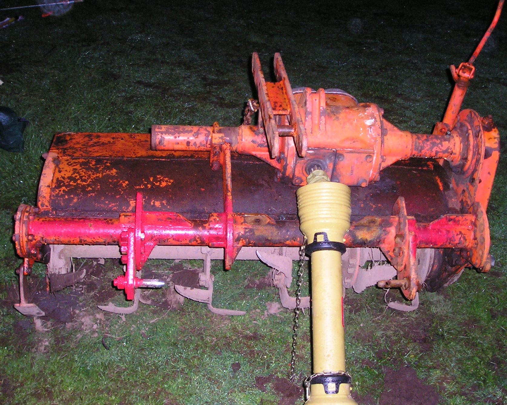

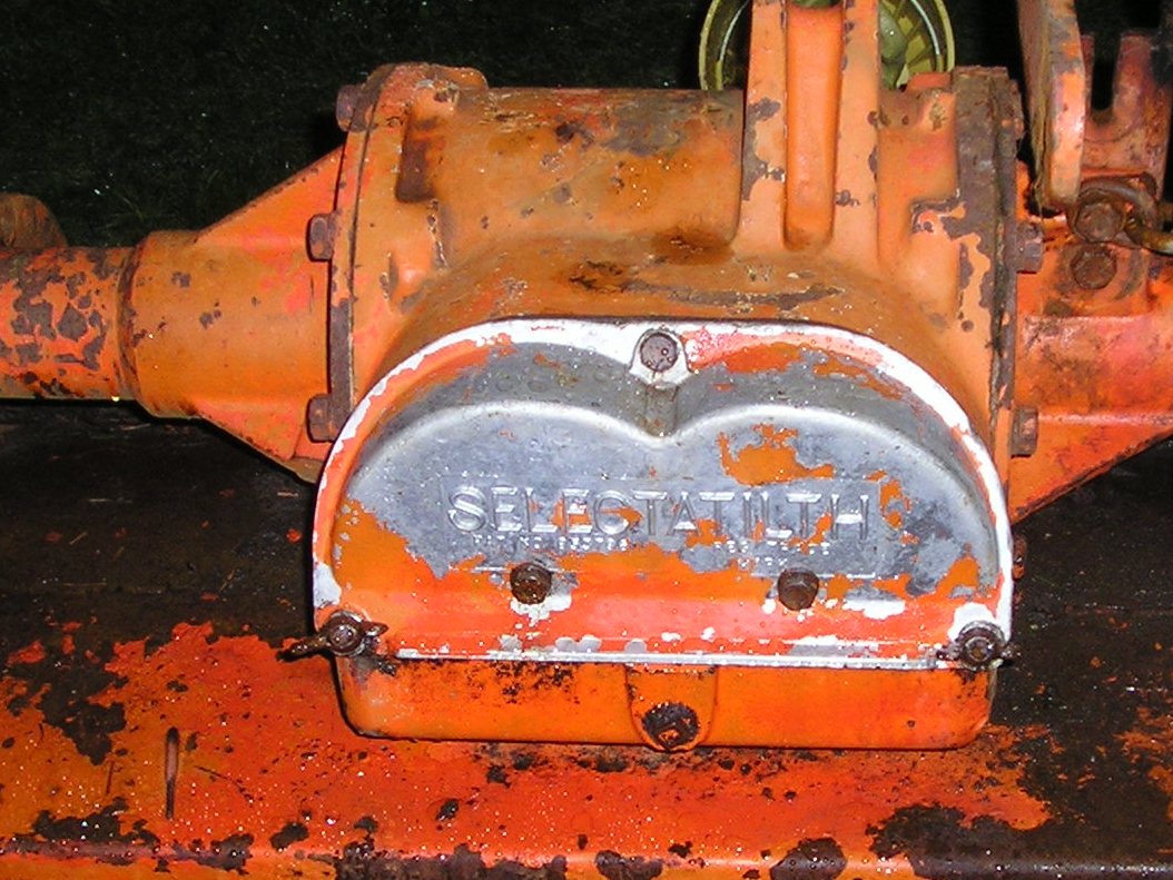

A few months ago, I purchased a very used Rotavator which I think is a E series (E50).
For anyone who owns something like this, can you tell me?
1. What are the four speeds of the Selectatilth gears?
2. Why type of gear oil should I use?
3. What (if any adjustments) do I need to make? Grease points?
4. For those who have one of these, do you run them offset, or centered like I'm trying to do?
Thanks in advance,
-Steve

BTW, that tiller is in desperate need of new blades--ask them about that too.

Arkaybee, you can't really tell from the picture, but the tines are actually in really good shape. The soils around here aren't really that abrasive (clay mostly)
Actually Arkaybee is right, them tines are about whipped.

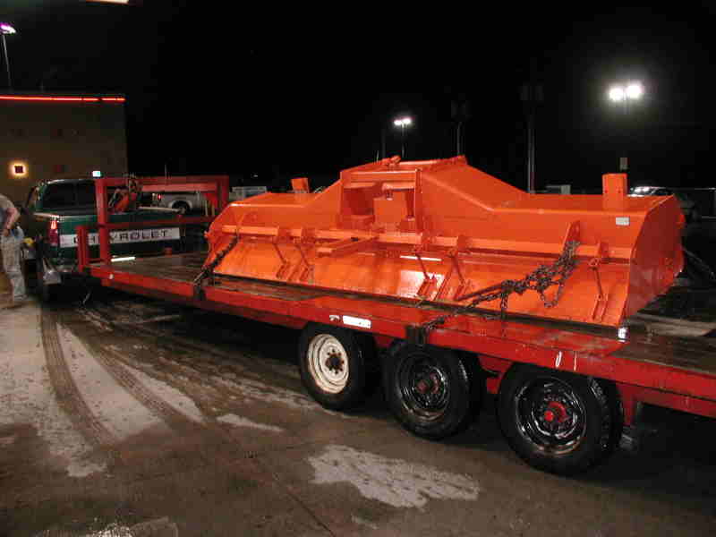

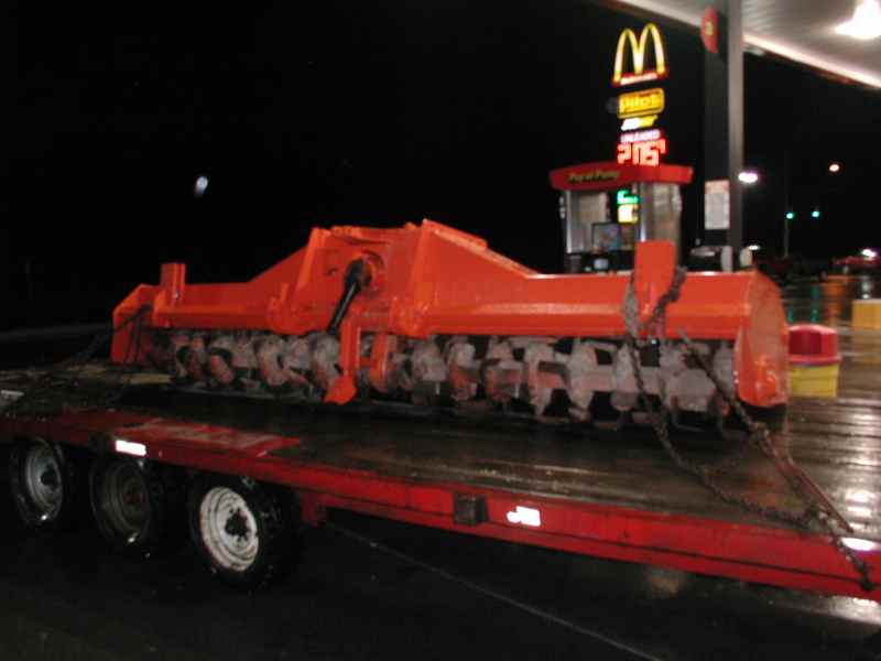

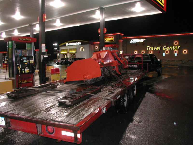

New Howard tines are are almost square across the cutting edge. I have my brothers 50 in the back of my truck right now, going to do some serious tilling this week, but its the baby tiller
Heres its new Mama
and ST160

Your machine is an E Series IV Howard Rotavator. The four rotor speeds with standard gears (15, 16, 17 & 18 teeth) are 122, 153, 172 ad 216 RPM. Recommended gear oil is S.A.E. 90 per the Howard manual. The machine can be mounted offset 10" to the right or center mounted.
The serial number locations are on a plate riveted to the left hand side plate near where the tube from the center gearbox is attached to the side plate and stamped in the arm to the right of the gearbox (U bolt on one end and welded to front support tube). I can see from the photo it is definitely an E Series IV.
