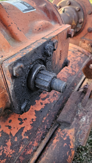

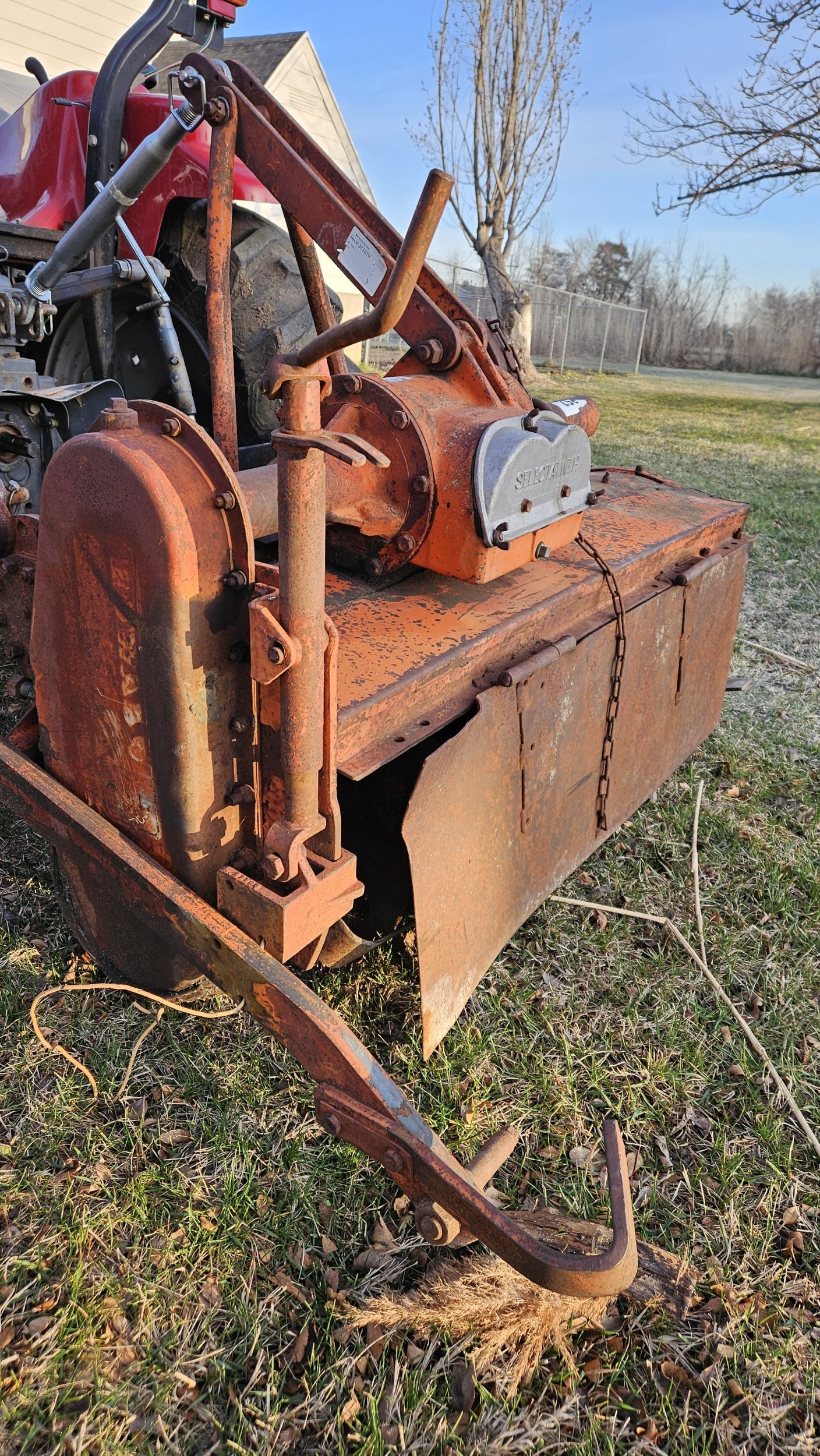

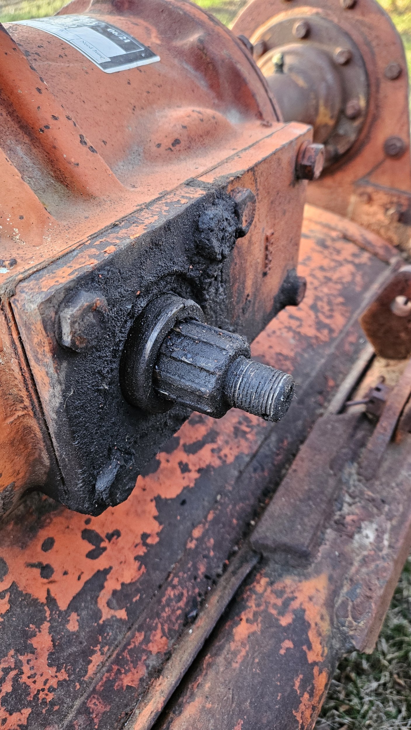

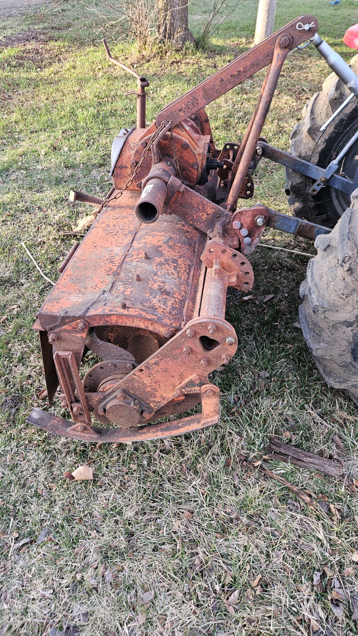

I have an old Howard Rotavator Selectatilth that is missing the pto shaft and slip clutch. Does anyone know where I could find one? The shaft coming out of the gear box is 1.5" and has 10 splines.
Also if anyone know what model this is that would help. The factory tag is missing. There is a date stamped on it, 1968.

OK, do you know what thread size is on the gear box? Is it left or right threaded?
From the looks of things, A splined PTO shaft on one end and the threaded hole interface on the other will get you going once again.

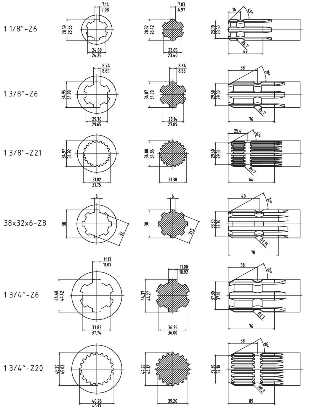

Ever-Power has products like this. Any of these workable?
/ HELP! Howard Rotavator pto shaft #5

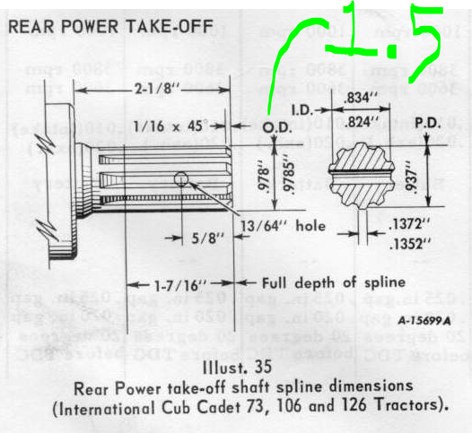

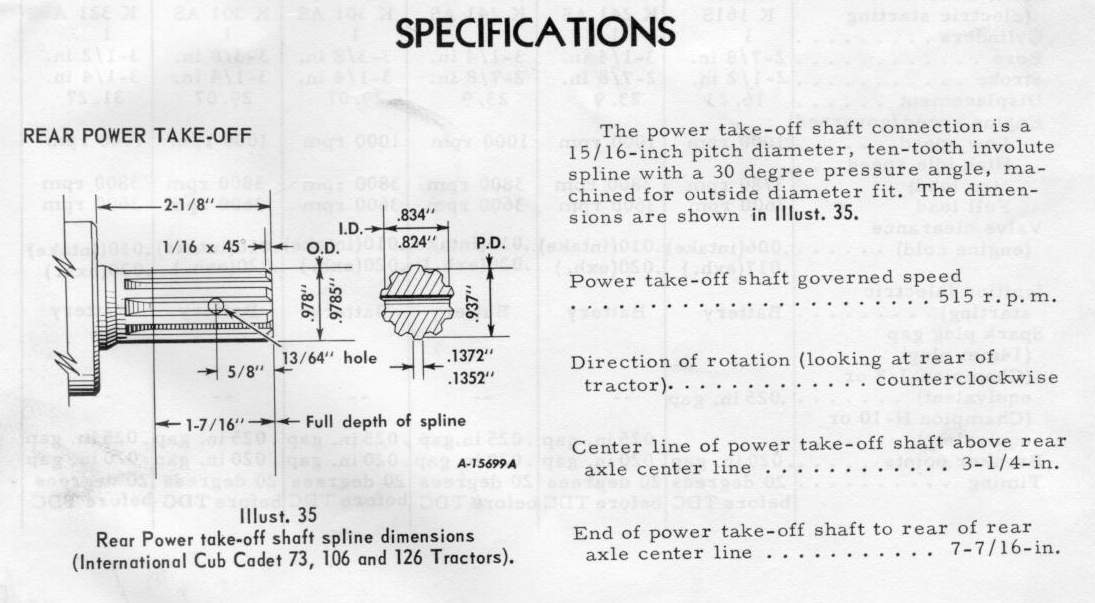

ah ha, found the 10-spline tooth configuration info,
So buying something like this, and have a shop cut a pocket in the back to tap the right threads would work!
(y)
The hole with tap thread should match the Howard then.
Bmaverick, thank you for the information. The threads are right handed. From some other research I've done, it sounds like it's more of an automotive application where you have a 10 spline yoke with a castle nut.
I'm starting to think I may have to go the route of getting something machined if I can't find the actual part. But if I go that route, I may just have them machine me an adapter to from the 10 spline to the typical 540 6 spline shaft now days. That way it's easier to find parts.
/ HELP! Howard Rotavator pto shaft #7
I like your thinking.
I can find 10 spline to 6 spline shaft couplers on the web all over the place.
Will you send me a link to one? I've looked and haven't found one where the 10 spline female end is 1.5" diameter.
/ HELP! Howard Rotavator pto shaft #13
so you are saying to up size this to 1.5?

I believe that is a model E. I will look at my books tomorrow.
Missing the steel gauge wheel
#16
Thank you.
Yes I think it is the E50 because it has a 50" till width and over all width of 62". I wish the factory tag was still on it. Yes the gauge wheel is missing.

E Series II. Series 1 had a 1 speed gearbox only.

SOLUTION. I ended up having an adapter machined to go to a typical 6 spline shaft. Then added a shear pin.
