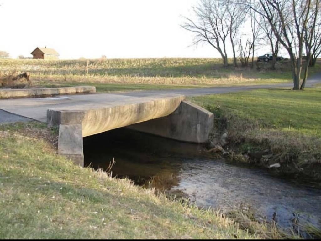

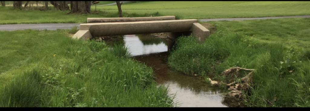

The bridge was built in 1913 by dumping fill over a 6' diameter steel pipe, which is rotting away. The span over the pipe is around 20' to get to solid ground on either side. There is 36" of fill on top of the pipe, topped with 6" of modified gravel. Water is running beside the pipe and undermining what's left of it. As a result, the downstream side (left in pics 2 & 3), is subsiding. The aerial photo is north up orientation and the stream flow is top to bottom.
It's a private road, used by only a few property owners with limited resources. Contractor estimates to replace it with a 6' poly pipe are upward of $50K, which we can't afford. The price is elevated by DEP regulations which require the stream to be diverted during construction. The only way to do this is with large pumps. Stream flow and environmental impact studies prepared by a certified engineer are also required. Construction is made more difficult by overhead transmission lines.
The "cheap" fixes we've been looking at include using flatbed rail cars to span the pipe, or perhaps a 20' reinforced concrete slab. To avoid DEP regulations, anything we do can't disturb the stream.
Any ideas or suggestions would be greatly appreciated.
