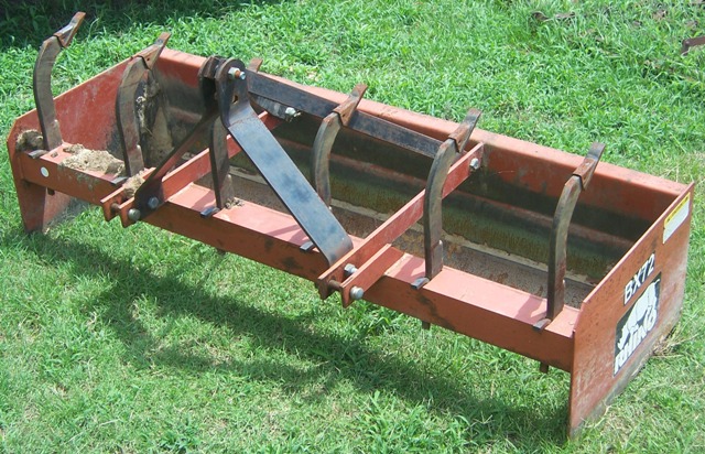

I have read numerous threads and concluded that I need to purchase a box blade vs. a grader blade. I really appreciate the value of experience I always find here. I have a JD950 (30hp) and the 5' bush hog matches the width of the rear tires. I don't know if I need to limit the width of the box blade to 5' or if I can go 6'. The road to my house has a ditch to the right of the road and I don't want to slip off into that ditch trying to move gravel back onto the road. I worry the 30 hp will limit the size of the box blade.

I use a 7' box blade on my L5030 which exceeds my tread width.
You can easily control how much "work" your blade does by depth and angle to allow your 30 HP machine to "handle" a 6' blade.
If you use a shorter one, you can offset a little to get closer to the ditches.

Where are you located? I have a good used Rhino 6' for sale.

Welcome PastureKing. Assuming that you will also have adjustable ripper teeth on your BB, before you buy, flip it over upside down and look at the welds (or lack thereof) on the ripper teeth pockets. I bought a well known name brand BB and had a ripper tooth pocket bend backwards due to NO bottom pocket welding! The company made good and repaired in pronto time. Not sure if all BB manufactures engineer in pockets-can't speak for them. Flip it over anyway and inspect all of the bottom welds.
