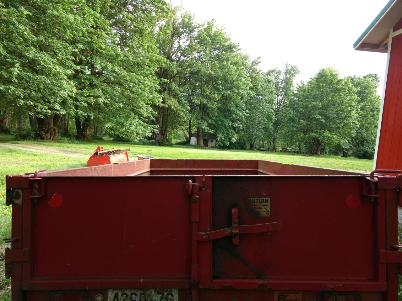

Not sure where to post this...
Slipped on the controls of an excavator while dumping a load into my dump trailer and smacked the tailgate. I hit on the top edge toward the hinge. I haven't measured, but I'm guessing it's 1/4" metal. It's twisted perhaps a couple of inches. One pin got busted, which probably gave a little relief to the overall forces. Local machine shop is swamped and I'd like to get this fixed so I can haul some materials.
I have no welder or shop press, though I've been considering both. Don't have wiring for a welder (not a big deal, but it's time that I really don't have at the moment).
Here's a picture, though it's really hard to see the twist (mostly just wanting to show the overall shape and materials- a "twist" can be amply imagined in one's head:)):

The twist in the hinge pocket is obvious, a large crescent could tweak that back, as far as the rest,
how about some 4x4 blocks and your excavator bucket as a press?

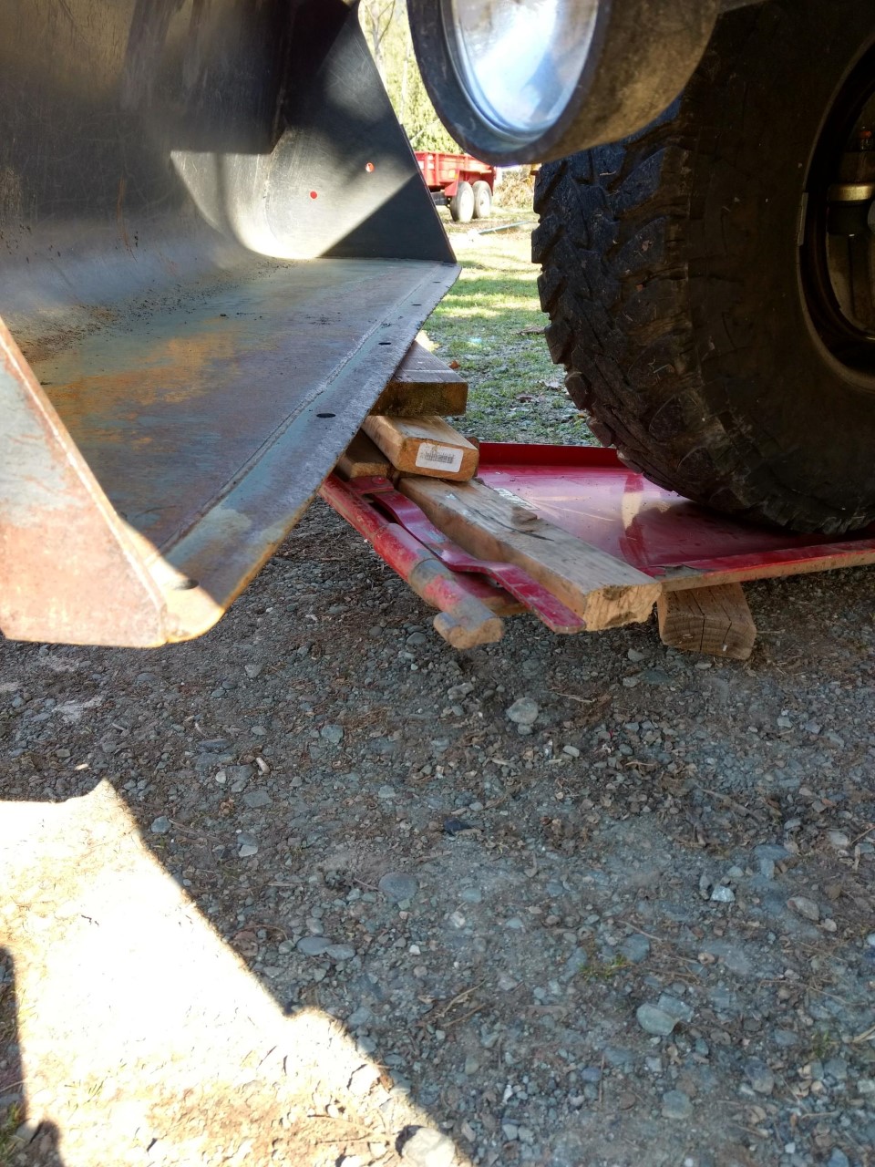

Park a truck/tractor/trailer on the "straight" end, with a block (chunk(s) of 1x, 2x, brick, ...) under one corner on the twisted end. Use either the bucket if you have downpressure, or the tire of another vehicle to "sneak" up on the other corner, pressing down in little bites until it bounces back mostly straight. You might have to get a little creative with more 2x blocking next to the "clamped" end to get the pressure on the frame of the tailgate without bending the heck out of your latch bar trying to drive onto it.

Took me a while before I could complete this work, but I managed to straighten out the tailgate and get it back on. Had it straightened back in March, but it took me a while before I was able to get around to drilling out one of the broken hinge pins: really difficult; had to break down and get a angle drill.
I pinned one edge of the tailgate with my truck, with a 2x4 along the "fault line," and then used the tractor bucket to push it back into shape. I didn't get real fancy on checking square in which case I wasn't sure that it was going to be good enough until I mounted it.
