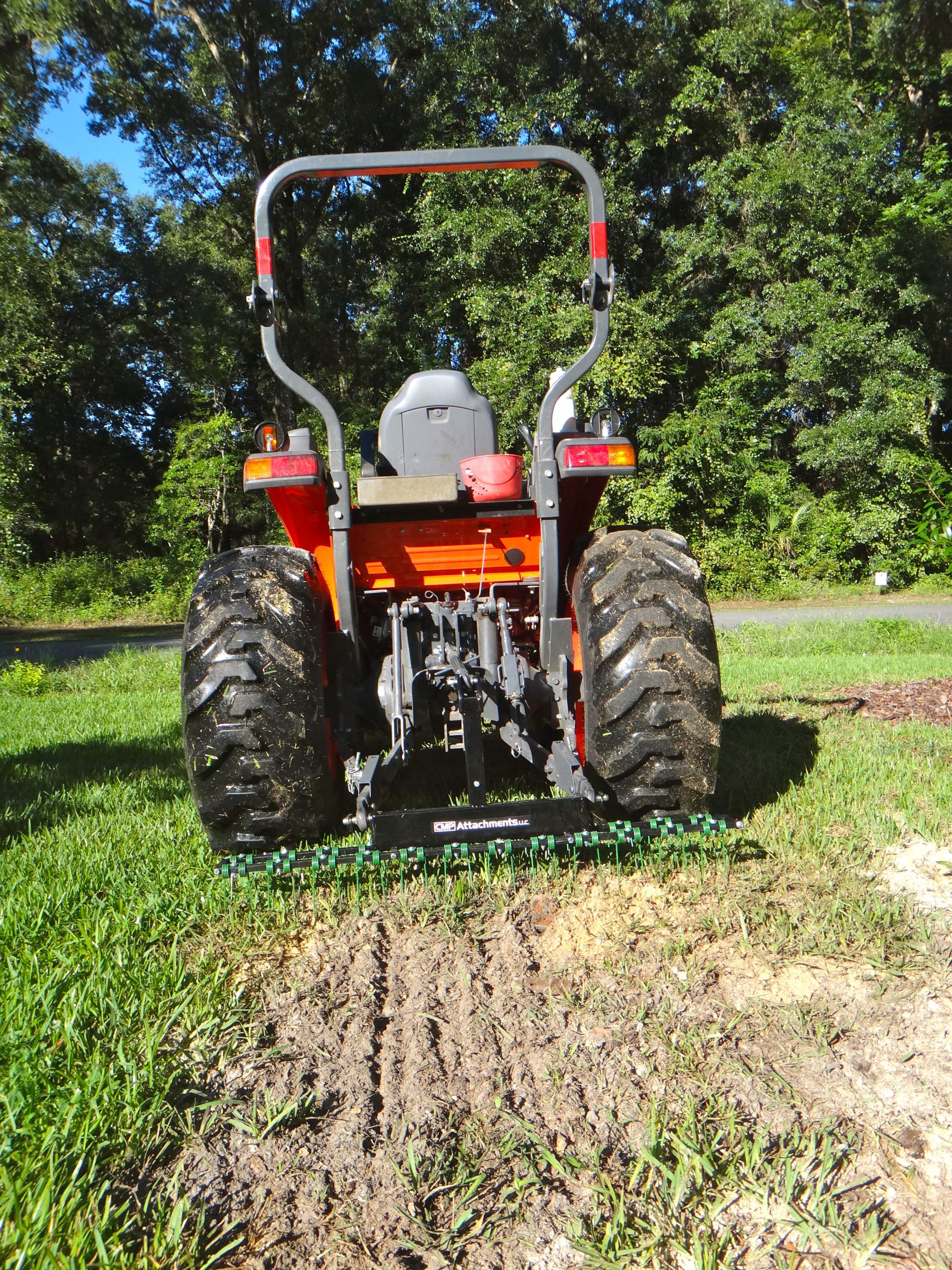

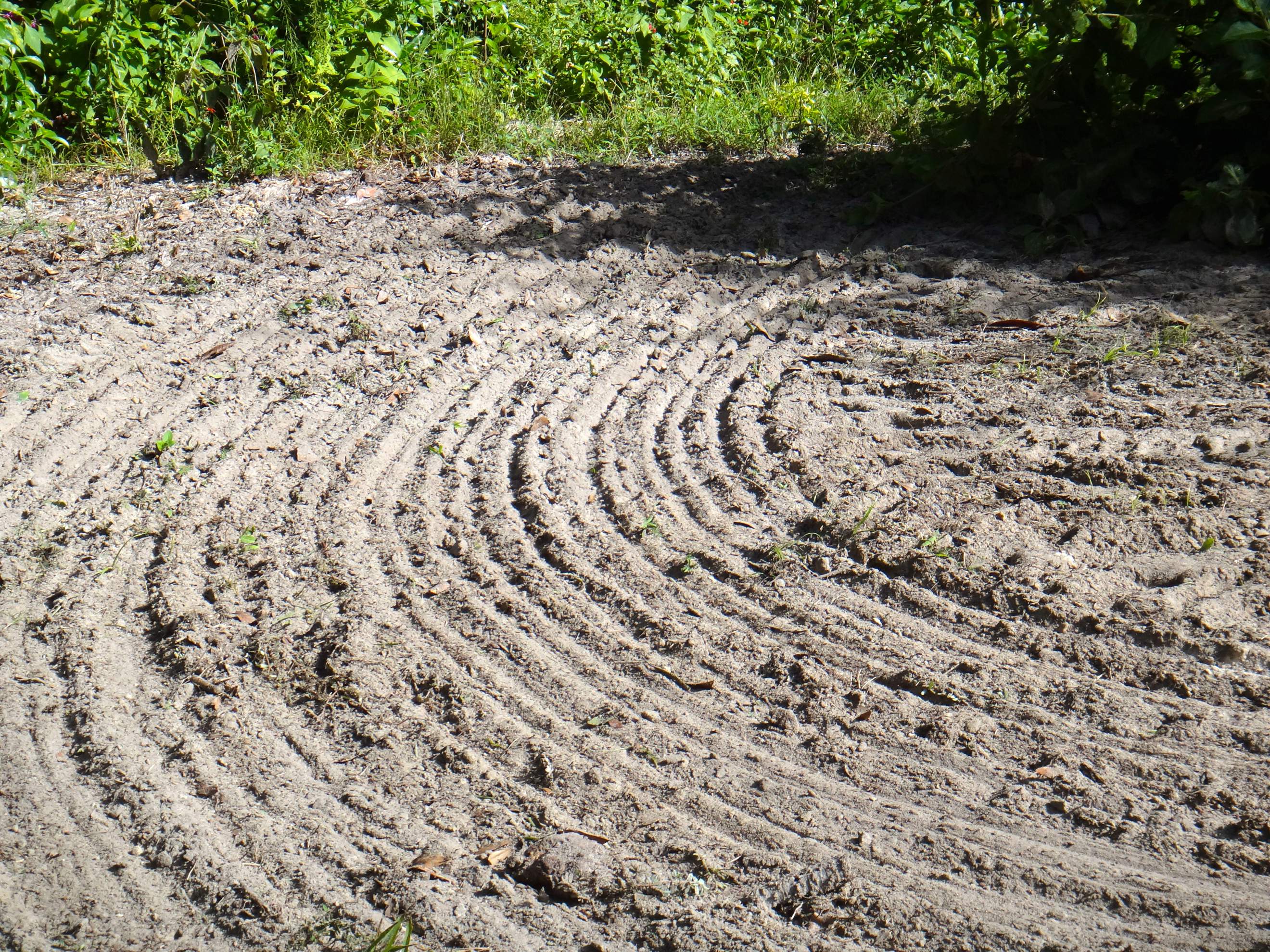

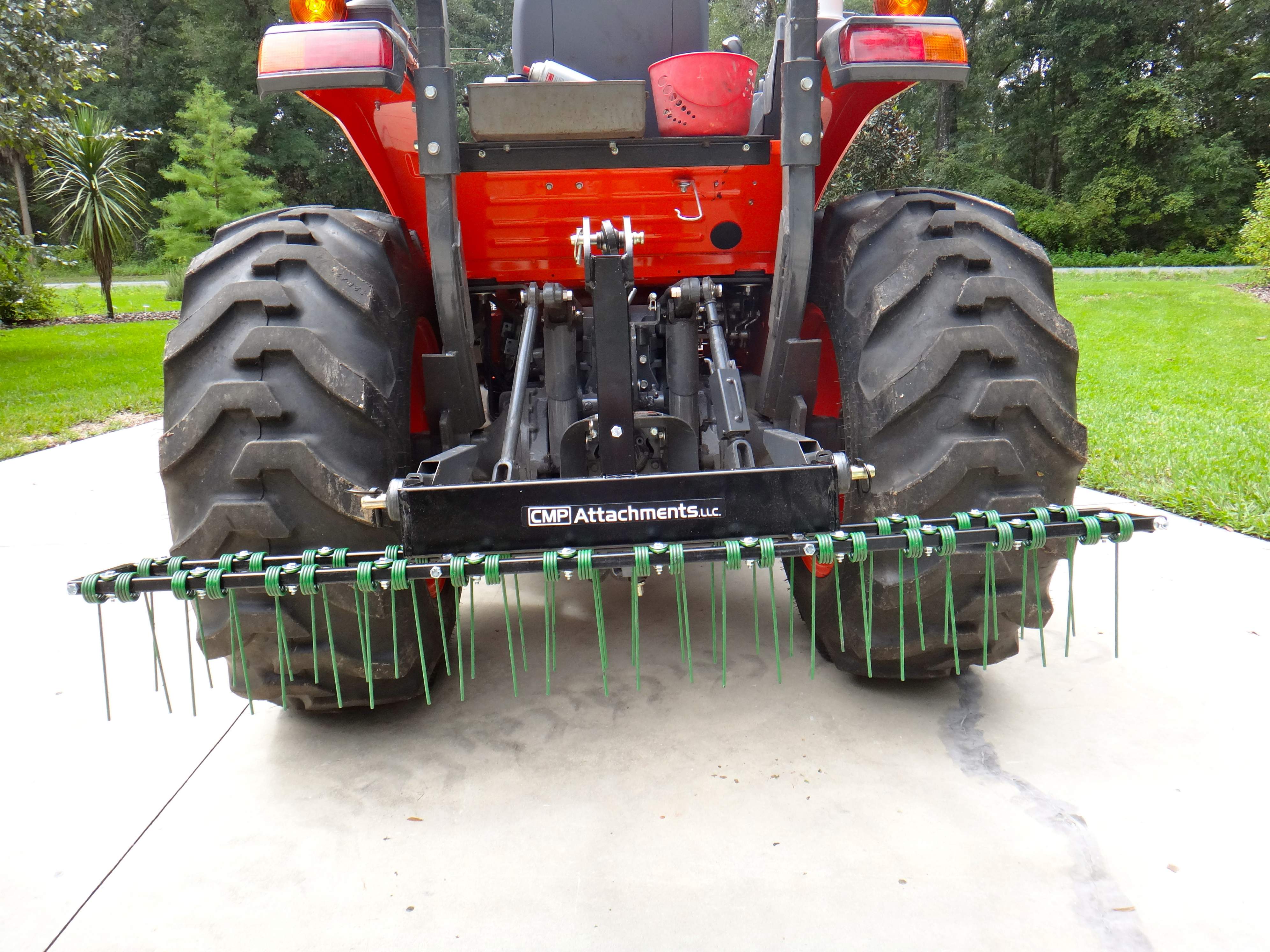

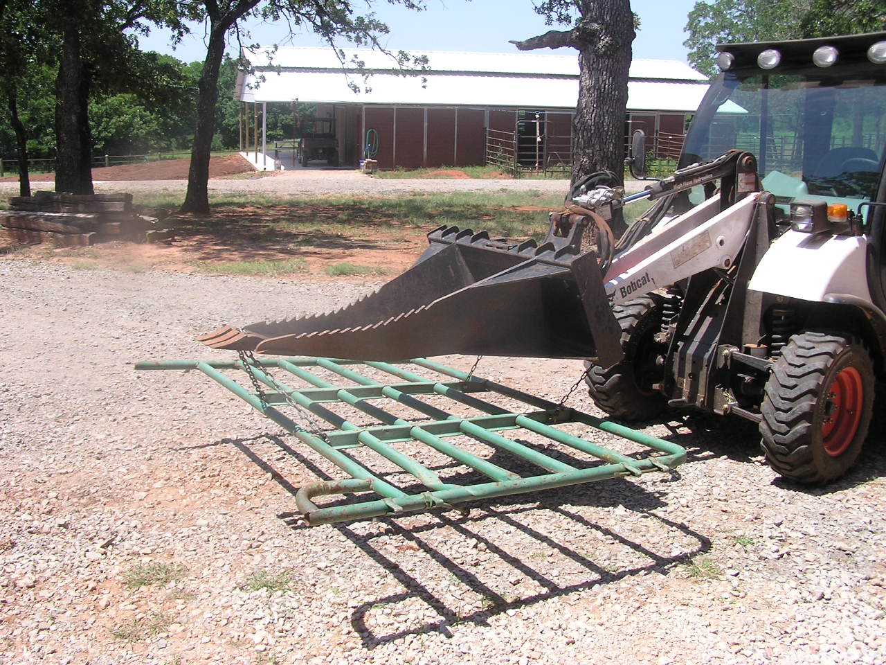

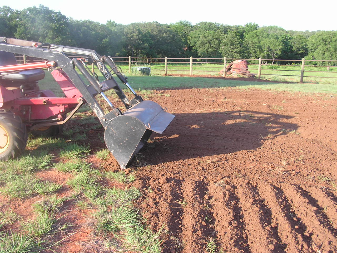

Perhaps a lawn thatch removing implement or similar pine straw rake. Tines on the CMP thatch remover are stiffer/more resistant than tines on a pine straw rake.
CMP LINK: CMP ATTACHMENTS, llc

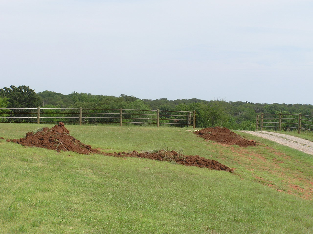

What I did was place piles with the FEL, then use my box blade, set the depth I wanted the compost placed at and went through and spread the piles. To set the depth I used 2x4's placed sideways and lowered the 3pt until the box blade touched and then locked the 3pt. Worked pretty well.
Last operation was a drag harrow as others have suggested. I also seeded at the stage to improve the pasture too. Worked well.

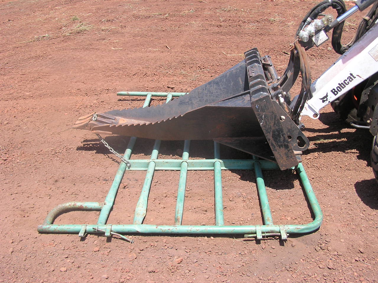

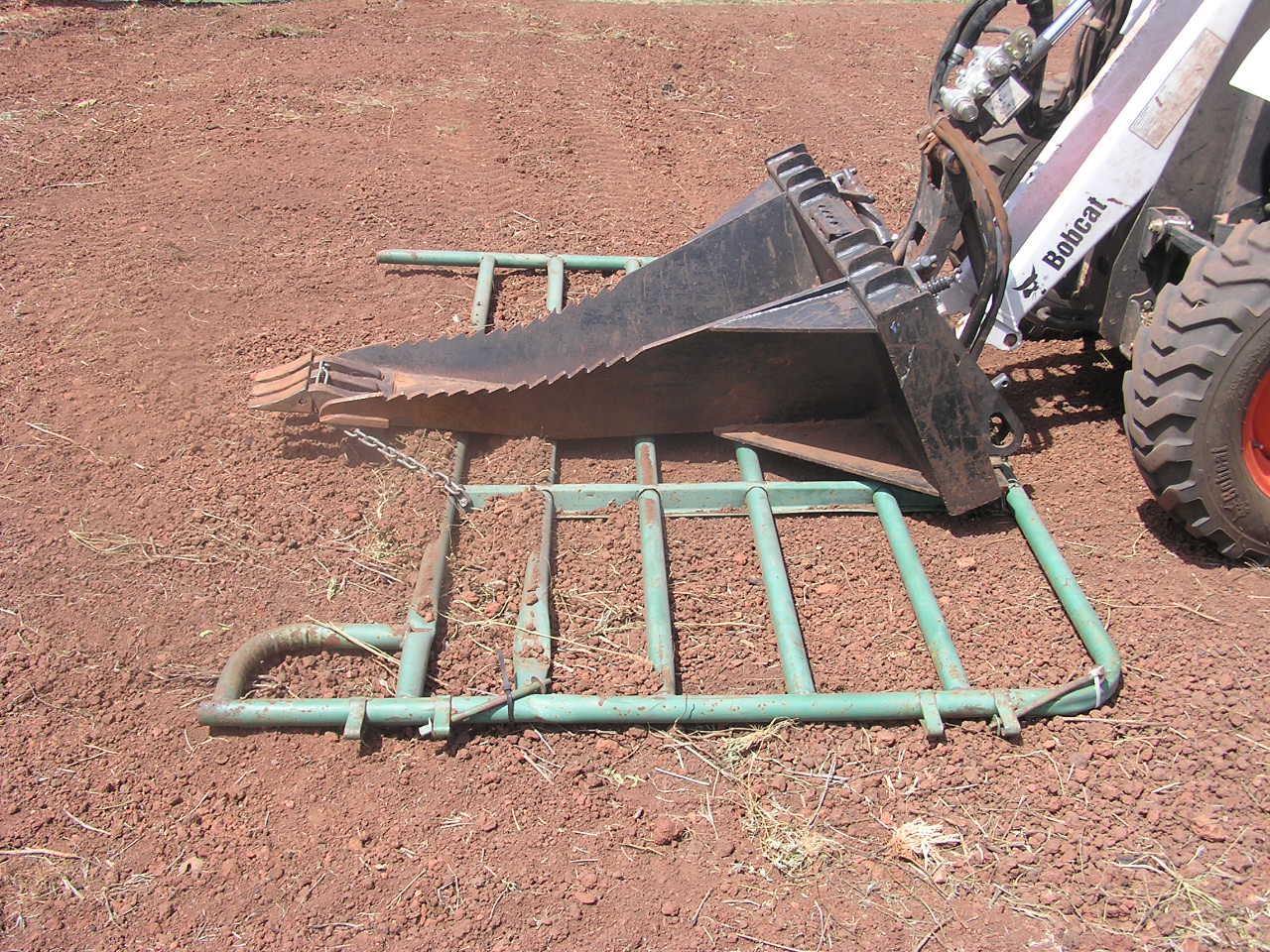

Some landscapers offer this as a service. There are quite a few ways this is done, from the buggies, to the rakes and blades, and also hand spreading. If you have a FEL, I think you could scatter a fairly good spread. Then follow it with a drag. The drag could be made from wood pallets, cyclone fence, etc.
