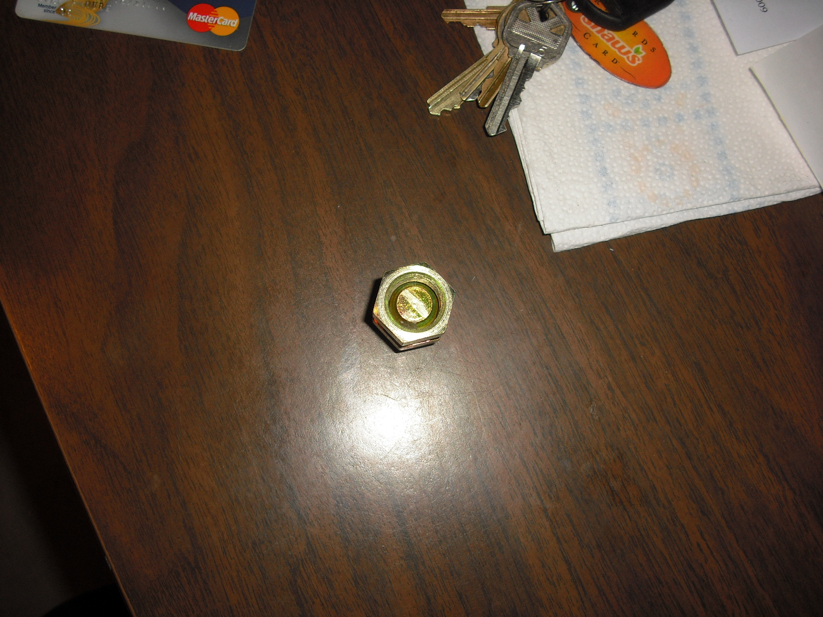

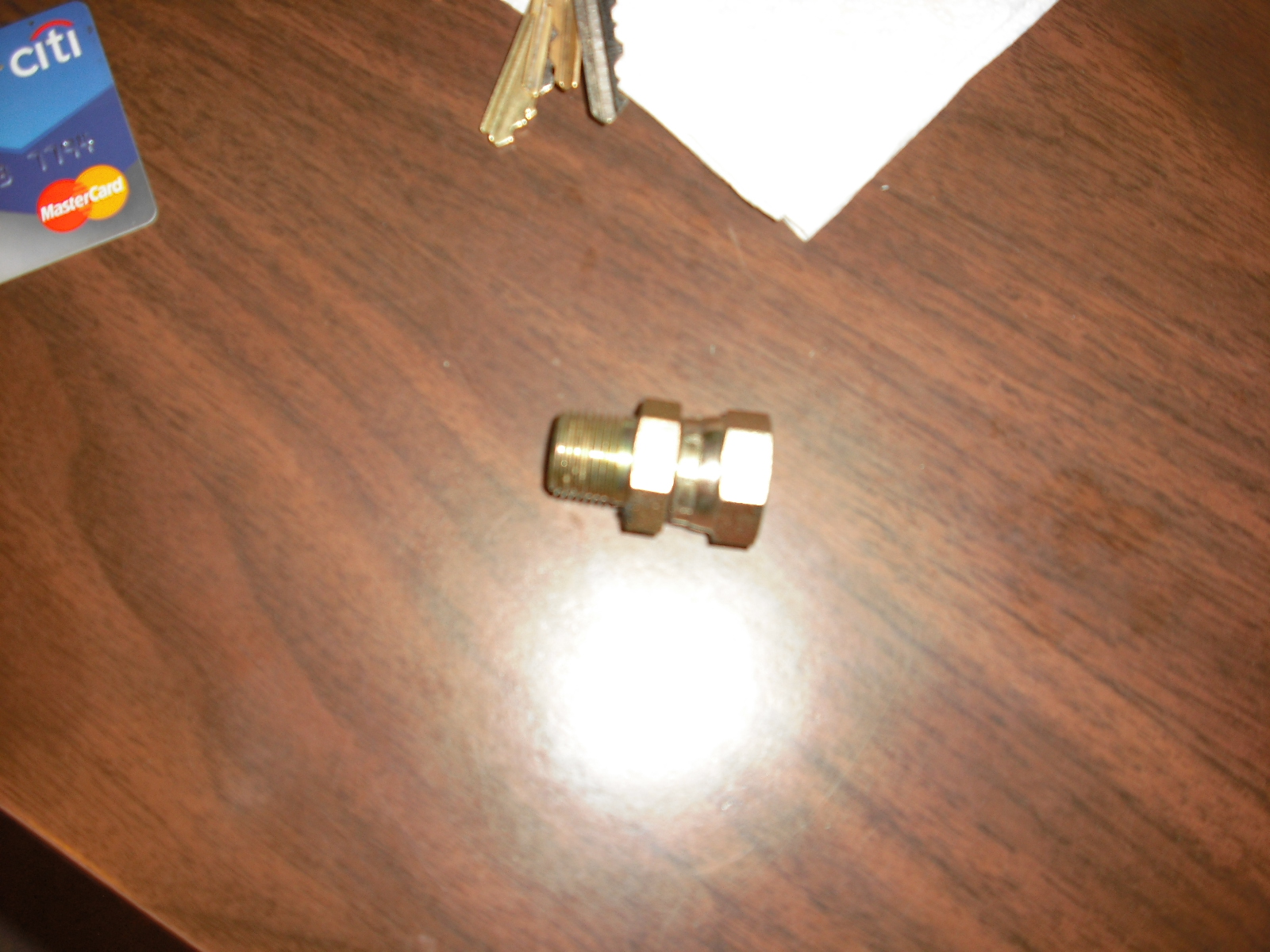

Here is what I used, just drilled small hole and worked great, cheap solution, I lost no power.
Not certain on hole size i'm certain a little searching and you'd find out.

Page 6 of the Tompkins catalog has them. They are scattered throughout the catalog. NPT x JIC part # is RST2404. It looks like the restricted fittings have the RST prefix.
You guys are making this far more complicated than it has to be. A simple bullet proof $5 fitting will solve the problem. Get an orifice of about .062 and you will be fine. That's what they use from the factory to slow down cylinders. Keep it simple.

I agree. I use restrictors all the time. Only need to use one. Don't need to put one in each hose. Just don't use them in a line which has constant flow- creates too much strain on pump and releif valve.
If the restriction is too much, drill out the orifice just a tiny amount and try again. JoelD has the picture in a recent post.
