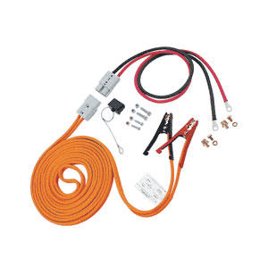

When you connect the booster battery to the starter lead (with the cable attached), are you getting power to the dash? Are the glow plugs coming on with a turn of the key? If not, have you checked the fuses? There's a 100 amp MegaFuse in the system but unfortunately it's under the bed.
I've been considering installing one of these hardwired-quick connect jumpers on the Toolcat since the building I store it in completely blocks the rear and passenger's side of the machine.
I don't understand why it won't jump unless the battery itself has an internal short or a short in the wiring. Unfortunately your not the first to have to deal with this very issue.

I have a Warn jumper set (like you show in your picture) permanently connected to the battery with the connectors run to the rear under the box. I use it to connect to my winch, which hangs off the hitch receiver when I mount it. When my battery was dead, we tried to jump it using this jumper set. But it didn't work.
Did the battery have an internal short?
DEWFPO
It must have; I just don't know enough about electrical systems to properly diagnose these problems.
